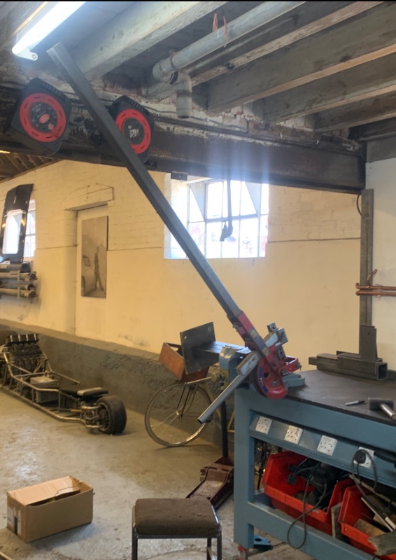

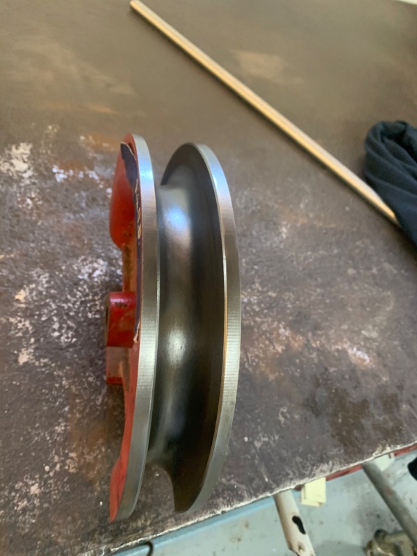

Trying to save money i commandeered Grandads Record 220 pipe bender.
This model had cast iron wheels and followers (no not alu) and it work ok!
My only issues were the amount of forces needed was a 2/3-man job and there was a very slight oval ling of the tube on the bend.
I had the bender in the vice hanging upside down with my feet on the ceiling pushing down to make it happen.
s-l1600 (1).jpg (158.19 KiB) Viewed 2045 times
Re: Fifty shades of Jade

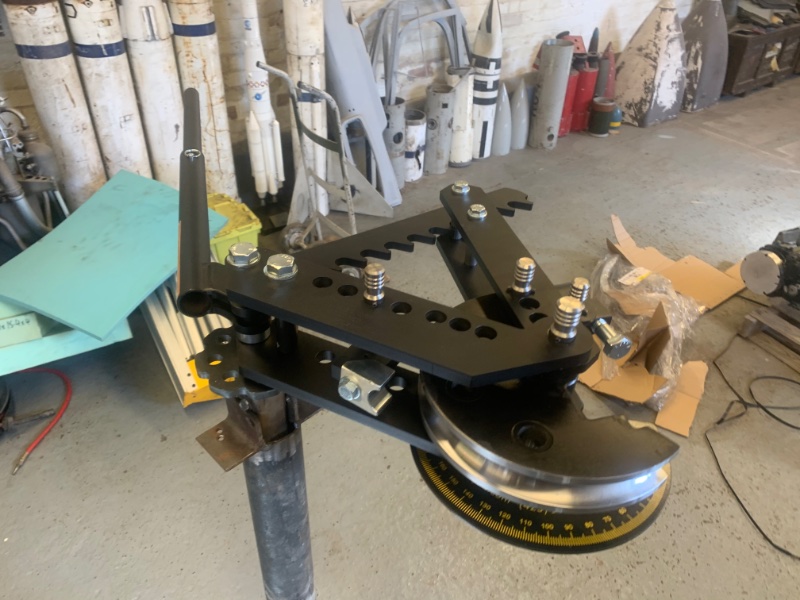

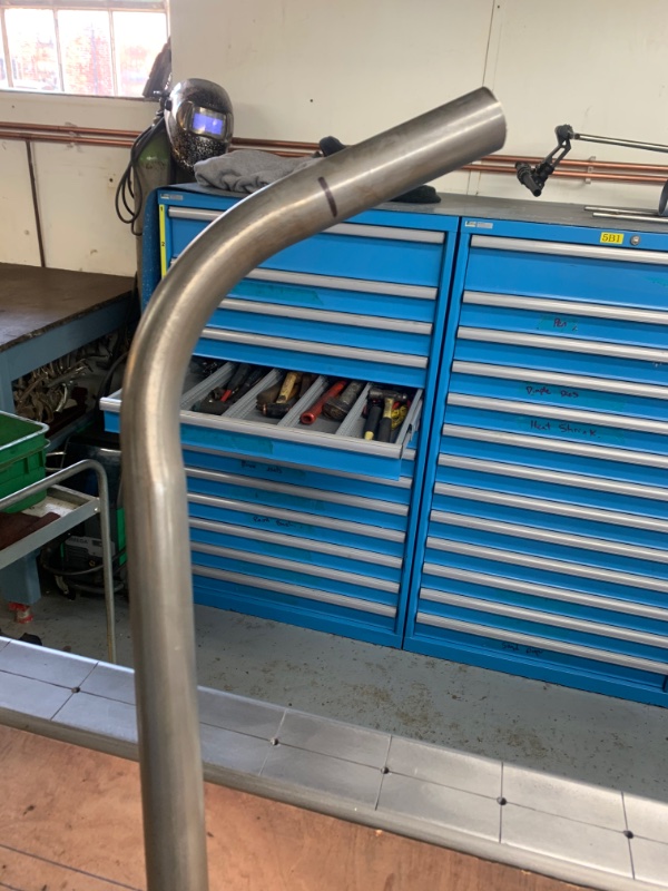

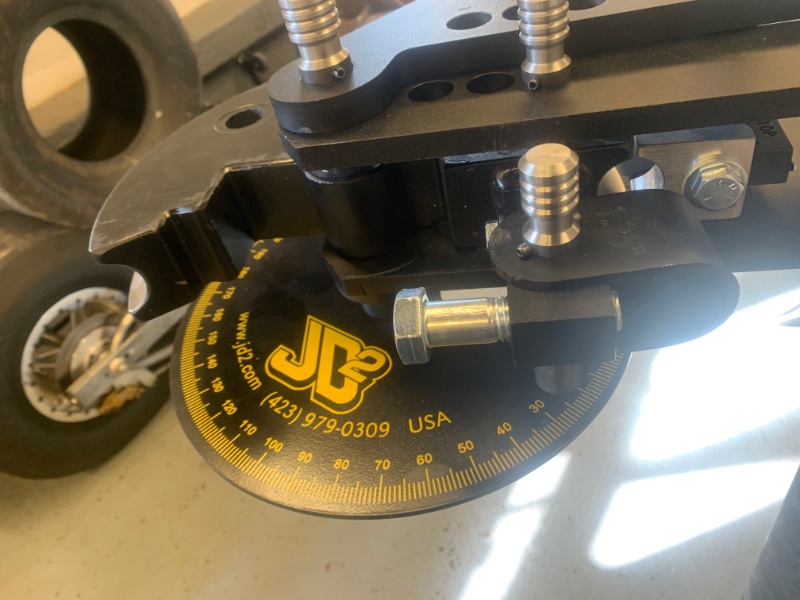

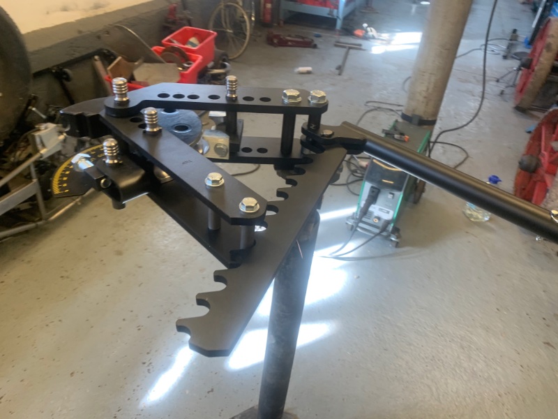

In the end i bite the bullet and brought a JD Square Model 3.
In hindsight the bends are only marginally better and to be honest the Record bender did a very good job.
Now i have the ability to bend tubes easily using the geared up lever system but more importantly i can do them safety on own without the Circus act

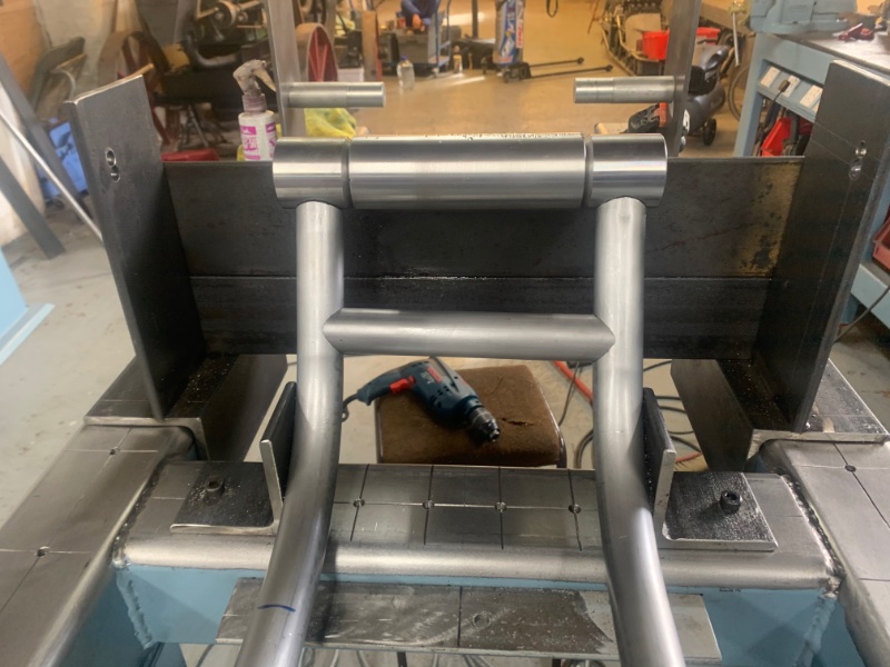

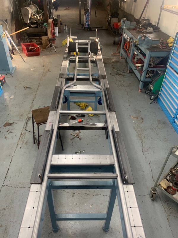

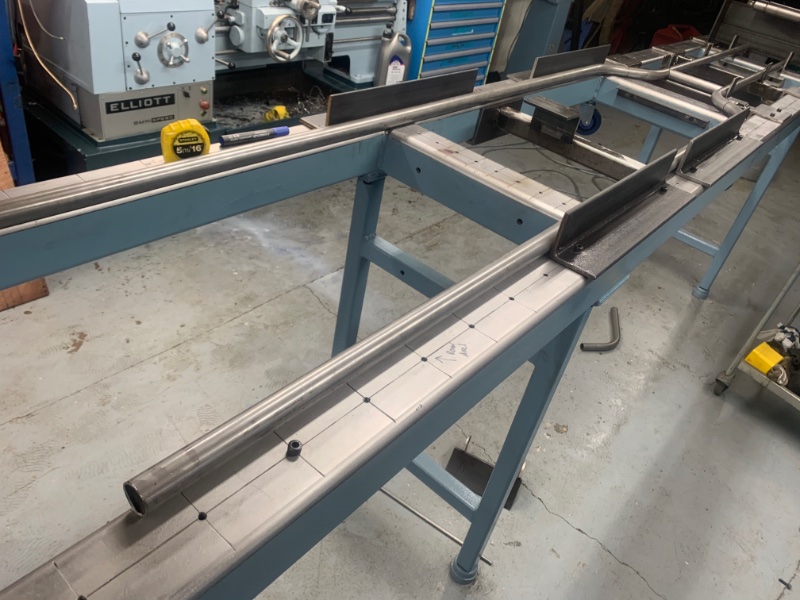

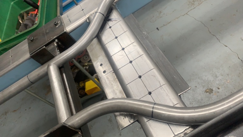

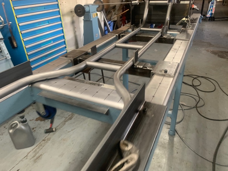

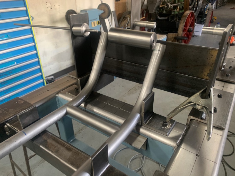

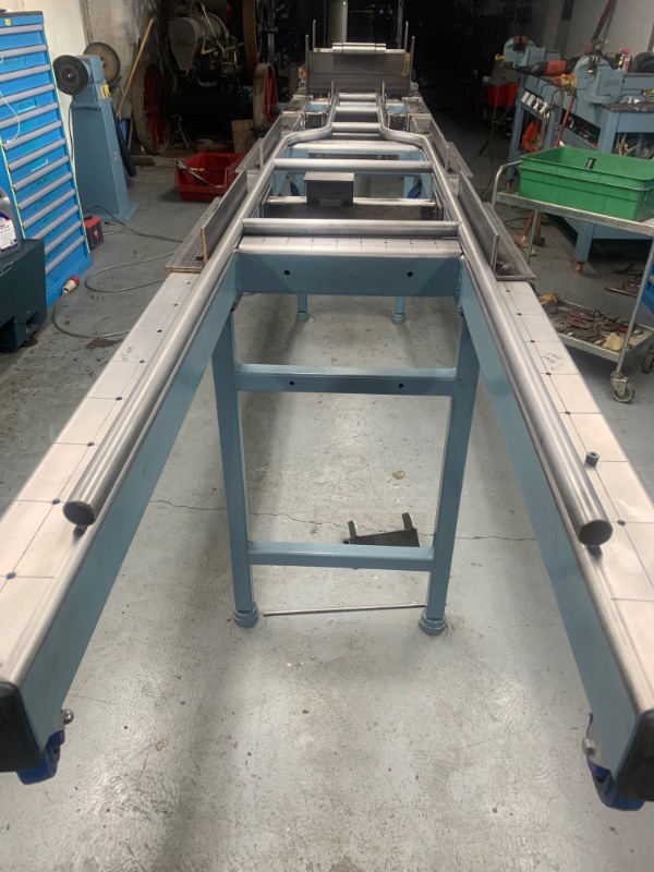

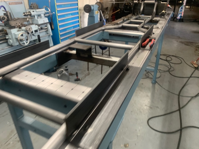

Finally i got the bottom frame rails fitted !! \:D/
Feels like all i have done is spend hours building a table :roll:

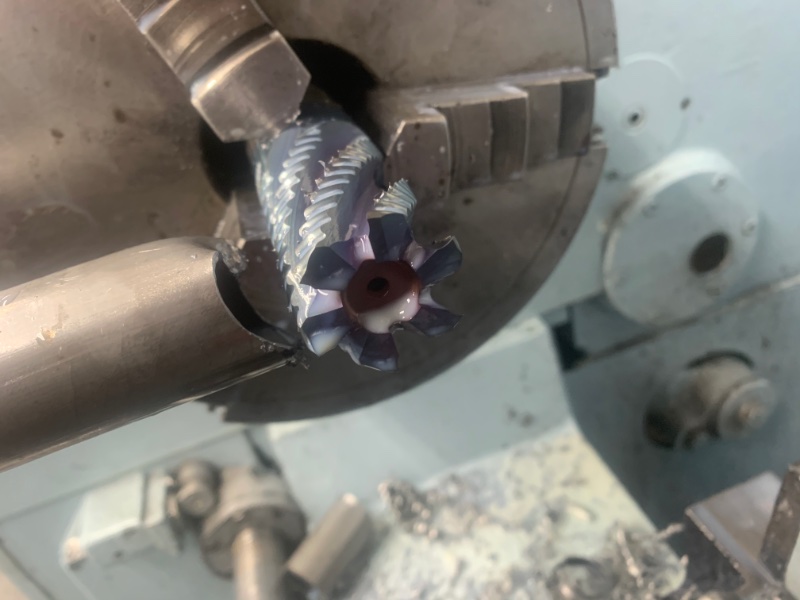

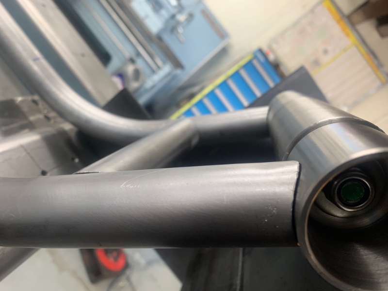

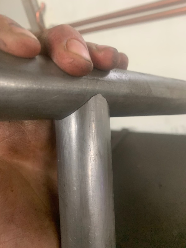

Tube notching
To achieve this i removed the tool post from my lathe and made a special tube holder from an old V-Block.
This will except a range of different size tube.
You then use a roughing end mill the same size as the tube you want to Notch and drive the tube into the mill. (Slowly :? :help: )
Advantages - Coolant for cutting - Degree wheel adjustment of tool post - DRO dial measurement of cuts !
It works soooo well if you have a lot of Tube notching to do buy an old lathe off ebay and convert it :salute:

Good idea using the lathe to do your notching :thumbright:

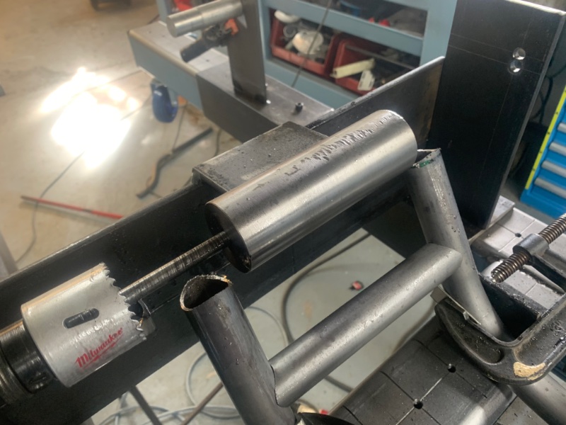

Over the years I have learnt one thing about this building cars and bike malarkey
:brushteeth: THERE ARE NO RULES :brushteeth:
Anything goes...
I used a Hole saw on a bar and cut the tube notches in the bottom chassis rails to the swing arm bushes.

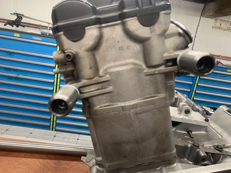

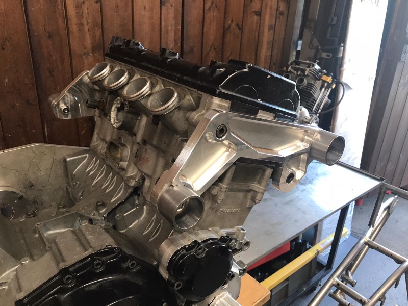

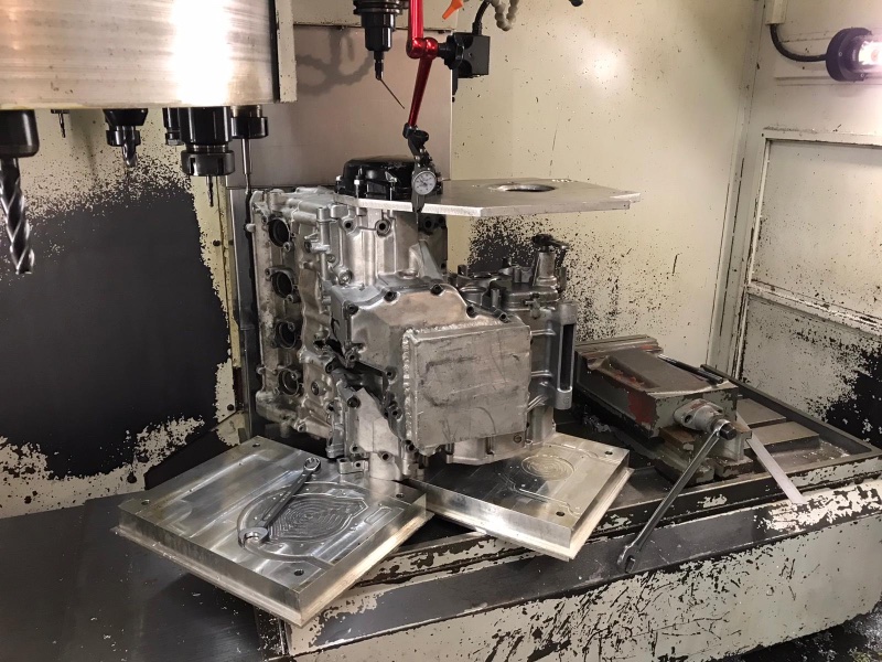

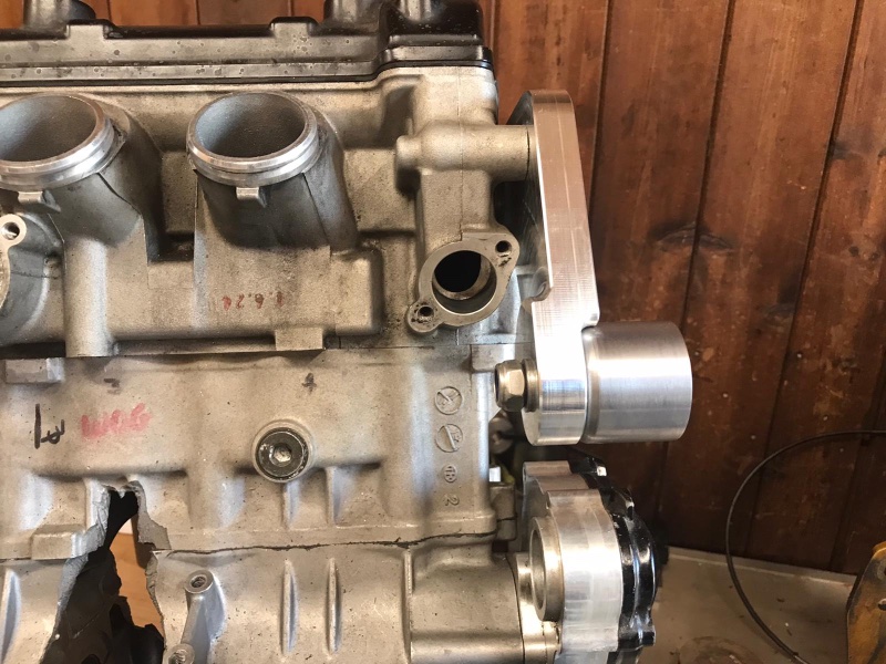

My first idea was to mount tubes around the engine and to remove the engine it would be through the bottom of the chassis the same as the last bike.
For some reason Suzuki decided to make the engine mounting nonsymmetrical which will make my frame look really strange
Engine mount not straight.JPG (49.48 KiB) Viewed 2003 times

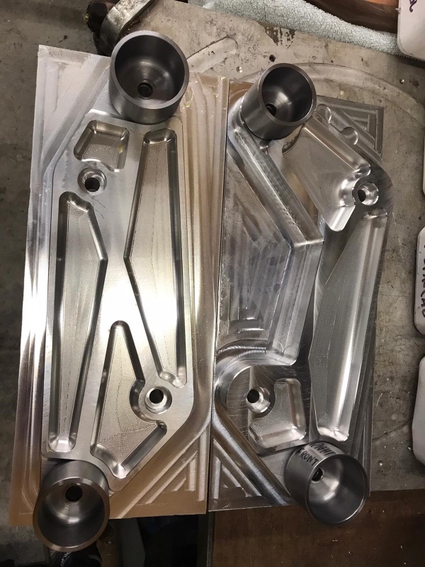

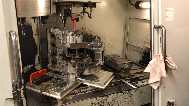

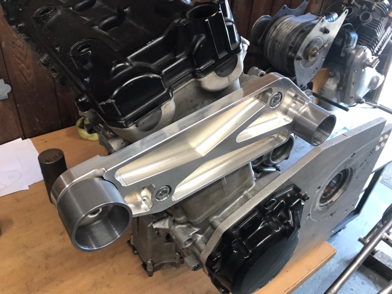

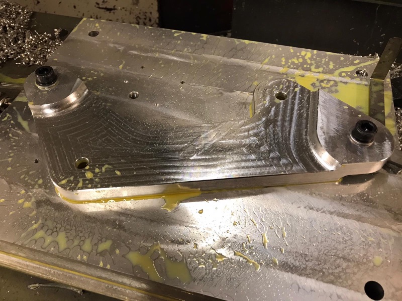

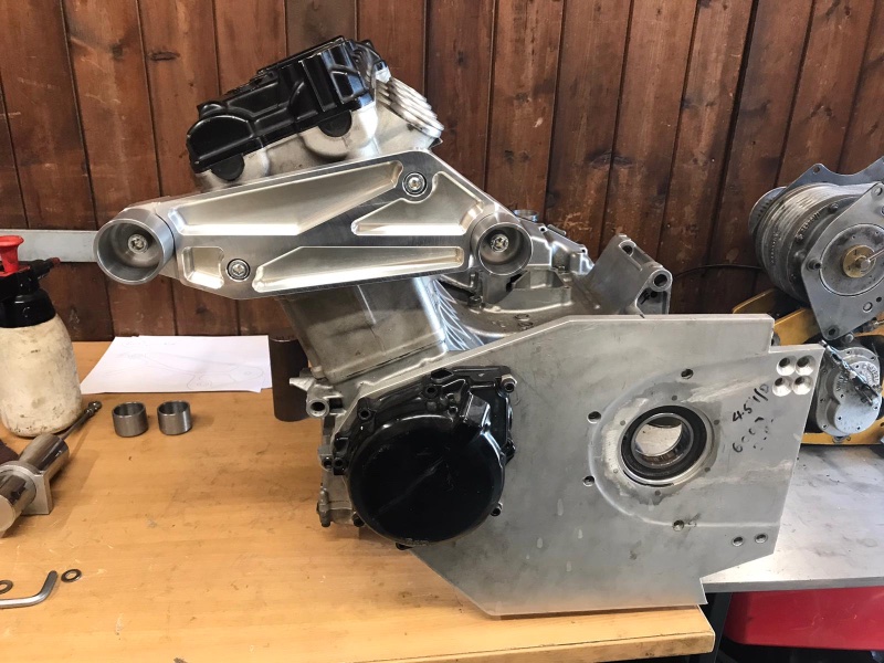

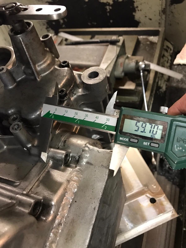

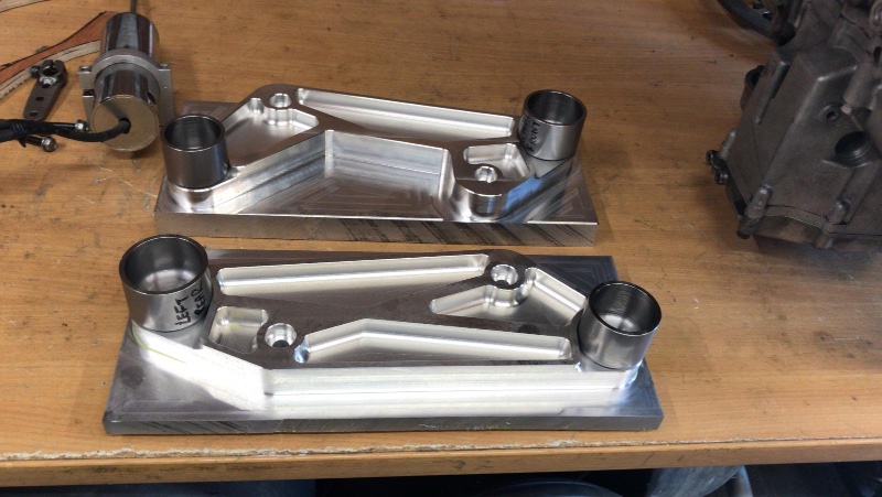

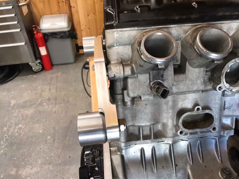

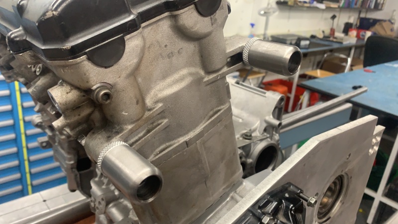

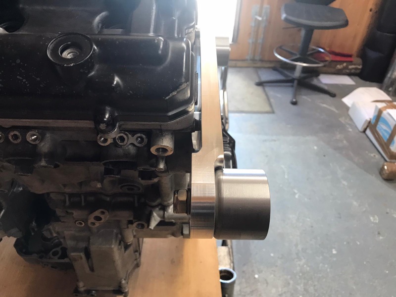

To get around this issue placed the engine on a measuring machine and measured all of the key points of the engine.
This later will also help us with 3-D modelling of the engine
A set of aluminium plates was made which make both chassis mount symmetrical on both sides of the engine. this also meant that the aluminium plates could be removed and the engine removed from the side of the motorbike.
This will allow us to put a lot more structural rigidity in the base of the motorbike frame meaning it can be made lighter and stronger
