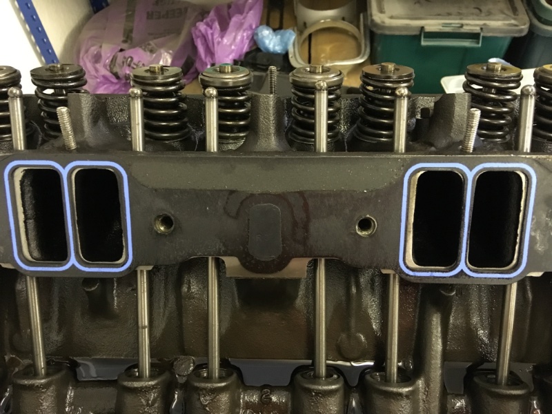

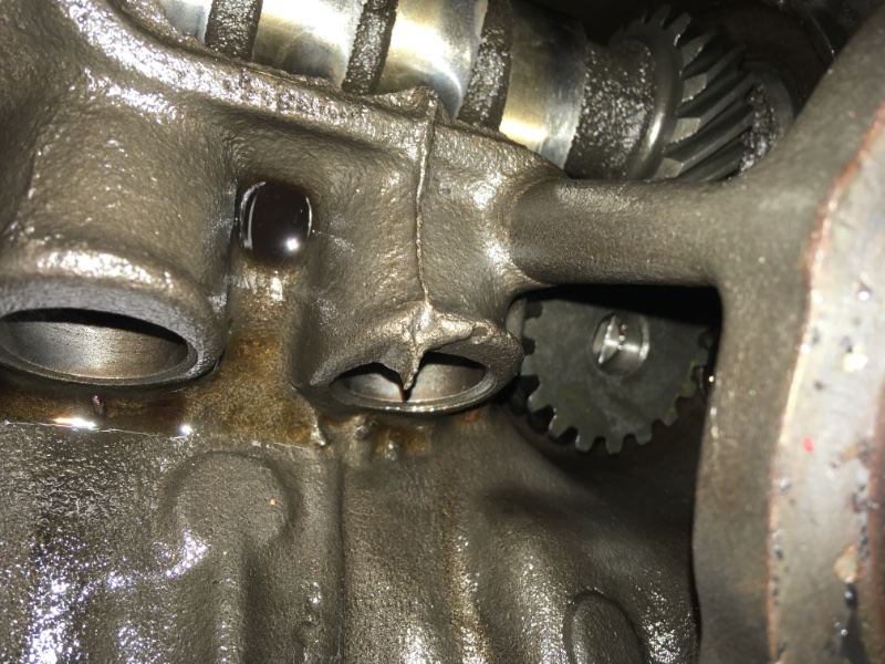

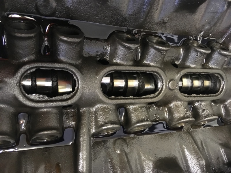

Got it all apart, it has been rebuilt. Ends and mains are just showing copper with no scoring or damage to the crank. Bores have no lip and a bit of crosshatch is still visible. Need to have a closer look at stuff but on the face of it no horrors. Block has some bad casting flash and the port match on the heads isn't great, bit of time with the die grinder will rectify all that. Plenty to get on with then...

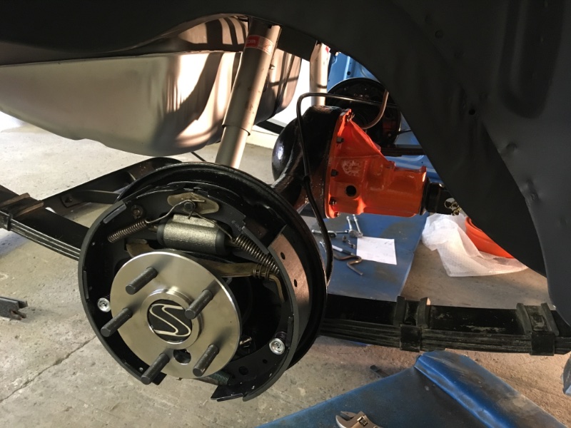

Productive morning, rear end assembled and installed again for the last time. What we have here is an E body case narrowed to suit my choice of wheels and tyres, strange shafts to get 4.5" PCD and 11" B Body brakes. Would have preferred 10" drums as it might be a bit overbraked for the back, but thats what I had so we'll see. Diff is a 3.55 sure grip.

that's a nice looking rear end you have there (ooer missus :oops:). re the big brakes you can always add an adjustable proportioning valve in line to the rear if it was an issue. we do wilwood lever and knob styles at work.

Noice.... is it a 489 or have you put a Dana in the Baracuda as well as the Valiant? Did you order it built or assemble it here. Only ask cause of the colour... which I like :rr:

Actually I can see it’s not a Dana from the photo... :clown:

Had to cobble it all together from parts I've been collecting over the last year or so. I painted the housing with the same orange paint I bought for the callipers and brake drums. Thought about painting the whole axle in it but I'm just trying to invoke the spirit of the early '70s rather than fully inhabiting them....
