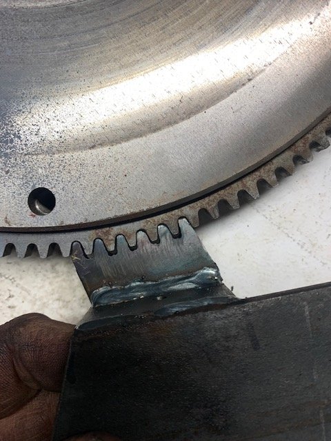

I made a flywheel holding tool:
And pulled the old damper off

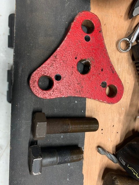

2) You need a really long retaining bolt. Longer than the Mopar aftermarket 'Long' bolt.
Fortunately, would you believe it, the bolt from my puller was an exact fit, and proper quality .

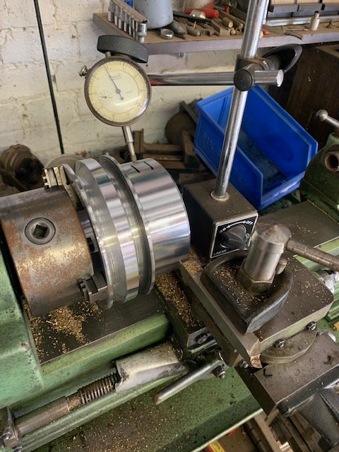

Measured the pulley for cutting
Made a light turn to remove the clear powdercoat inside and out,

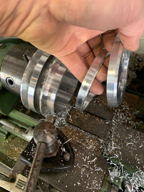

Cut 13mm out of it.
Veed out the join and clamped the two halves up

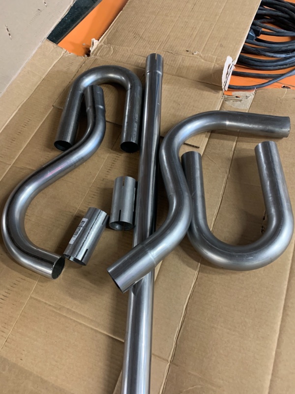

So in the quest to get the car a low as possible, the exhaust is currently hanging down too far, and needs modifying.
The main culprit is the headers - even accounting for the gearbox mounting issues, they hang too low for me.
Bought some assorted bends from Jetex
