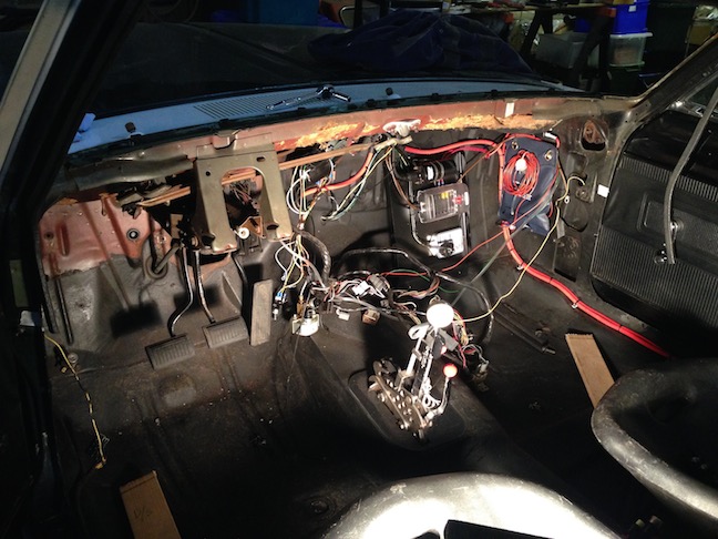

Screen & dash stripped out ready for the front half of the cage and 'glass dash install. I'll strip out the loom and all the other odds and sods tomorrow. Then I guess I'll be firing up the hole saw again, I see weight...

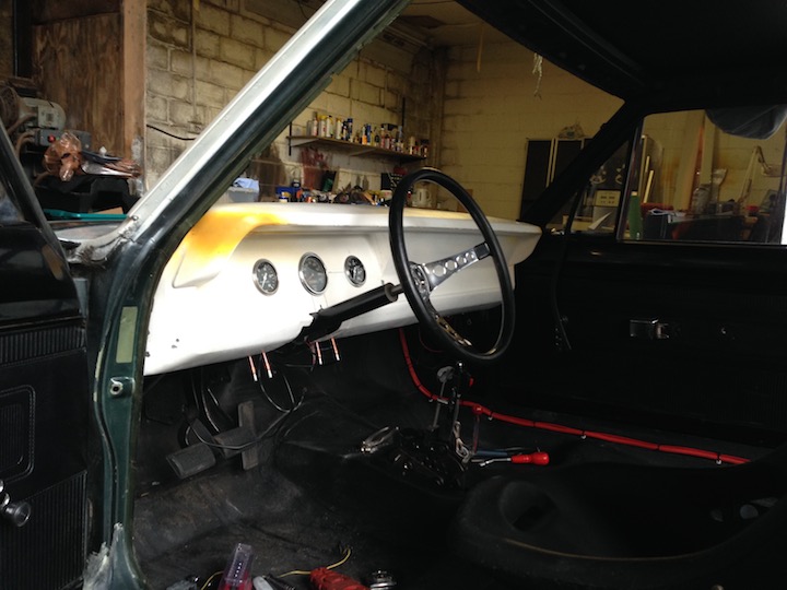

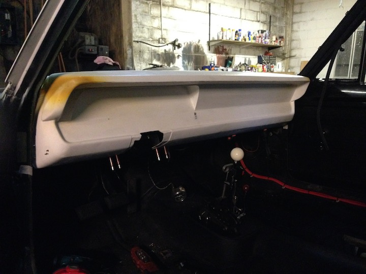

Mocked up the fibreglass dash this afternoon and made the mounts.

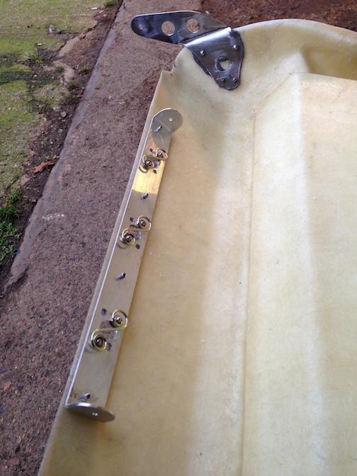

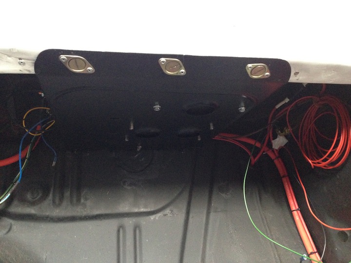

Back of dash, end mounts bonded on and riveted, Dzus bracket added to mount the electrics panel to, I'll mount a couple of small braces from that to the back of the plenum to stop flexing. Gauge mock up Tomorrow, looking forward to that!

I've always liked Dzus but they're a bit of a mystery to me. There seem to be loads of different types, mounts, etc?
Posts: 14502
Dzus fasteners are pretty straight forward. The self ejecting type come in 2 diameters, the larger you would use for fitting big panels such as a bonnet, the smaller for the kind of thing I'm doing here.
Both sizes come in various lengths, you measure the thickness of the 2 pieces you want to fasten together and choose the nearest length, you can tweak the springs a little either way so it's not super critical.
Each length has it's own matching spring.

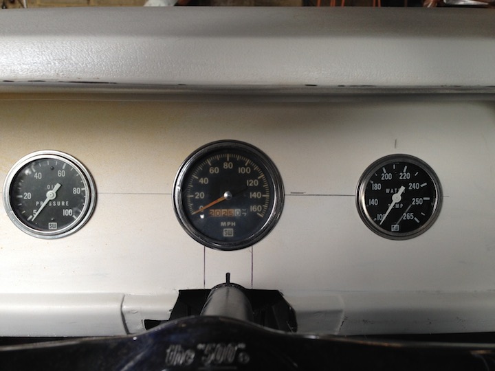

Posts: 14502
