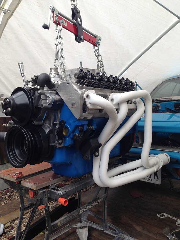

This is the Engine about to go in before I found the oil leak.

Ah you went for one of them Carl. I think it'll work fine, mines got 400-500 miles on it now and it's settled in nice, little bit grabby on take off but grips like a good un :thumbright:

Yes seems a bit stiff at the moment but needs bedding in at least 500 miles they say.

latil
Posts: 12076
Post by latil »
Looking good,don't drop a nut down that big hole on top.

Lookin good Carl, I take it you dropped it in without the headers affixed then as per a previous pic. My headers are an absolute c@nt to remove / fit, wish I could drop the motor back in with them on :thumbright:
Carl
Posts: 4826
Location: Rochford. Essex
Post by Carl »
Yes second time I put the engine in I didn't have the headers on I bolted it to the bell housing then fitted them before lowering onto mounts. 1st time I put the engine in I had the headers on but had to lower the engine in at such an angle so they would clear the bulk head, and that's when I noticed the oil leak out the back of the sump.

MilesnMiles
Posts: 7309
Location: Cornwall
Post by MilesnMiles »
Looks great Carl, hope all goes well!
What headers are those and do the fit well?
Carl
Posts: 4826
Post by Carl »
MilesnMiles wrote:Looks great Carl, hope all goes well!
Hedman headers, nothing spectacular but can get to all the bolts easy, easier than the Hookers it had on before anyway.

MilesnMiles
Posts: 7309
Location: Cornwall
Thanks Carl! confirms what the yanks are saying about them. Cheap but effective.
Epic work :thumbright:
Les Szabo
Post by Les Szabo »
Nice size headers, 1-3/4" by the look?.......I used Hedman 1-3/4" fit together Chassis in-out headers on the '71 340 car, perfect fit and quality was good.
