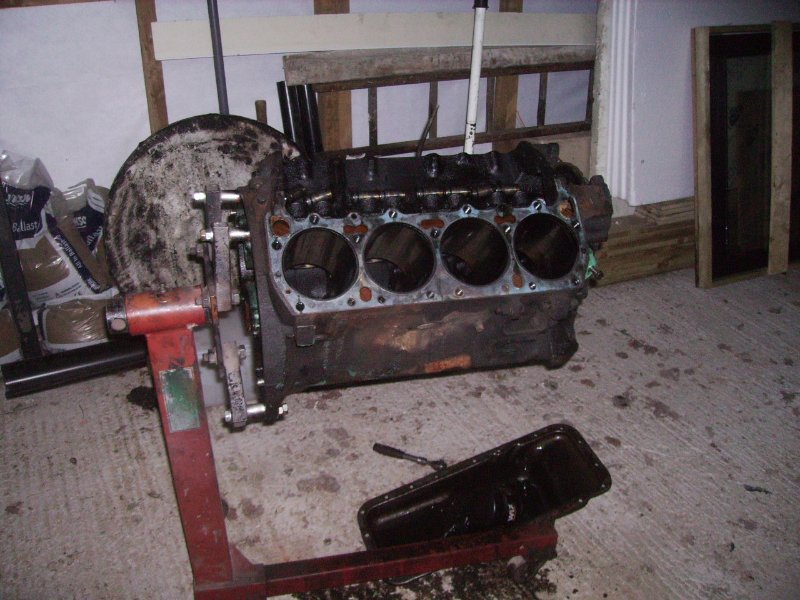

today i mostly stripped the 383 engine. i just have the damper, timing cover and set before the crankshaft comes out to go for a grind. that is if it's not too far gone on no's 1 and 2 big end journals. they are worn pretty bad with a noticeable ridge in the centre between them. the bores are all good though with no lip to be felt on all 8 which is a plus. the oil pickup pipe was loose which would contribute to the bearing wear as air could be sucked up into the oil pump, not good. the cam and lifters are toast so will need replacing too. my mate was told the heads were 'gone through' recently, but i'll strip them while the crank's away just to be sure having seen what the rest is like.
Posts: 1665
Re: what are you doing while at home?
i finished stripping the 383 today and dropped the crank' off to my machinist for a regrind. 2-3 weeks before he can get to it but that's fine as i've plenty of other stuff to do before then. here's a random pic.

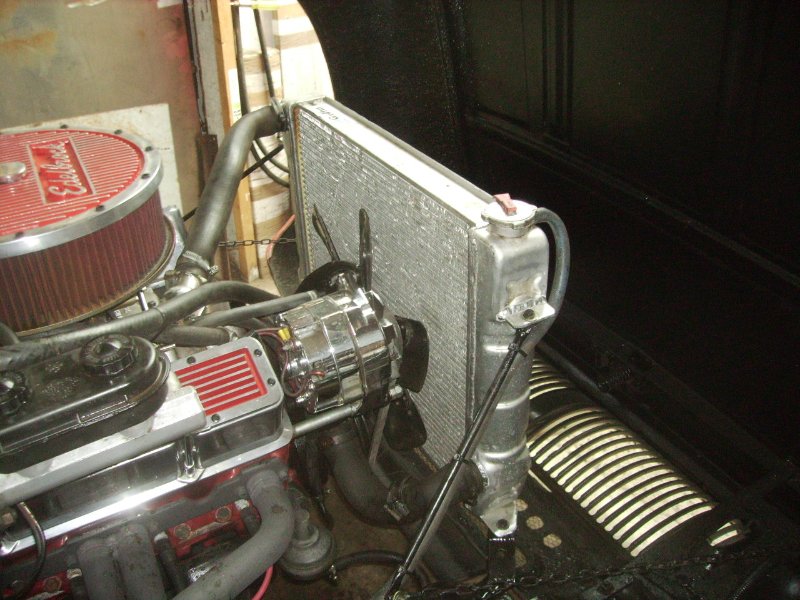

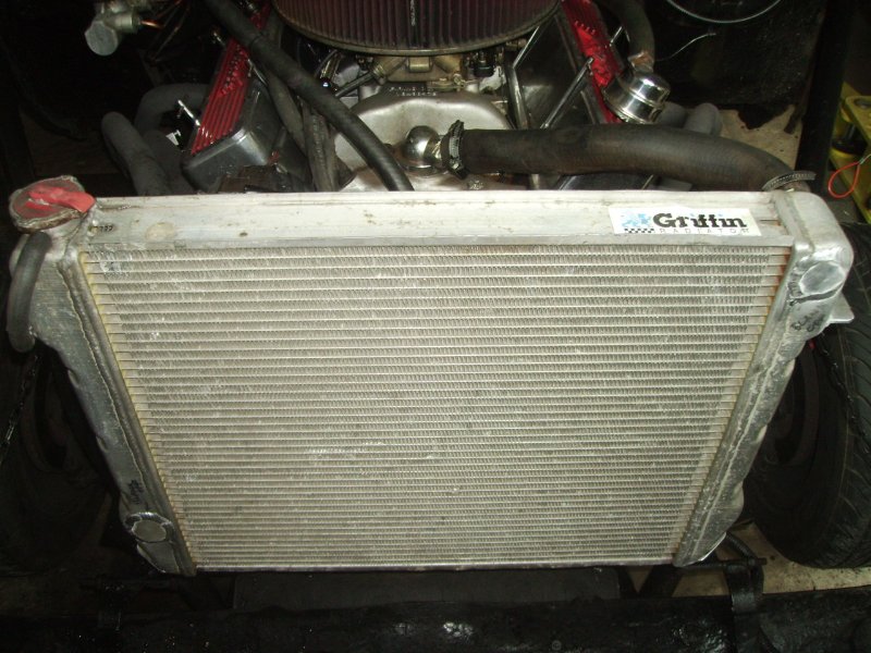

got ashley's zephyr in to fit the secondhand griffin rad' his boss gave him and a b&m shifter i gave him (he's a lucky boy, lol). the rad' must've been from a ford as the hose outlets were the wrong way for his chevy small block, so i got my mate to swap them over, blank the holes and add top and bottom brackets. all done and filled so it ought to keep the coolant inside now unlike the leaky caprice rad' it had before. shifter next.
