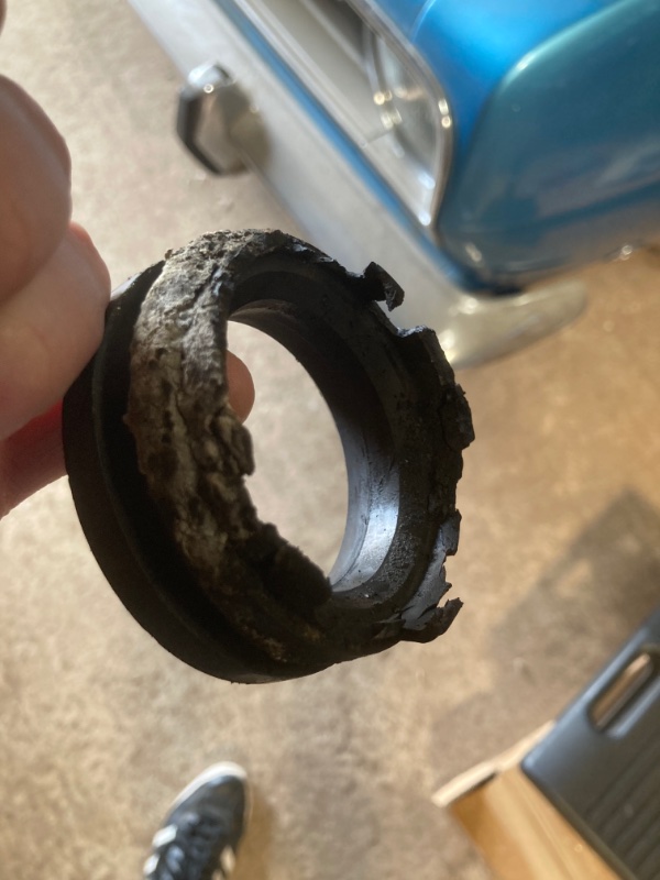

A good friend came over with a spare pair of hands and can-do attitude and we got the new tank seal and boot floor seal done finally. The old seal was in a right old state…

And as for the mystery boot to floor “seal” that was dangling from the pipe up to now???
It’s no wonder no one recognised it. It’s BMW.
Lord knows what was going on there…

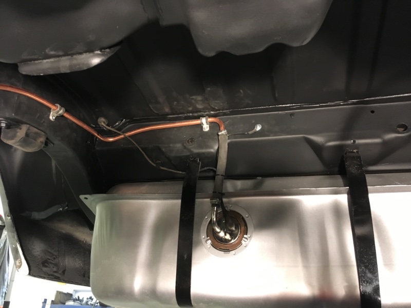

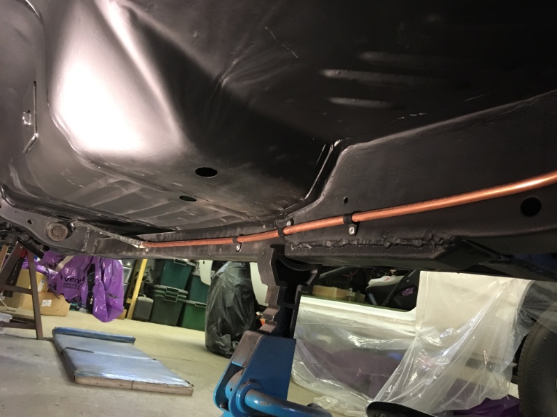

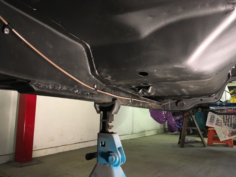

Fuel line, straight along the chassis tie to the front, bit of rubber tube around for protection where it passes through the chassis and the front section sleeved in heat sleeving where it passes the headers. Brake line runs down the other side in much the same manner.

I can’t believe how clean the underside of your car is!
That does look very much like a simpler set up.
Ha, a couple of weeks of dry scraping the factory undercoating off gives you this, that's California cars for you, yours will be the same. As you can imagine its the filthiest job ever...

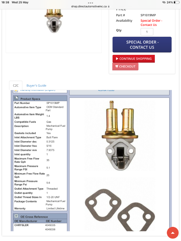

This is the pump I found, still in the box and wrapping.
To fit or not to fit, that is the question!
Just realised I didn’t check the sizes of the hose fittings, though.

Need to see the actual pump to advise but I suspect it will be a stock replacement with 5/16” connections.

Yes, pretty sure it is, but will measure up when I can get to it. Found the part number online, but doesn’t seem to say.
Suspect I just need to pick up the correct pump I need.

You could just fit that and bin off the electric for now.

Yes, that’s fair comment. Could use the existing fuel line if there’s enough. Pump is only £30 worth, so no great loss to swap it out later in the season I guess.
