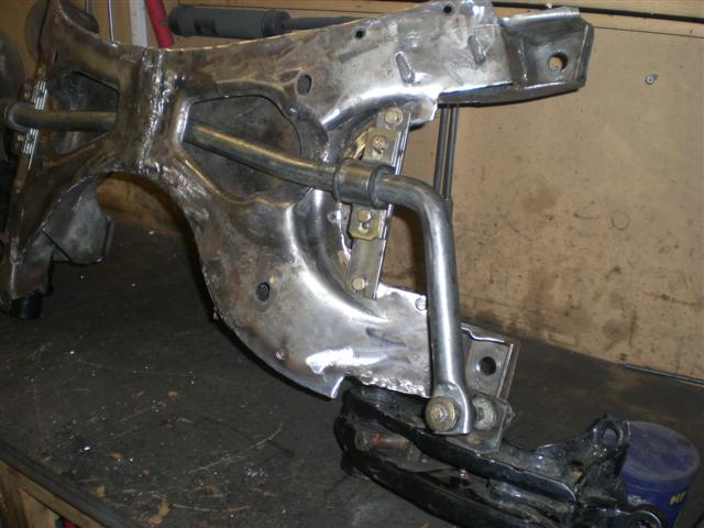

ANTON wrote:As in a previous post i was looking for a 1970 b-body k-frame as i wanted to fit the 1970 anti roll bar to my charger and as i didn't want to pay what they cost i decided to modify my 68 k-frame with John's help. I popped round John's work last week and with the use of his oxy acetylene he heated up the area and I then put two big dents in the k-frame in the correct location to allow the anti roll bar to fit thought the k-frame. I only took 30mins to do and turned out well.
I will also get the k-frame re-powder coated at the same.

Yep the old hot spanner can work wonders

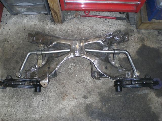

I spent a couple of hours in the garage today and with the modification I have already made to the k-frame to accept the 1970 anti roll bar I have also now fully welded the seams all round the k-frame and full welded the steering box mount to strengthen the whole k-frame. This along with the other modifications I am making should improve the handling of my car.

I spent the day in the garage and finished the anti roll bar set up on the k-frame and I also painted the brake master cylinder, wiper motor and coil.
I also cleaned up some more bits ready for powder coating.
Here are some pictures of how the anti roll bar set up came out.

:shock: Bloody smart that is!
