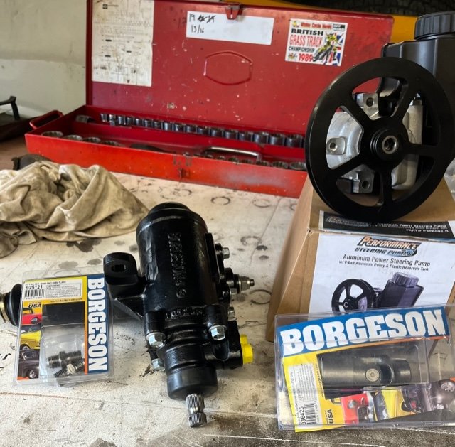

So some more details on the power steering conversion:
The steering on the car has always been heavy and slow. Wide tyres and 6 degrees of caster not helping much . Finally gave in and decided on a power conversion.
Chose a Borgeson box, Borgeson UJ, and GM Type 2 pump (since it's modern, small, and lightweight) .
This particular type 2 pump is sold for circle track racing and comes with vee pulley, unrestricted output pressure ( so about 1400 psi ) , and -AN connections.

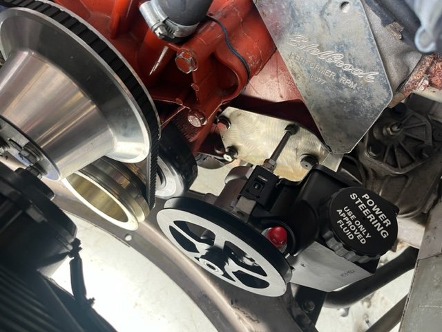

First job - mount the pump.

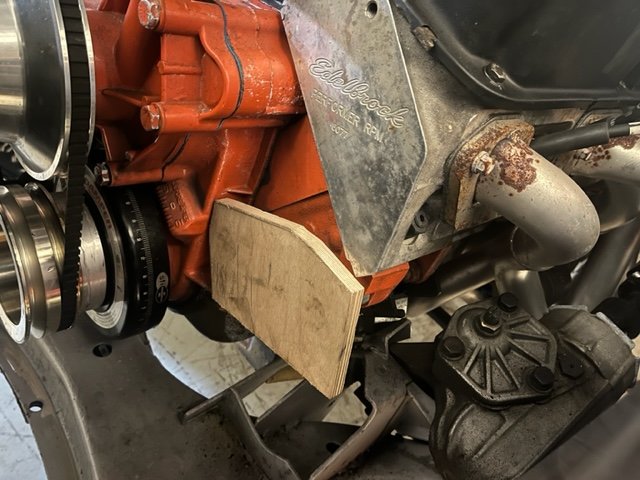

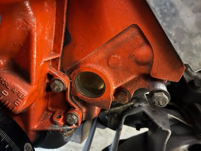

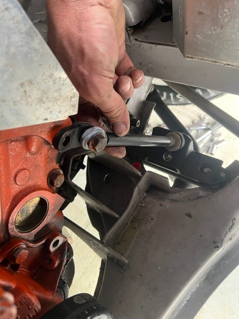

Have a look at the most likely location - turns out the engine mount tie rod is in the way. It's redundant now anyway since I've changed to PolyLoc mounts, so it can come out.

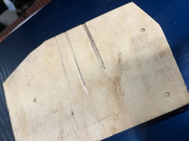

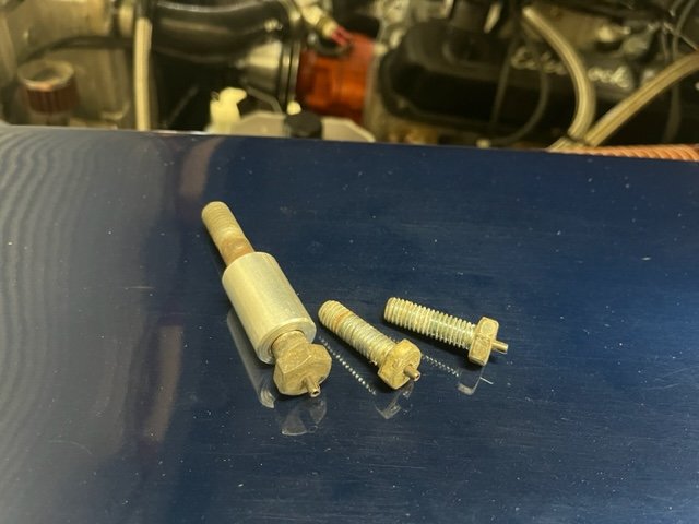

Found three likely looking bolts to mount a bracket to, but need to template the centres. Drilled out the bolt heads and fitted some small roll pins.
Cut a piece of plywood and tapped it onto the bolts
Posted: Sun Nov 27, 22 5:58 pm
by Matt

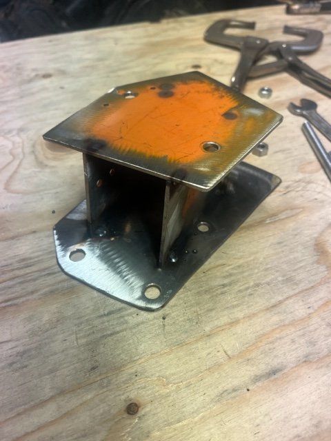

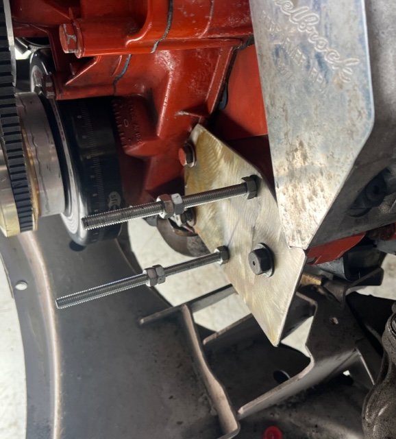

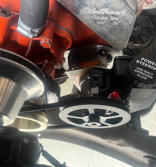

Used the plywood template to make the steel backplate for the bracket
and spaced the pump off on some studding to set the belt alignment
then made the rest of the bracket . Shown partway through here - further bracing to be added

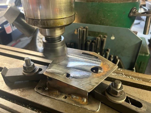

and faced off the pump mount surface, after final welding

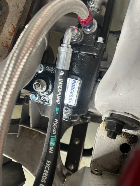

Fitting the Borgeson box was straightforward. I had to shim one of the mount ears slightly as it didn't sit quite flat on the K-Member.

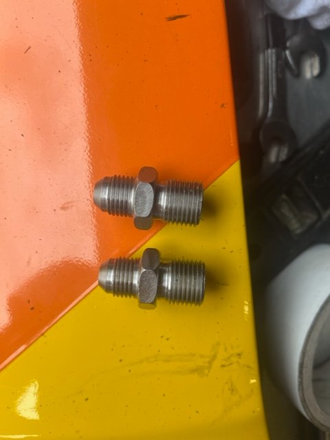

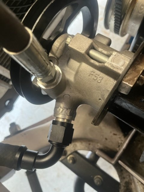

Adaptors also purchased from Borgeson to give -6AN connections to the box. A little roughly machined, and packaged complete with swarf, but they'll do the job.

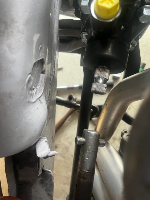

Box to column alignment is good

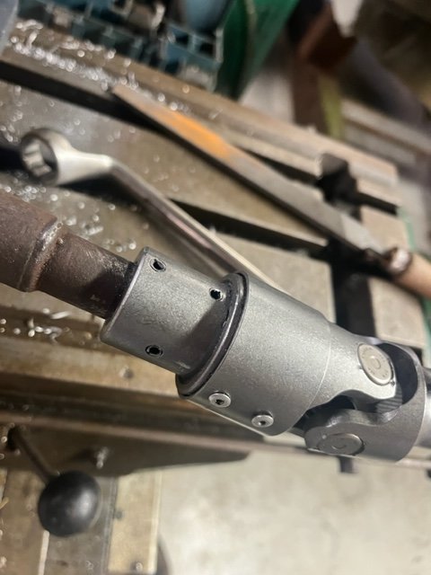

Mark column for cutting - it has to be a little shorter than standard

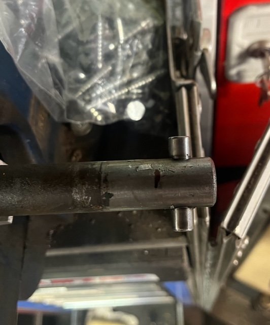

Cut column, Drill and fit three roll pins to retain UJ. Borgeson supply the pins and the correct sized twist drill with the UJ

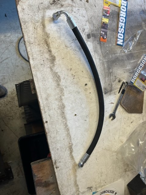

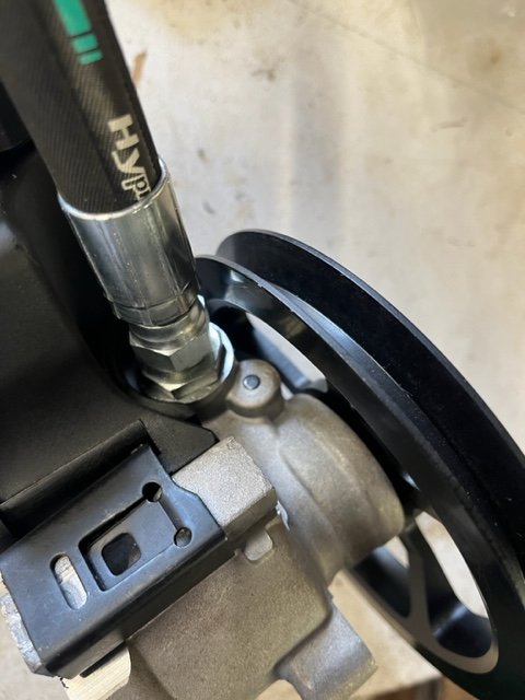

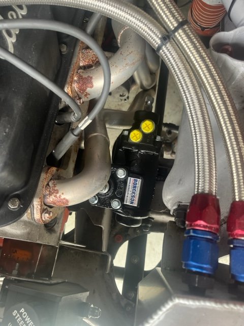

Had the local hydraulic specialist make up a pressure hose. Standard Aeroquip-type hose should not be used for PS as it's not rated for the pressure.
And I made up a standard hose for the return .
Posted: Sun Nov 27, 22 6:40 pm
by Stu
Cracking stuff! :read2: :salute:
Posted: Mon Nov 28, 22 7:11 pm
by Matt
The setup worked really well when tested in the yard.
On Brands Hatch Indy circuit however, it took only six laps for the fluid to get hot enough to melt the plastic reservoir on the pump. The return line fitting pulled out of its boss, and all the fluid escaped.
So a redesign is in order.
a) cooler needed
b) remote reservoir needed

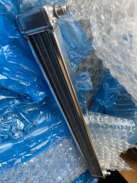

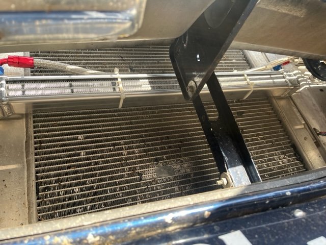

I was having a custom radiator made at Radtec in Cannock, and they do a BMW M3 race cooler with -6AN fittings - just the job

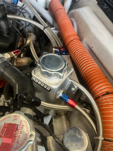

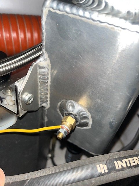

Selected a Moroso remote reservoir. Mounted it sort-of temporarily on the oil catch tank . Welded in an extra boss to fit a sender, so that I could keep an eye on the fluid temperature.
Removed the plastic reservoir from the pump and welded on a -10AN fitting for the feed from the Moroso reservoir.

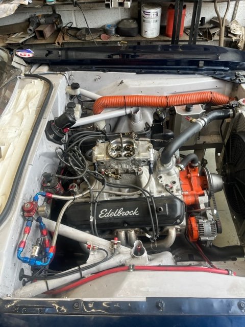

Mounted the cooler in front of the rad. The whole installation was done without too much care to detail, just to get the system working and testable.
Next time out was at Donington, and the PS performed really well. The fluid kept very cool, and there were no other issues.

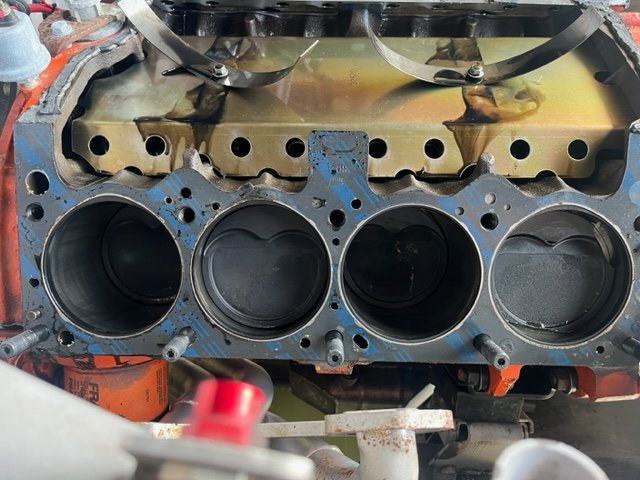

Engine-wise however, it looks like the coolant loss at Brands earlier in the season did have a few consequences.
I raced at the Spa Summer Classic in June, which was just an amazing experience. The 4.4 mile circuit sits in the Ardennes forest, and is widely acknowledged as one of the World's best. It's a great circuit to drive, and the whole place is full of history.
The car lasted the meeting, but was filling the catch tank with coolant every race, which (as long as the rad cap is OK) implies head gasket problems.

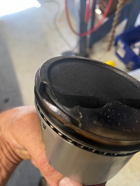

And indeed the head gasket had been pushed up towards the valley on several cylinders. Also #2 piston had a bit missing . Looks like detonation had been occurring, presumably at Brands when racing with no coolant .
Posted: Mon Nov 28, 22 7:39 pm
by Matt

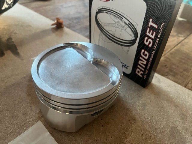

Fortunately a new piston was available from the US , and I got the whole thing back together again the day before Oulton Park in August
