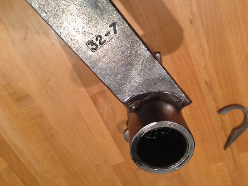

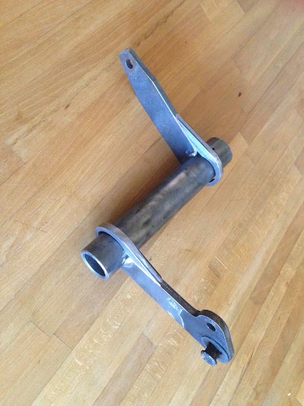

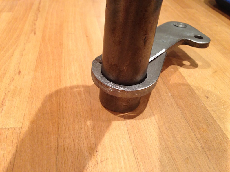

Bit of work on the Z bar, not keen on the way the arms are fitted to the tube, so I made up a couple of widgets to brace them up and give a full 360 degree weld. Just need a bit more grinding for a nice tight fit.
Posts: 6745
Educate me please Blue, what's a Z Bar ?
Posts: 14502
Part of the clutch linkage Mark. The tube runs across the car from the inner wing to the bell housing with a pivot at each end so it can rotate. One arm has a rod connected to the throw out arm, the other has a rod to the pedal. Here Endeth the lesson ;)
