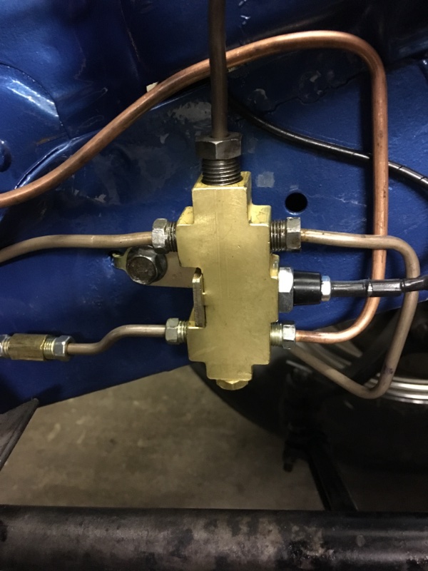

Engine is pretty much ready to go back in, could really do with fitting the new distribution block first, there will be pipework to alter no doubt...

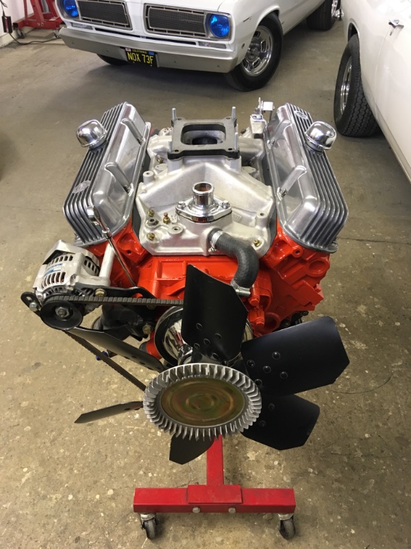

Thank you for the kind comments! Engines all done, just need to prime it, add plugs and 'stributor and it can go in. So what we have here is .60 over 360 which comes out at 371 by my reckoning, lightly ported heads and a Hughes whiplash cam and kit. I have a matching Hughes 2500 stall convertor to go in the box with a B&M flex plate to round it off. Glad it's nearly done I'm virtually broke physically as well as monetarily, I never intended to take this much on in one go, it's all AMD's fault with their 7 months and then nothing lead time....

WOW that engine looks good Blue,
You have done wonders as has been said I don't know how you find the time to do all these on your cars have to =D> =D> you mate.
Look forward to having a good look around your cars well done mate :thumbright:

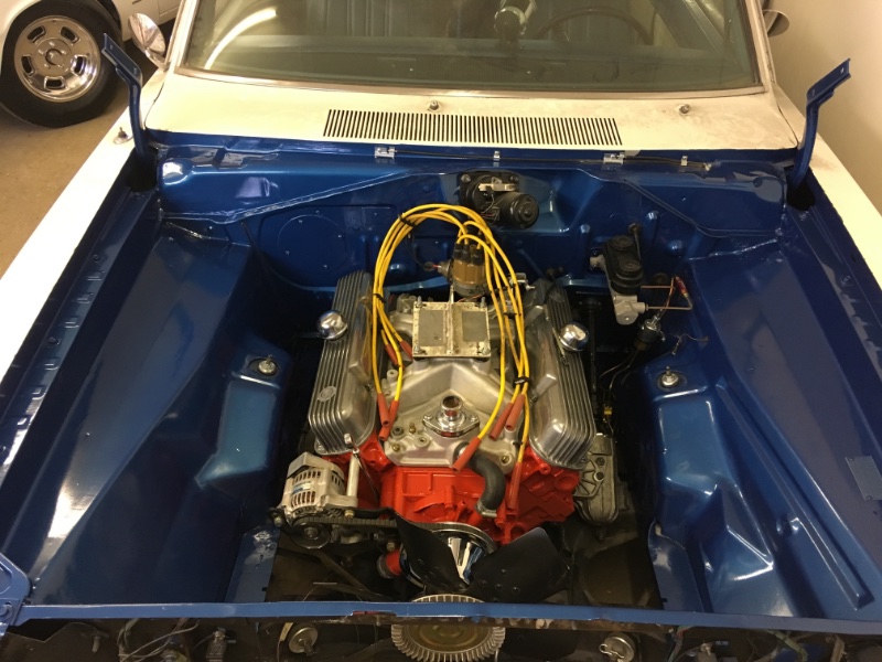

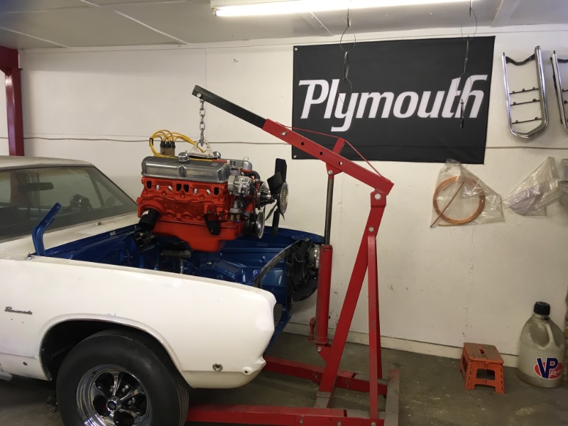

Replacement distribution block arrived yesterday so I whacked in on sharpish. Left overnight it doesn't seem to be leaking so I better stop buggering about and chuck the engine back in. How many hours now till the Nats?
Posts: 1611
Re: Blue's Barracuda
that looks pretty in there blue :D
