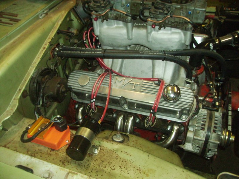

it seems to be early week as my oil filter also came 2 days before it was due so it'd be rude not to fill it with oil and spin it onto the engine surely? :D

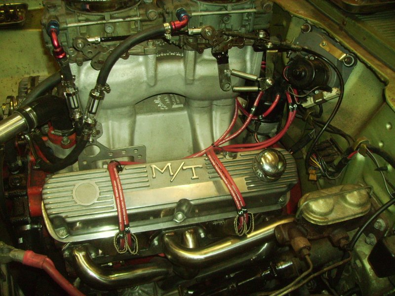

and whilst out there i thought why not make up the plug wires too? i copied the layout from a member of the A bodies forum as it looked very neat an di tend to be anal about neat plug wires :roll: . 2 hours later i'm happy with the look. i found a set of moroso heat shrink wire numbers (2 of each, for both ends) so used them too along with a set of heat shield boots at the plug end of each.
not long before the fire up now :thumbright:

forgot to say, i pulled a valve cover to confirm where number 1 was on the dizzy cap and the adjustable rockers that were thought to be 273 items have locknuts and screws. i thought the 273's were the 'friction' type where they're tight on the threads so have no locknuts? the heads are 3418915H 360 castings.
Posts: 1688
Re: 68 valiant signet 2 door
My 273 rockers haven't got locknuts, it is a very early motor though, can't remember the date but its a 64 or 65 block.

i guess it's possible someone chased the threads in the arms so they could use screws and locknuts, the arms look stock type so who knows. :-k

i forgot to mention something the other day when i made the plug wires and set the timing, my 318 must have an aftermarket balancer on it. as i'd said previously, i swapped on an early iron water pump with the inlet to the driver's side which partially obscures the (later) timing marks on that side. i also had (and fitted) the early timing tab as my damper has two slots which show tdc for either set of timing marks. result :thumbright:
