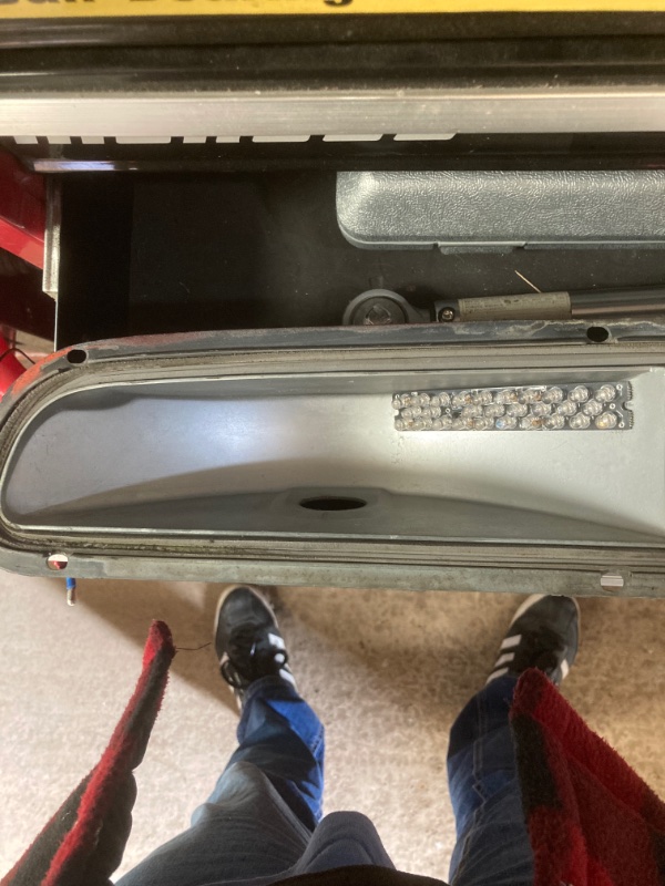

Is there room to fit the LED panel above the bulb and pointing downwards rather than outwards? Would imagine it would still be bright enough.

Currently sat in the garden in the sun, surrounded by parts, trying to figure that very thing out with a beer! 8-) :occasion5:

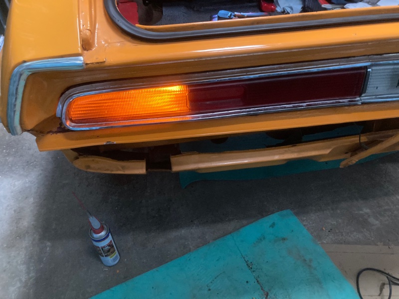

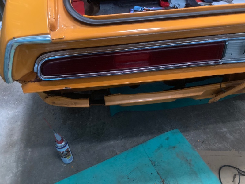

or..... is the led panel slim enough to fit in the centre of the light (behind the reflector bit) without any cutting? so where you originally said but no cutting, lol. it looks plenty bright enough but still quite red. what colour led's are they? apparently green led's should be used behind red lenses to give an orange light. it works, i did it with '55 chevy rear lights. :thumbright:
Posts: 7191
No, sadly won’t squeeze between. Going to test again tomorrow if it will work on one side of the tail light bulb in the end sections, without causing a wired shadow. I’ve been cleaning up the bits and trying to figure out what sort of foam to use to replace the brittle foam gaskets that were on there.
The photos do make them look quite red, but they are much more orange than they look. The LEDs are yellow. Not heard of using green, but will bear that in mind for future reference. :thumbright:

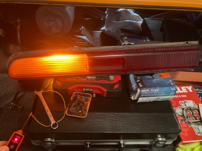

Bozwell wrote: Sun Oct 17, 21 8:53 pm get one of these (most factors have them)
very handy for testing and putting feeds to various units to test they work. (you still have to be fairly cautious as some units don't like 12volts)
Thanks for the recommendation on this, I’ve finally got round to using it and it’s the best bit of equipment I’ve bought for ages! :thumbright:

In the meantime, I’ve got back to my light cluster craft and this makes me very happy! :)
They even flash at the right sort of rate. 8-)
