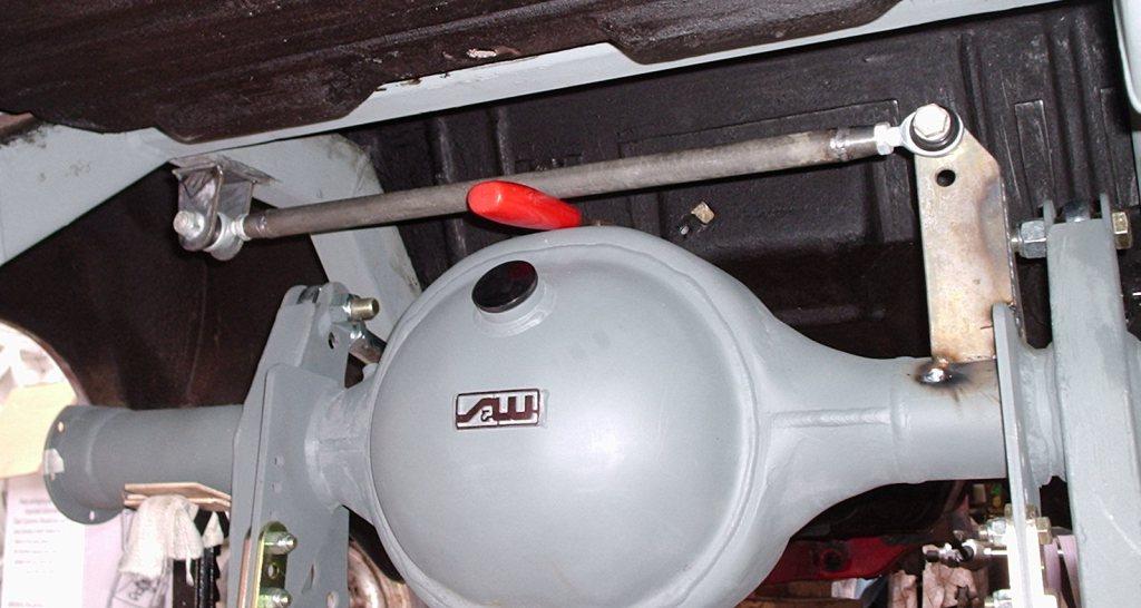

Mark, I assume you mean the diagonal bar between one of the front suspension mounts and the opposite axle end mount (as per a ladder bar)?
I agree that they are absolutely essential to control suspension movement safely.
When the Dart hit the wall at the Pod, this locator bent due to the force and the axle was free to move lateraly, scary stuff!!!!!
Posts: 6740
Not on my pc,as i would of posted a couple of pics from my set up, this link should help show what I mean
http://image.carcraft.com/f/techarticle ... guide+.jpg
Posts: 22140
I think we are on the same page!

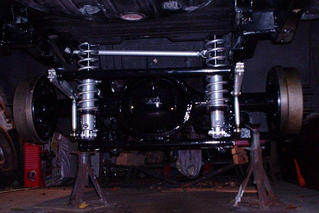

Worry not... I have a Panhard across the top of the axle.
I got it from S&W along with the axle, so i know it's up to the job.
The clearance between brace and prop is about an inch, that's with the axle hanging at full shock extension. I can easily move it lower down if you think thats too close.
Do you think I need any more metal anywhere?

DB - good news on the pan hard rod :thumbright:
An Inch should be OK, based on full extension. If it's a real easy job, then more clearance is better for that just in case,unlikely scenario . . .
Posts: 8368
Cheers Mark i can tweak a wee bit more clearance :thumbright:

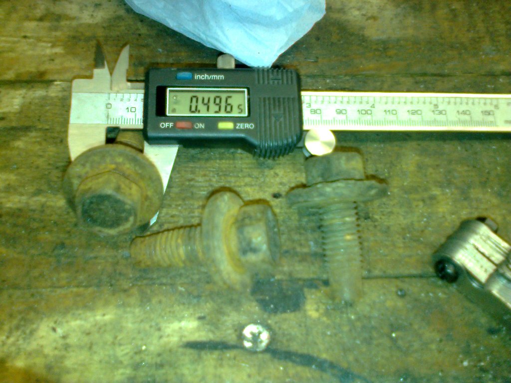

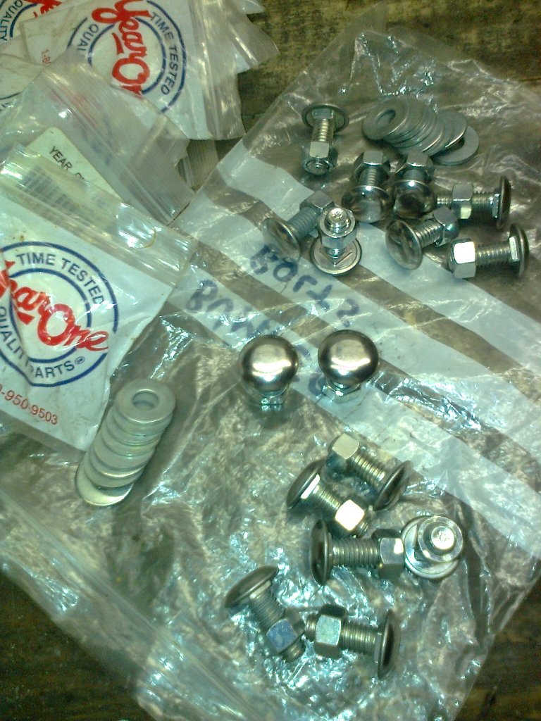

Anyone got any bumper iron bolts? I've only found 3 :(
