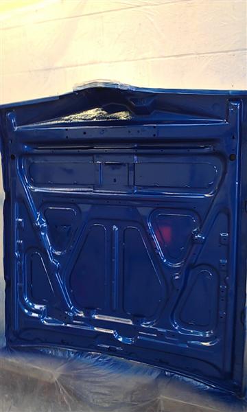

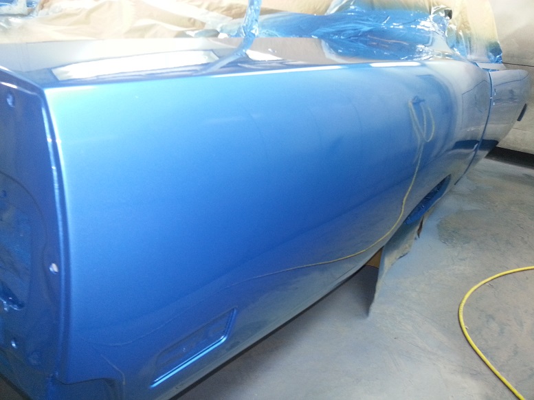

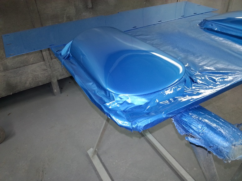

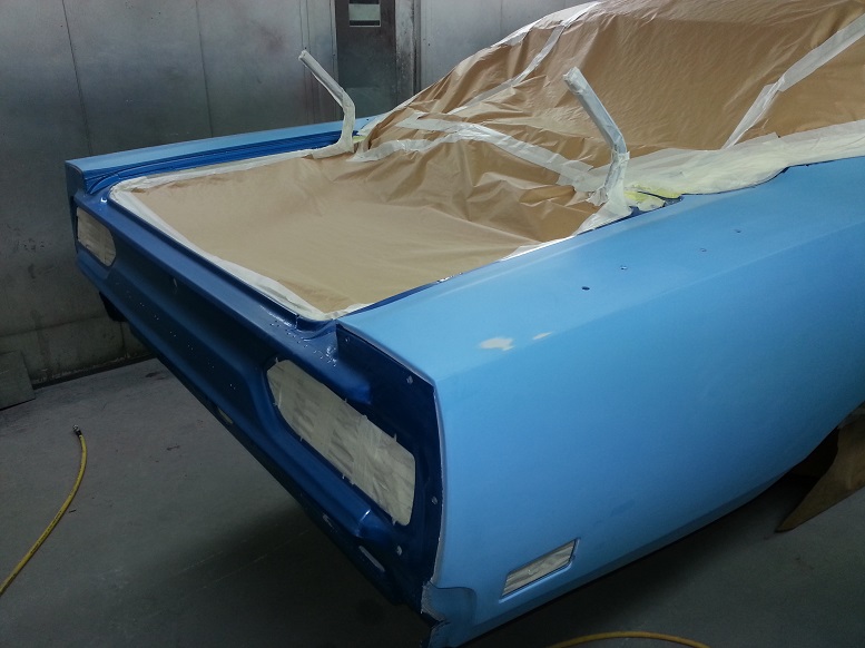

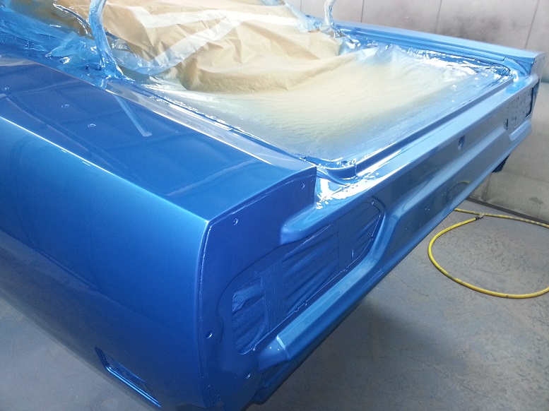

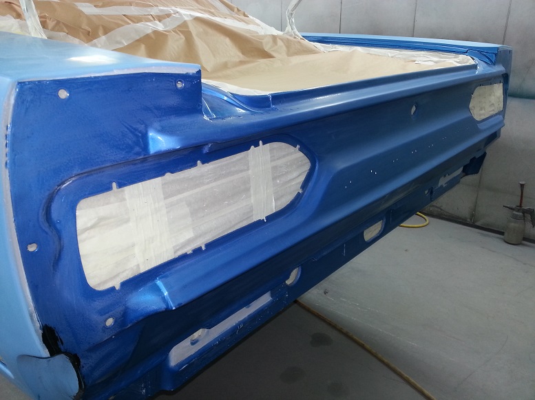

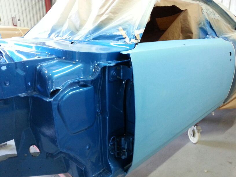

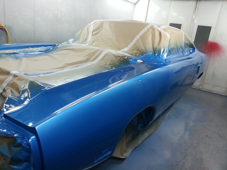

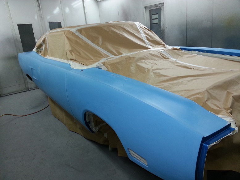

Post by steveo »
8-) :thumbright:
2013-11-23 15.46.31.jpg (147.71 KiB) Viewed 1193 times
2013-11-23 15.46.10.jpg (131.34 KiB) Viewed 1193 times
2013-11-23 15.45.59.jpg (203.14 KiB) Viewed 1193 times
2013-11-23 15.45.41.jpg (139.99 KiB) Viewed 1193 times
Carl
Posts: 4826
Location: Rochford. Essex
Post by Carl »

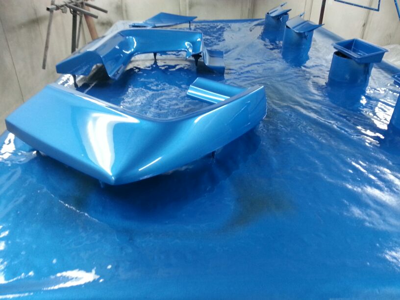

Wow thats looking great, what a lovely colour.

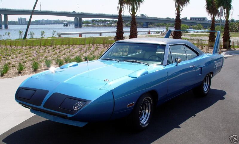

Philb
Posts: 485
Joined: Thu Feb 19, 09 11:11 pm
Post by Philb »
I`ve got one like that. You been working your magic again there Del ?

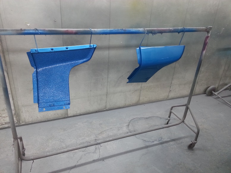

Look at all those shiney bits.
Got to be careful putting that lot back together.
:P :P :P :P :P :thumbright: :thumbright: :thumbright: :help:

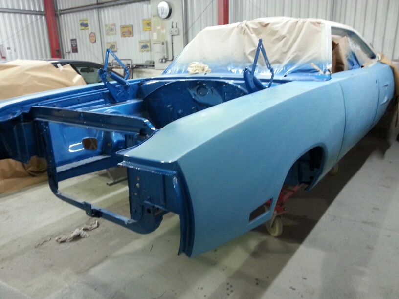

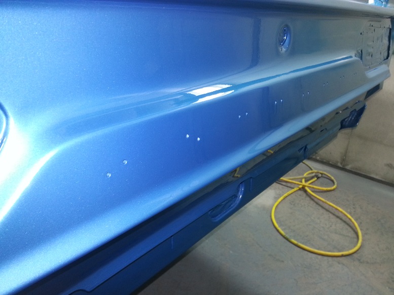

mas wrote:What would be the better brand/type off stone chip for this application? :thumbright:
i would not stone chip it why go to all that work getting back to and repairing the steel till its mint to go cover it in that tosh,,,,,,,, etch prime it, a few heavy coats off high build primer knib it all back then base coat and lacquer it, the ltd amount off use cars like this will get it will stay mint forever, i had a jensen mett aqua blue did this to all under neath inner arches etc etc looked as good under as on top only need to soap and water it off after a drive out looked stunning,
but also wax oil anywhere thats hidden= result,

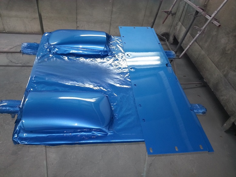

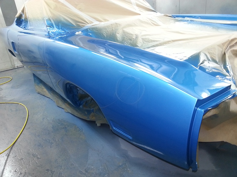

2013-12-21 16.18.27.jpg (121.99 KiB) Viewed 1534 times
2013-12-21 16.18.14.jpg (118.01 KiB) Viewed 1534 times
2013-12-21 16.18.06.jpg (147 KiB) Viewed 1534 times
2013-12-21 16.17.47.jpg (125.58 KiB) Viewed 1534 times
:P :P :P :santa:
