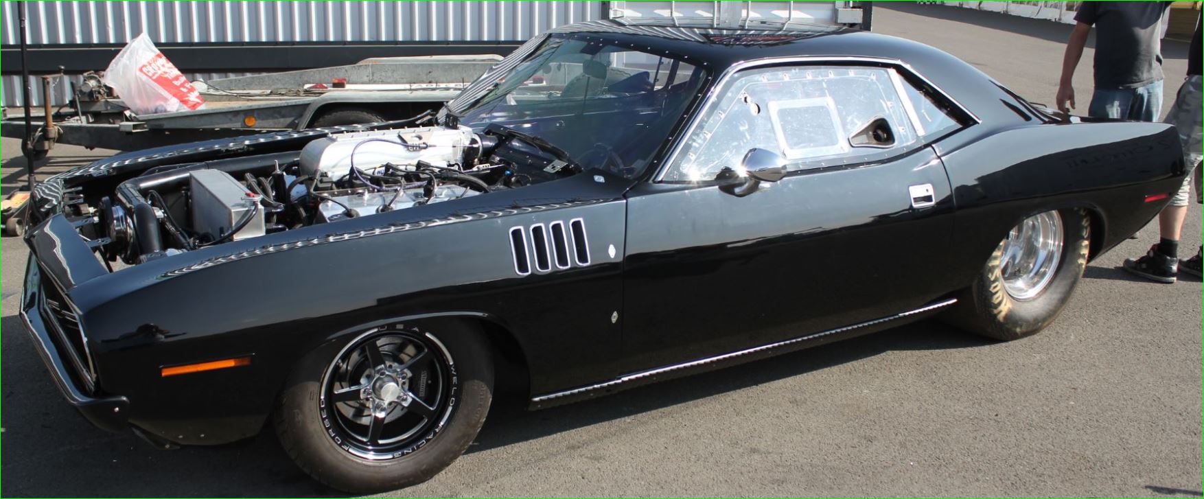

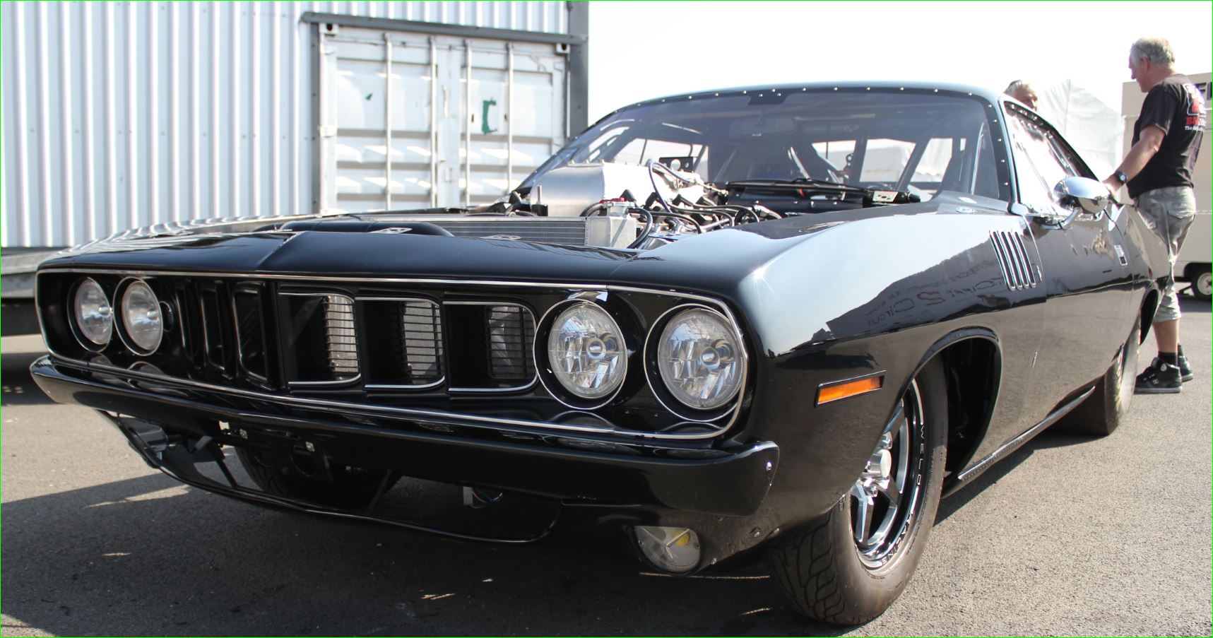

Nick wrote:you've still got the baddest Cuda out there. 8-)
Marks Cuda.JPG (210.7 KiB) Viewed 2473 times
Marks Cuda 1.JPG (233.42 KiB) Viewed 2473 times
Posts: 8369
A typical day in the life of a pro-street car ;)
Bad luck Mark, gutted for you that you didn't get a run, I know how frustrating that is!
If it's any consolation it looks even better in daylight.
We'll be back next year, better and badder than ever :D
Shame you didn't put in a pass.
But at least you got some bits ironed out in the pits.
Exciting times ahead :thumbright:
