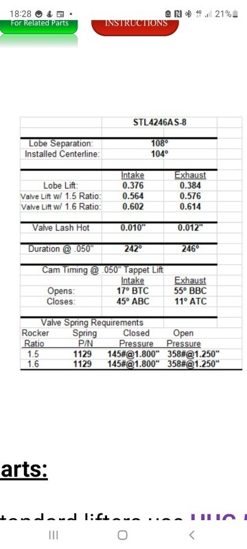

Re: Dave's 72 Dart
Here you go Blue:Blue wrote: Tue Aug 16, 22 9:16 pm Converter needs to match your cam choice and you won’t be choosing one that needs 5000 stall speed unless you’re going radical…

Re: Dave's 72 Dart
I'd be using a 35-3600 converter with that.

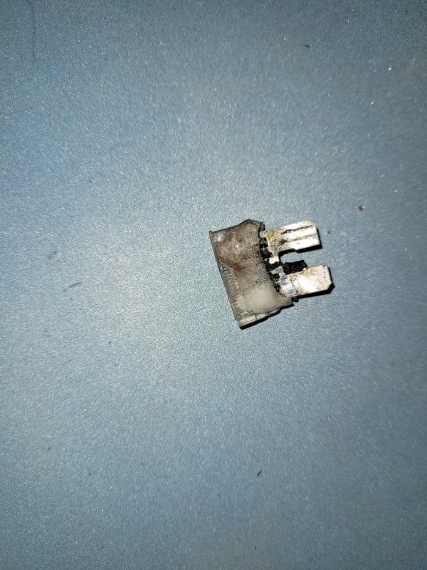

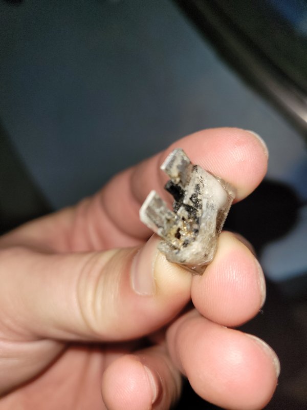

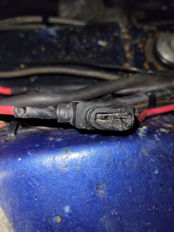

Still waiting for parts from the states. This could be a long term engine build.
So decided to take it out for a quick trip down to Ludlow to get some V8 goodness. Usual thing is to hold it on the starter for 10 seconds to get a bit of oil circulated. It kicked once and died. Tried the key again and nothing. Opened door and noted interior light was no longer on.
So guessed it was the fuse not the 6 month old battery.
Got rid of the old fusible link when wiring 6 years ago and replaced it with a blade fuse. Took off the protective cover and found this......
Think that's a long term heat buildup, not a freak from today, its just finally blown. The fact it melted into the holder is a bit concerning.
Couldn't find my spare fuse holder, so online shopping for tomorrow delivery. I will drop the new one in with another 25A fuse and keep an eye on it. Need to check my AA cover and fire extinguisher is still good.

Re: Dave's 72 Dart
have a look at maxi fuses and holder mate, plenty on ebay etc

Re: Dave's 72 Dart
Agree, I’d at least use a midi fuse for that kind of job.
