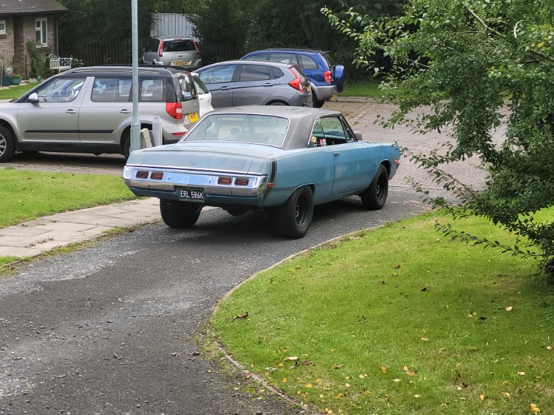

It lives again. Electrics sorted.
30 mile round trip for fuel without issue. Happy Days.

Re: Dave's 72 Dart
Looking Good
After a 30 mile trip for fuel, you'll probably need to go and refuel....
Re: Dave's 72 Dart
Joys of living in the sticks mate.
It's a great drive though with good A roads and little traffic.

Re: Dave's 72 Dart
Dave81 wrote: Mon Oct 03, 22 1:05 pm Joys of living in the sticks mate.
15 miles round trip to the Shell at Bridgo, Buddy. I reckon you did 15 miles fast lapping the bypass.
