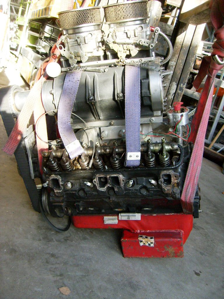

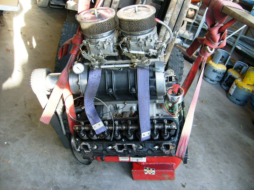

Dave Dillyboo is still building a 408 stroker for me but that won`t be ready for some time due to waiting on some of the bits.
So I grabbed this to put in the Valiant short term. Needs a bit of a tidy up ; new sump, new gaskets, new water pump, new msd dizzi, new blower belt then it`s good to go. Will have to temporarily move fuel lines and radiator to accomodate this.

whats that been in and done jon ???? size
Dave-R
Posts: 24752
Post by Dave-R »
Is that the 360 that was for sale recently?
Jon Connolly
Posts: 3116
Post by Jon Connolly »
dunc
light duty, was in a road going 32 ford hotrod, owned by a 70 year old guy so wouldn`t have seen any hard life.
360 c.i. + 6/71 blower + twin 600 carbs ... nicely built with all crower and manley bits

Need to check pulley alignment too as the belt seems worn on one edge .. don`t know if this is normal ?
Posts: 22170
Either 273 or T/A rockers there, or are they after-market??
ANTON
Posts: 2046
Location: Sutton,Surrey
Post by ANTON »
Pete wrote:Either 273 or T/A rockers there, or are they after-market??
Look like 273 rocker as I have a set to go in my new build.
Posts: 14526
Either 273 or aftermarket rockers, T/A ones are offset. Unusual looking 2 piece blower case, 6/71's I've seen before are one piece, not that I know anything about them. I didn't think you'd be able to resist that one Jon!

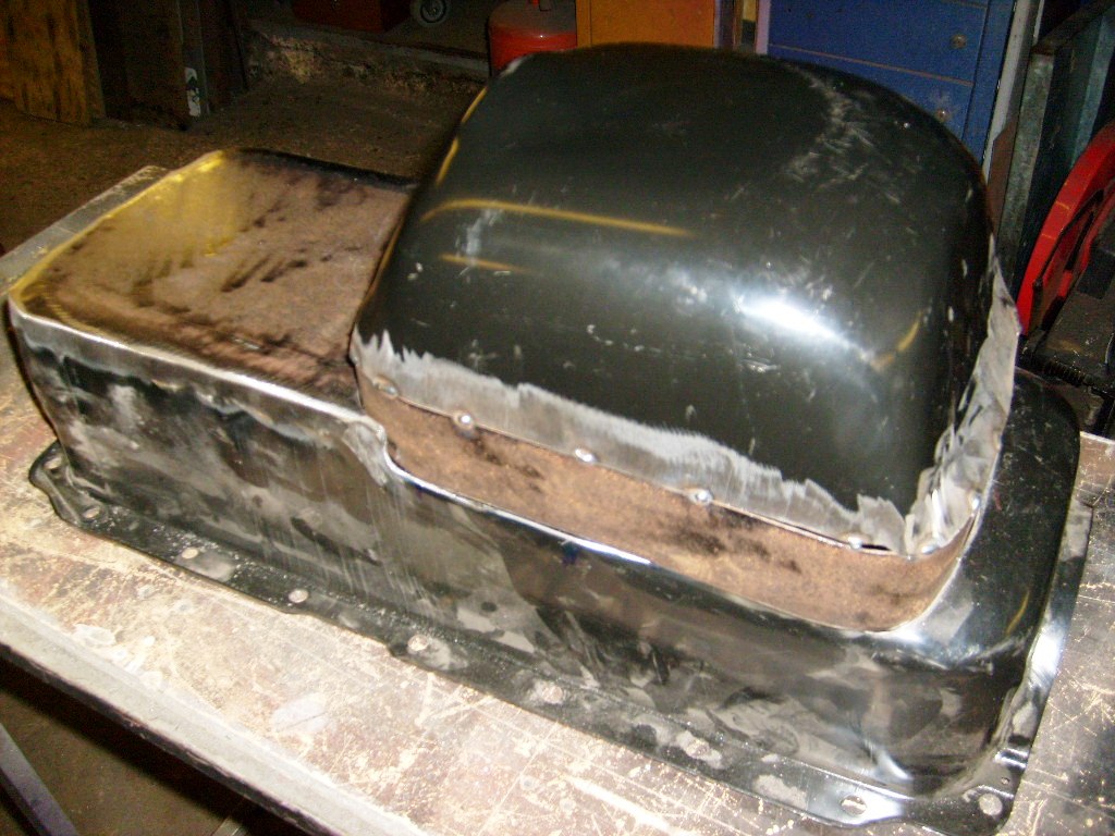

Started making my new sump today to clear everything, starting with a new passenger car sump. Will be adding my own baffle plates and remaking oil pick up tube.
Hope to get the engine in next week or just after Christmas.
Don`t let anyone tell you smallblock stuff is cheap or easy, always seem to have to modify stuff to get it in
:cry:
