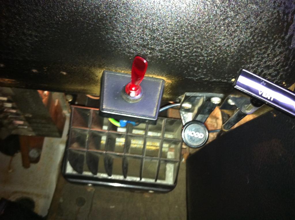

hello
been away
hood release

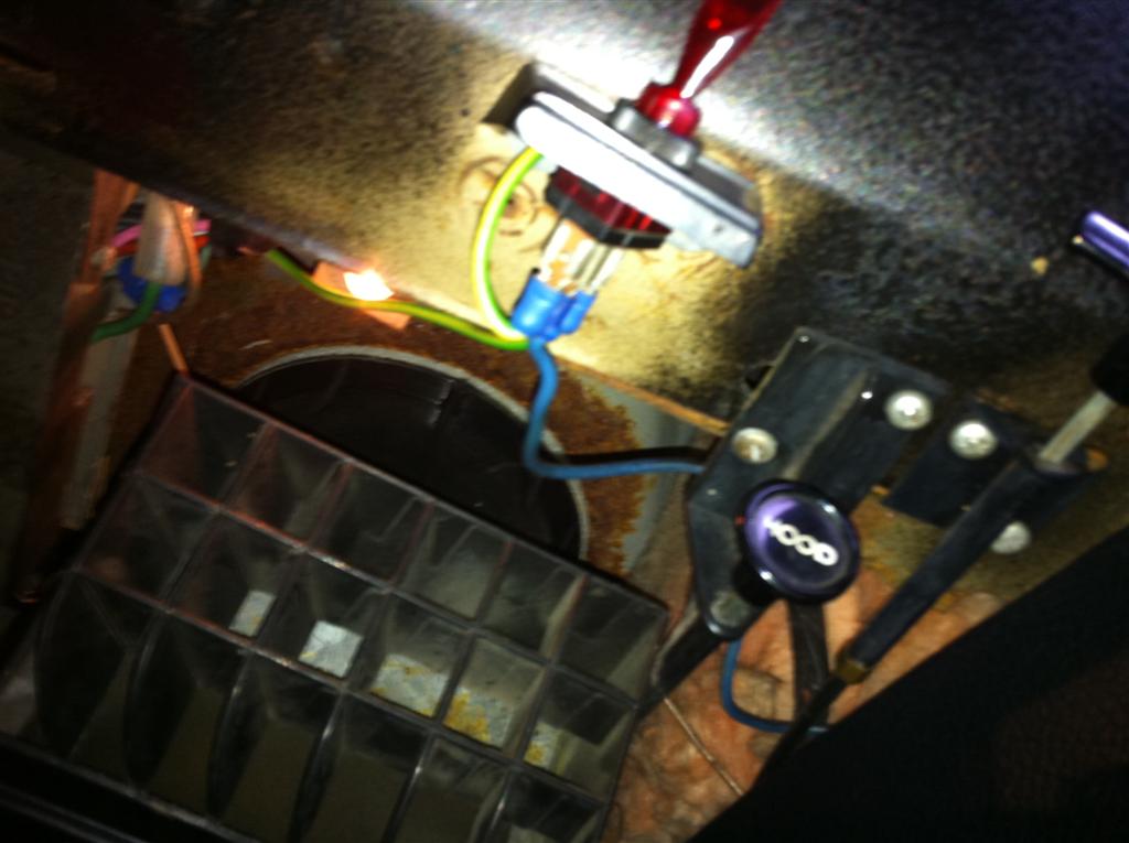

round knob sits behind the air vent squre knob bolted to the underside of the dash or indeed the inner wing...
it will be held on with self tapping screws

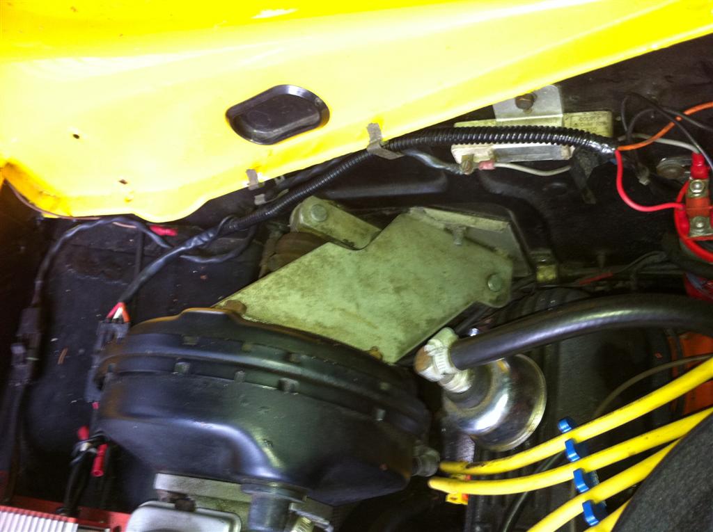

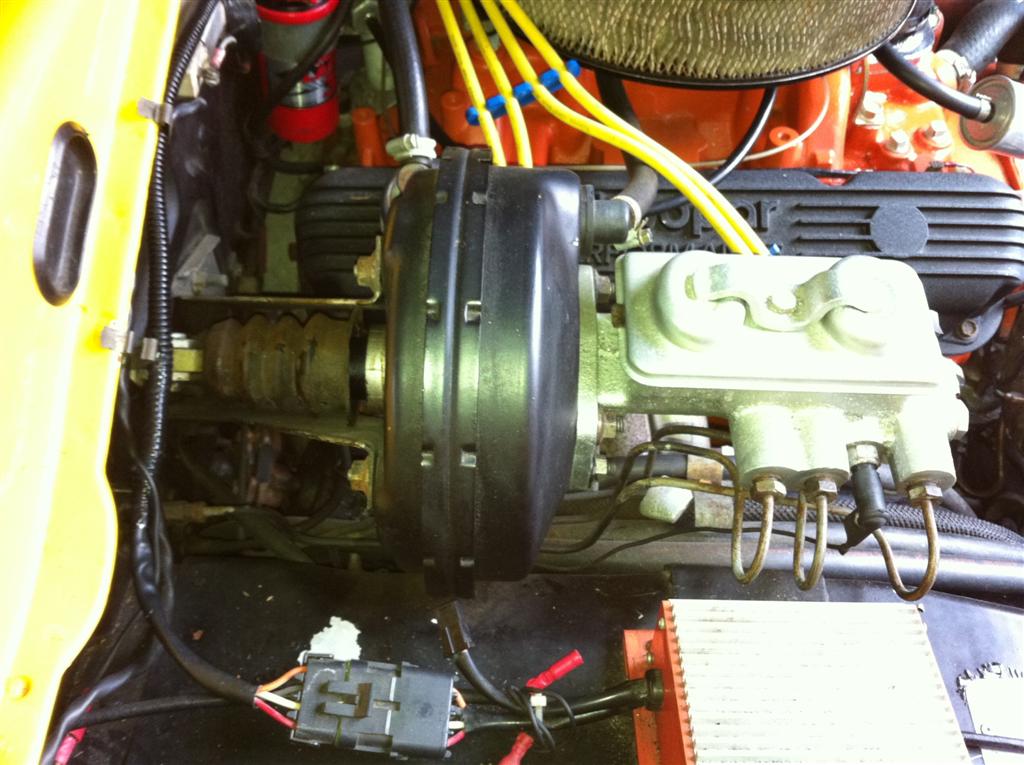

manual brakes are fine they are infact too good...
i can lock the back up no probs. they never put a booster on the race versions due to flatting the tyres all the time

but to go manual brakes of any type you would just need appropriate master cylinder and rod and swap the rod on the peddle to the manual brakes hole
i have booster off wrecked vj with later alloy PBR master cylinder and some of the mounting brackets PM me if you are interested. god knows if it works....

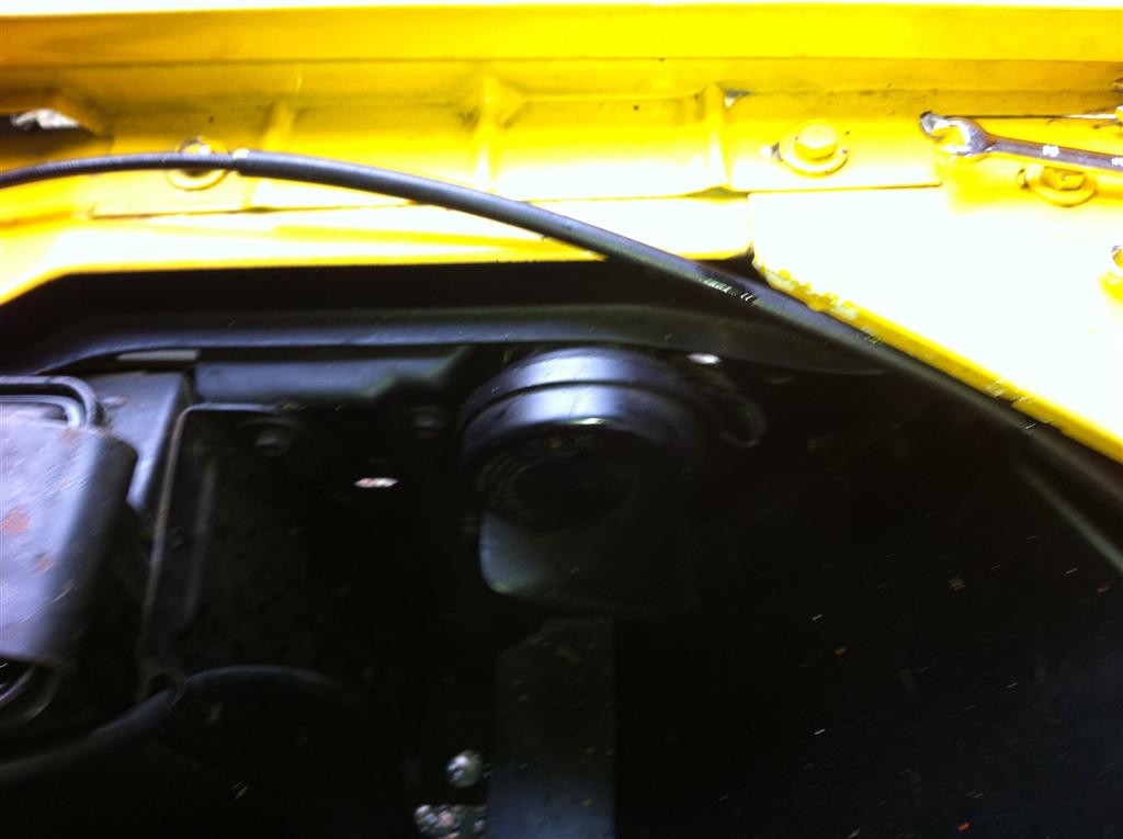

the Horn bolts to the radiator support on the drivers side behind the headlight above the inner wing side tray that comes out of the join with the chassis leg. I have 2 horns due to RT status but just bolted on with 7/16 bolts. there will be holes

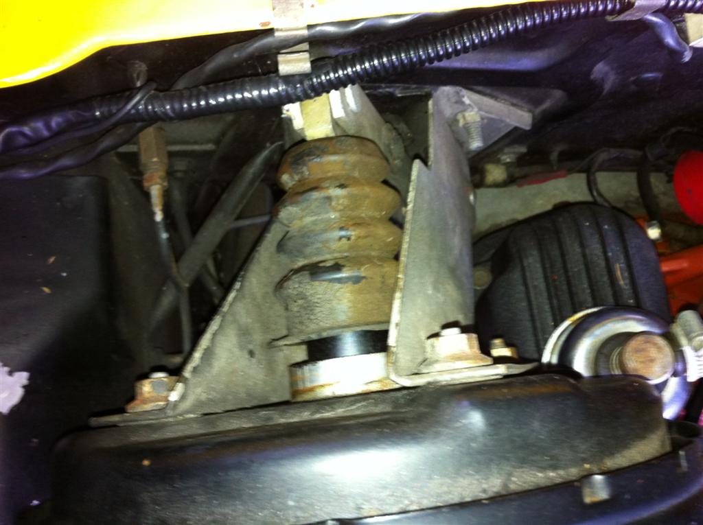

A Few Piccies!
- IMG_0315.jpg (131.82 KiB) Viewed 1808 times
- IMG_0314.jpg (95.94 KiB) Viewed 1808 times
- IMG_0313.jpg (120.68 KiB) Viewed 1808 times
- IMG_0312.jpg (97.83 KiB) Viewed 1808 times

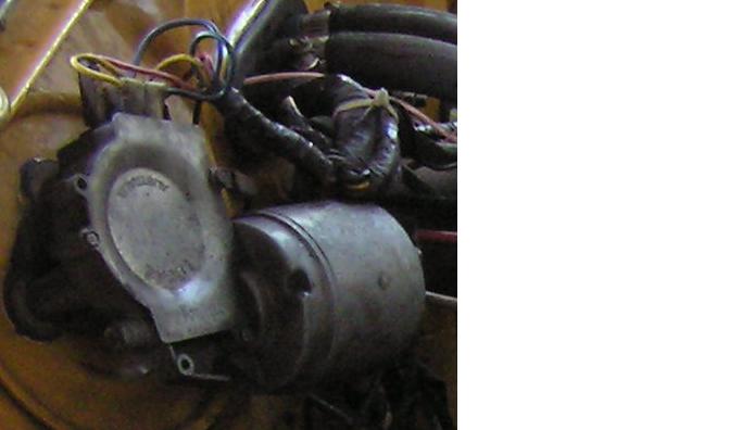

Couple more peices of info please chaps:

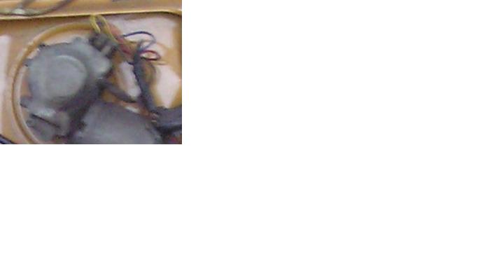

The wiper motor has 6/7 wires attaching to several terminals. Can someone give me a run down of which terminal fits which coloured wire. Saves me pulling the dash out again and following wire paths as a circuit diagram I have isn't helping !

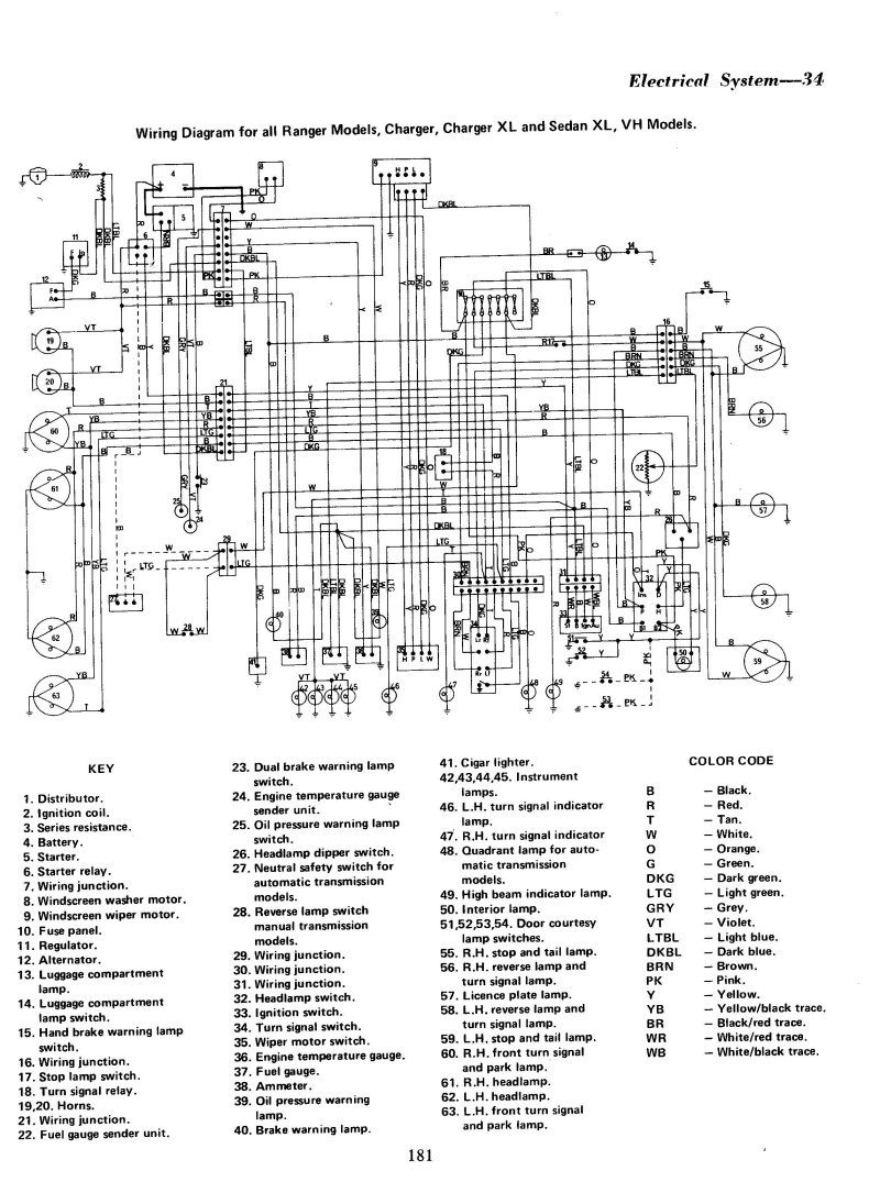

VGVIP
Hi.Sideways wrote:.... a circuit diagram I have isn't helping !
Do you have the Chrysler factory workshop manual (or a Max Ellory's reprint) or a Gregory's/Scientific Publications?
The Gregory's and SP have no where near the content of the Chrysler & Max Ellory.
The wiring diagrams in the Factory books is usually spot on and with clear colour code.
I find some diagrams in my VG Max Ellory a bit difficult to follow, it is a 50% reduction where they have put 2 A4 pages of the original factory copy onto 1 A4 page.
So my Max Ellory gets used in the shed with oily hands and the original 40+ year old one stays in the house.
Maybe some one with the original Chrysler VH manual can get a copy of the wiring diagram for you.
I did not know but it looks like the VH workshop manual is in 2 sections.
http://www.pentastarparts.com.au/sunsho ... list&c=210
Ive got a VH manual
will scan the 770 section
but to keep you going here is the XL and standard no luxury set up and a few pics
- wipers 2.JPG (24.22 KiB) Viewed 1755 times
- wipers.JPG (11.61 KiB) Viewed 1755 times
- wiring_vh.gif (246.31 KiB) Viewed 1755 times

Cheers Dave the photos did the job, allowed me to put the wiper motor assembly together, fit, then connect the right spades and voila one working wiper motor !
Have Max Ellory part 1 and 2 books but the diagram isn't clear ref the terminals, hence rather than risk blow the motor thought I'd pick someones brains.
