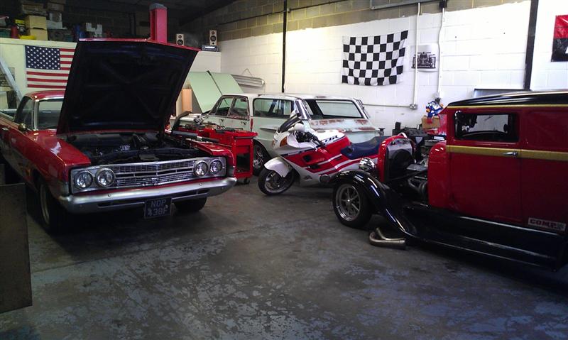

A few more that have been in Anton's Workshop recently, varied amount of work done to each vehicle.
The 68 Ranchero on the left came in as a non runner, but within a couple of hours Anton had it running. Another well now garage sent the owner away with it as they could not get it to run, they even lost the keys to it.

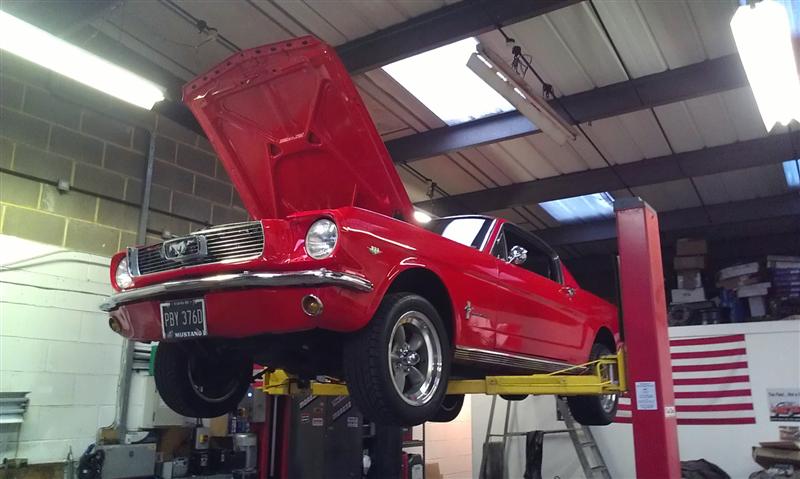

Anton has done the the transmission lines, a bit of welding and the door hinge pins along with other bits and pieces. on this 66 Mustang

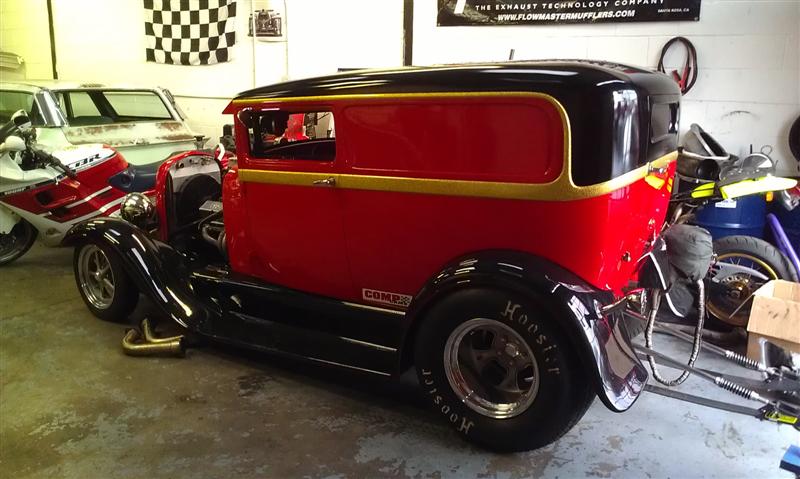

The owner of this 29 model A has put the engine and gearbox in the whole, but that's about it, Anton has the rest to do then get it driving.

This Mustang has so much work done on it now, but most of it can't be seen.
