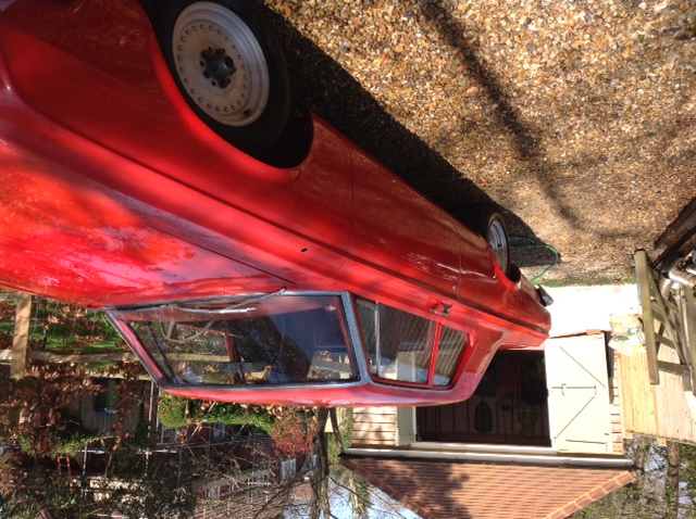

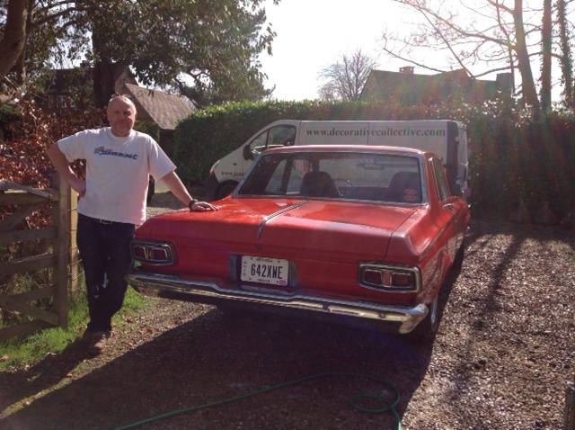

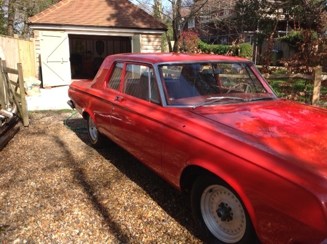

pete walton wrote:Duncan you have to see this car mate ,the headliner is the origional and is perfect the rear seat looks like its never been sat on,Someone has raced it at some time fuel tank has a sump cut into it ,oil pan has been cut and exteneded ,the old Cuda had the same modifcation,K member has been modified,it has some old faded stickers on the windows that say Plymouth racing ,,factory member.... The vin plate behind the drivers door just tells me that it was a v8,Savoy and were it was made ,,,,were would i find out colour engine size etc .....
I REALLY APPRECIATE WHAT YOUR SAYING PETE, FLIPPIN CAPS LOCK Bananarama! but this car is not you it never will be and you will get fed up with it like the cuda.
a camaro or javelin or 70 cuda/challenger is grying out for you to do your stuff with it

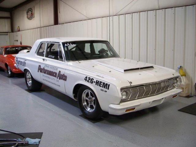

Get it signwritten Pete,put a 440 in it,job done,forget doing 426 max wedge or hemi,cost a fortune.
Have a guy up here whos a mint on lettering,look at Kiwis Duster :thumbright:

Well after wasting a good few hours of my life trying to decode the fender tag which was painted over a bit i have made some progress... interier code is LIR which if i am right is red ,,,,,paint code is MMP which i think is a sort of silver.... engine code is either 014 or 012 which means nothing yet.....chuff me this vin licking is not much fun

Run the ole girl round the block today...no rear shocks and open headers ..... for some reason i am standing on my head ....technical malfunction

If i'm not mistaken, the new mopar performance heads are stock legal, basically an edelbrock with straight plugs. Be a much cheaper alternative to max wedge heads, also US made and repairable.

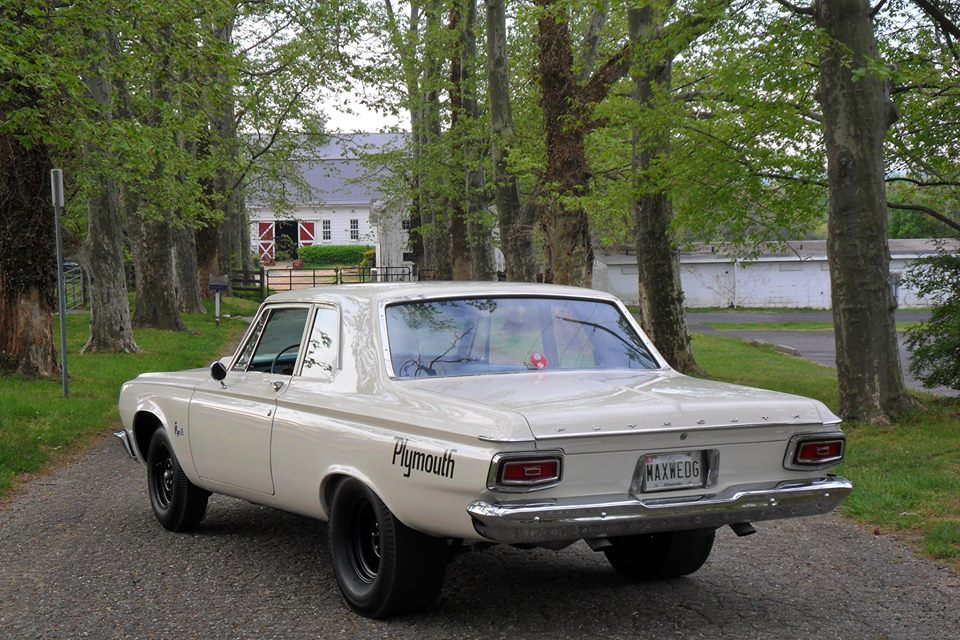

Mick i have a couple of options to do this foolish mission i am on ....One is Max wedge the other is 383 ..there is a third but that ain,t an option ...If i can land a 426 MW block i will go that route ...That will be with iron heads which you can buy brand new ....two compression choices 13.5 and 11.5 ... Only Ross make the pistons....
383 i would go eddy heads and fabricated inlet..both legal,,, Mr Chandlers fav this one and the cheapest.....
