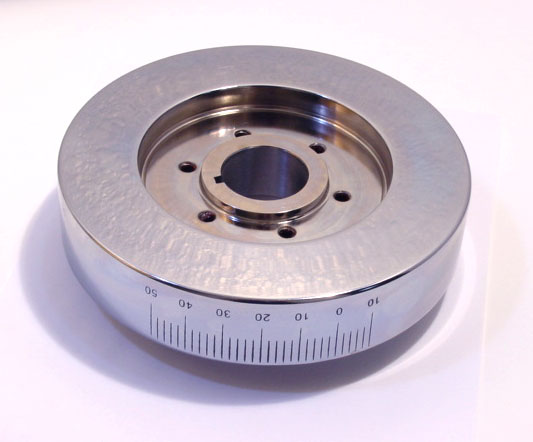

GJUK
Posts: 2486
Post by GJUK »
Thanks,
That looks like a cool paperweight :D
