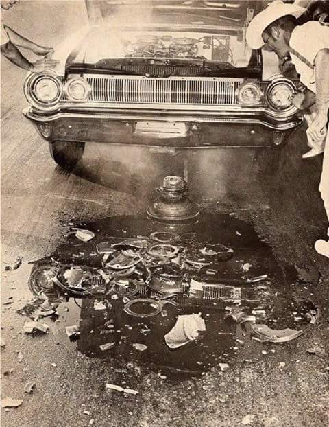

mad machs
Posts: 2322
Post by mad machs »
Coulda been worse...
Mike that is called Mike.
69 Dodge A108
73 Mach1 Mustang
MilesnMiles
Posts: 7309
Location: Cornwall
Post by MilesnMiles »
Time I've pulled it out Mike it wil look like that ;)
Cool hat.
Posts: 22110
Looks like an old picture of a dead drop to me.

That's a real oildown :shock: Not the 2 drips that Santa Pod take 1/2 hour to mop up :lol:

Posts: 14426
Pete wrote:Looks like an old picture of a dead drop to me.
Ron Mancini way back in '64, last of the legal neutral drops, NHRA banned such craziness after that little episode and quite right too.

Posts: 8368
Dead drop?
