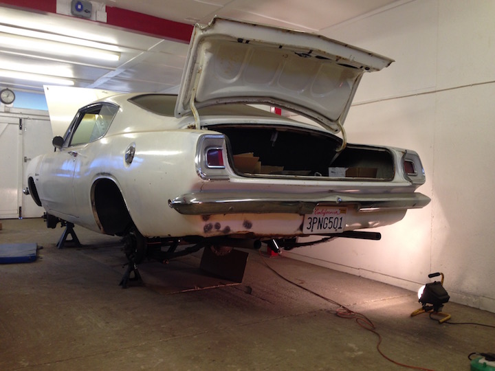

You'll have to wait a bit yet Dorian but keep the money warm for me! Replaced every bush and balljoint on the front, new hoses, brake lines, wheel cylinders and shocks all round. I had a manual steering box in stock so I swapped that in too, I'm not keen on power steering on these cars. Currently trying to unsieze the handbrake cables. Still got a fair amount to do for the MOT but the list is getting a lot shorter...

No worries there, its squirreled away in readiness ;) looking good Blue, can't wait to see it this summer... I assume this is a small bolt pattern car? Are you going to change it? :thumbright:

Yes it's SBP. I will be having a word with Trev D to see if he can re drill the stock set up as a short term fix so I can put a decent set of wheels on it. In the longer term I will fit front discs and have the B body 8.75" axle I have in stock shortened to fit.

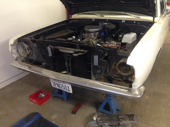

Work continues, bought a complete screen washer kit as I was missing everything, so that's done. Found out why the pulleys didn't line up, the water pump one was off a Ford :roll: , new pulleys incoming. Started the headlight swap and conversion to halogen headlights, front panel had some dents and the grilles needed looking at so I pulled the lot off for easier access and a bit of a sort out...

How weird is it that the Ford water pump actually bolted up??
