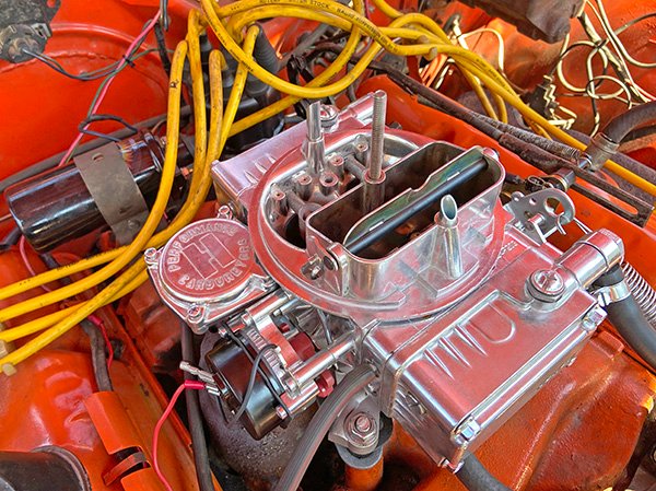

So ditched the troublesome Edelbrock and fitted a Holly. The performance is better. Also fitted a new PerTronix, new distributor and new spark plugs. Seems to be running better.
