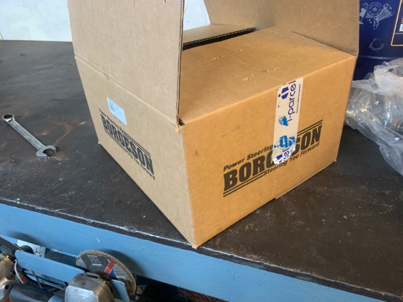

Blue wrote: Fri Jan 03, 20 12:12 pm Wasn't aware of the steering box angle difference between the early and later B/E K frame, handy to know.
Im not sure it is as the new box arrived and it's identical.
The only difference between a 1 1/4 box and 1 1/8 box aka (early / late) is the size of the output splines .. 1 1/4 and 1 1/8.

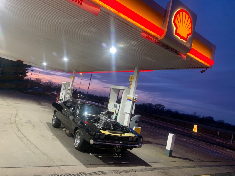

My review is good
The unit does what it says on the tin and really happy.
It’s lighter than I was expecting which is great as I love my PS
With no play I now feel I have more confidence to drive it quicker.
Great upgrade should have done it in the beginning

I cant believe you managed that 'in situ' ! Well done.
My rebuilt steering box is super light now but I wouldnt say the feel is any better. Good move i think.

The box is identical, it's the K-Frame that's different - the tabs mount the box at a slightly different angle.....autofetish wrote: Tue Jan 14, 20 8:56 amIm not sure it is as the new box arrived and it's identical.Blue wrote: Fri Jan 03, 20 12:12 pm Wasn't aware of the steering box angle difference between the early and later B/E K frame, handy to know.
