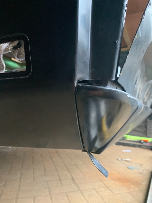

Okay, so. On these posts, it seems one only likes to post progress ~ unfortunately I have to come clean. After posting those wonderful pictures of test fit complete… something was niggling away at my OCD disorder :D
The driver side corner valence….
Man those little F&£*#@%s really don’t like to play ball. Just won’t friggin listen. So as good as those pics look, when I get a laser on them, the driver side was lower my about 8mm.
At this point, when I picked up on this, it was already welded in. 😩
Couldn’t sleep properly last night and couldn’t concentrate at work. Kept thinking 8mm lower, 8mm lower, I’m a fake, I’m sham, 8mm lower 8mm lower 😂😂
So I come home from work today, with a drill and a grinder equipped, charged and at the ready, took to the annoying little “beep” (input swear word)
Literally had to twist the quarter in order to get get in to place. Sweating in this blazing heat. But how good do I feel now?!
Just for the record, where the valance meets the corners, I need to dolly it down a tad. That is not the finished article. Once it’s welded in i will get shaped back to meet the shape of the valance line.
So happy that’s out the way. Time to start welding the rest of her up!

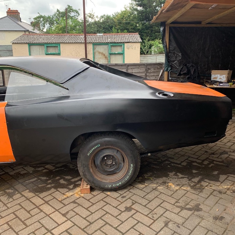

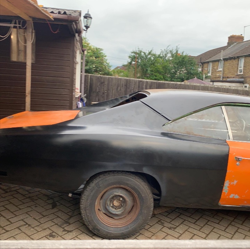

Just to further update…
Still at the arse end of the charger, still measuring, still cutting. Panels still going on and off still rust protecting etc etc…
Until today!

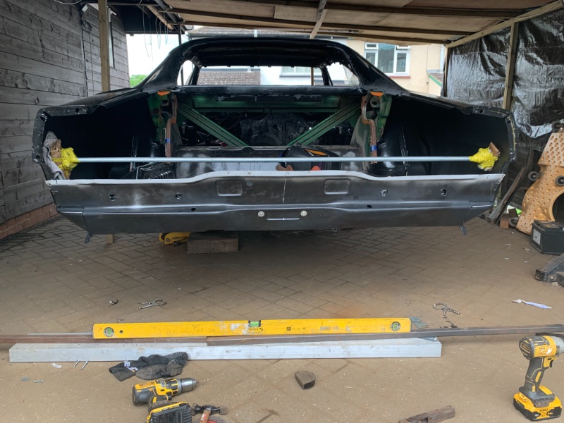

The corners were a challenge, and alignment to factory spec had me chasing local chargers to measure, yet again. I know I have factory width at the widest part of the rear, I know I have the exact measurements between the corners and I know I have the exact height between the valance and the light panel. I also kept parts of my old charger, and I transposed the exact curve of the quarter (where the extensions attach) as I was able to transpose/trace the curve on to my new quarter.
Next up will be the deck lid. I do still need to finish welding the quarters inside the door jams, under the arches, to the pinch welds, rockers and to the sail panel. However I won’t be doing the sail panels until the roof skin goes on so I have the “play” should I need it.
Next time I post I’d have moved on from the rear of the car and il have some new pics that will keep this thread interesting. For now, one last set of pics of the rear welded and done with. Happy to see the back of this part of the job (literally :D) I’m very happy with how it came out.

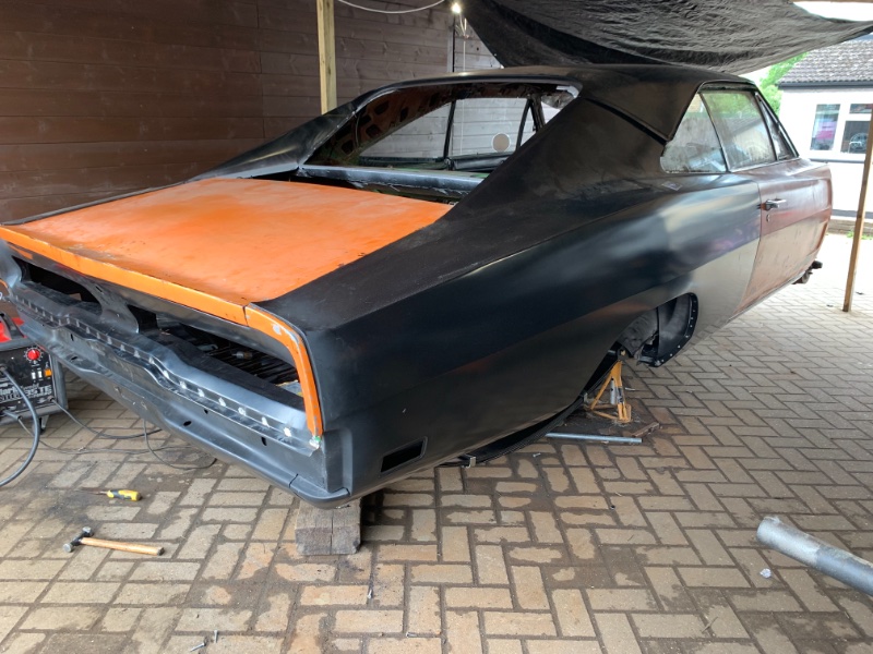

Anyhow… suspension is in and car is on all fours :) I have had the deck lid measured out and it fits quite nicely… yyyeeeaaa! Also installed the deck filler panel. Got this nice and tight by ratchet strapping the whole rear end of the car to suck those quarters right tight together. I don’t know if this is how it’s typically done but it worked a treat for me. Only wish I had taken some pictures. Also I was having nightmares that the car was going to tilt to one side when I dropped on on to its wheels… but I am ecstatic to say it sits straight and true! I did not hear my welds popping as I dropped it off the jack so that’s a good sign too he he 😂
PS. Welding upside down is not easy 😩
Some pics of where I am… that’s the new roof sitting on top not yet installed. Storage is becoming a problem so this is where it will stay until installation time comes.
Not sure what to do next, I have the new roof and the floor to do. Wondering if there’s a option thats better structurally. If anyone has advice il take it 😊
