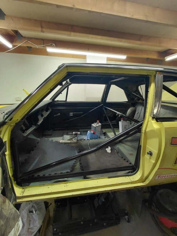

Posts: 22186
Re: Hemi into an "A" Body - How hard can it be???
To paraphrase another member "Let's go racing , it will be fun, how hard can it be??"

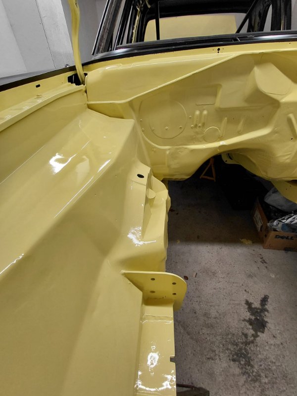

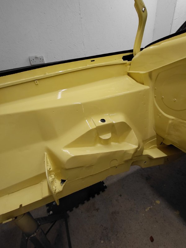

Posts: 22186
This was "Measure once, Cut and paint Twice" as I could not reliably get the PASS Side Rocker Box off for servicing.
However, tolerances are SO tight on this build that one millimetre is a large clearance; so I guess we could be forgiven...
