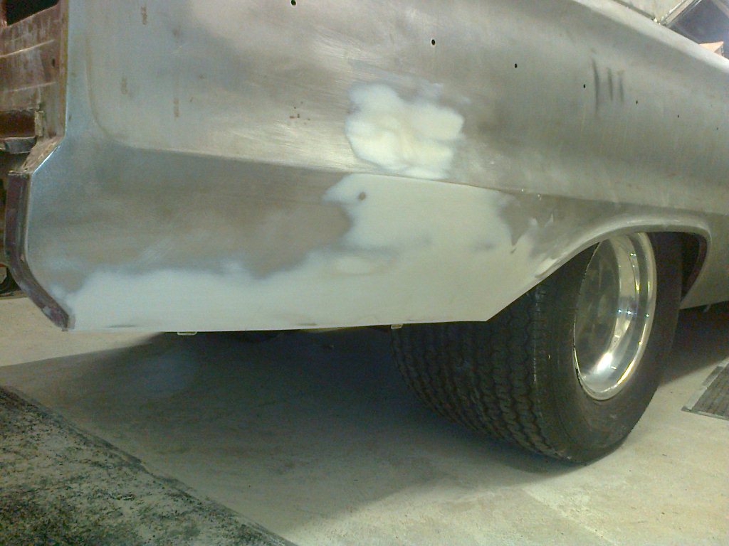

Tere's actually some progress to report!! :D

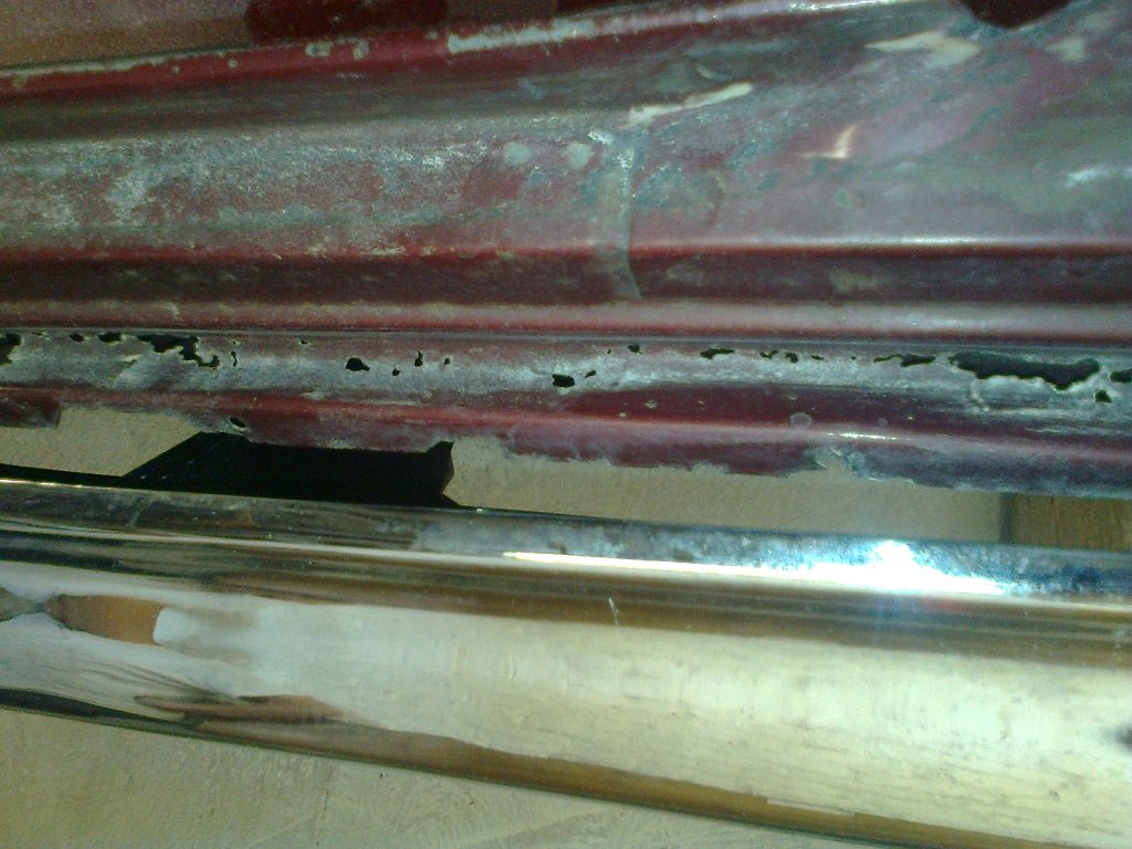

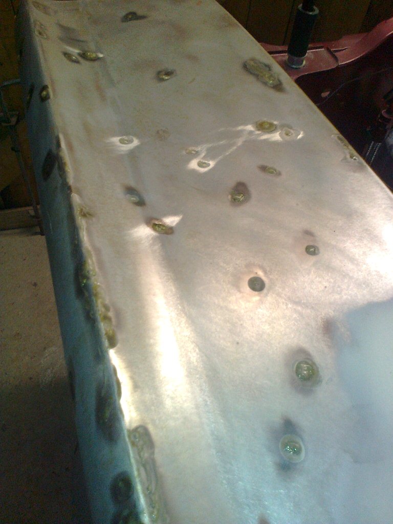

Danny has been busy for the last few days cleaning out panel gaps, channels, nooks and crannies ( do Yanks have nooks and crannies? )
He's put a couple of layers of filler on one rear 1/4 and filled all the slight imperfections, he's been grinding out & Jennoliting the little rust pits ( looks like it's got the pox!) and DA-ing panels again to shift the rust haze that's appeared since the wedding.

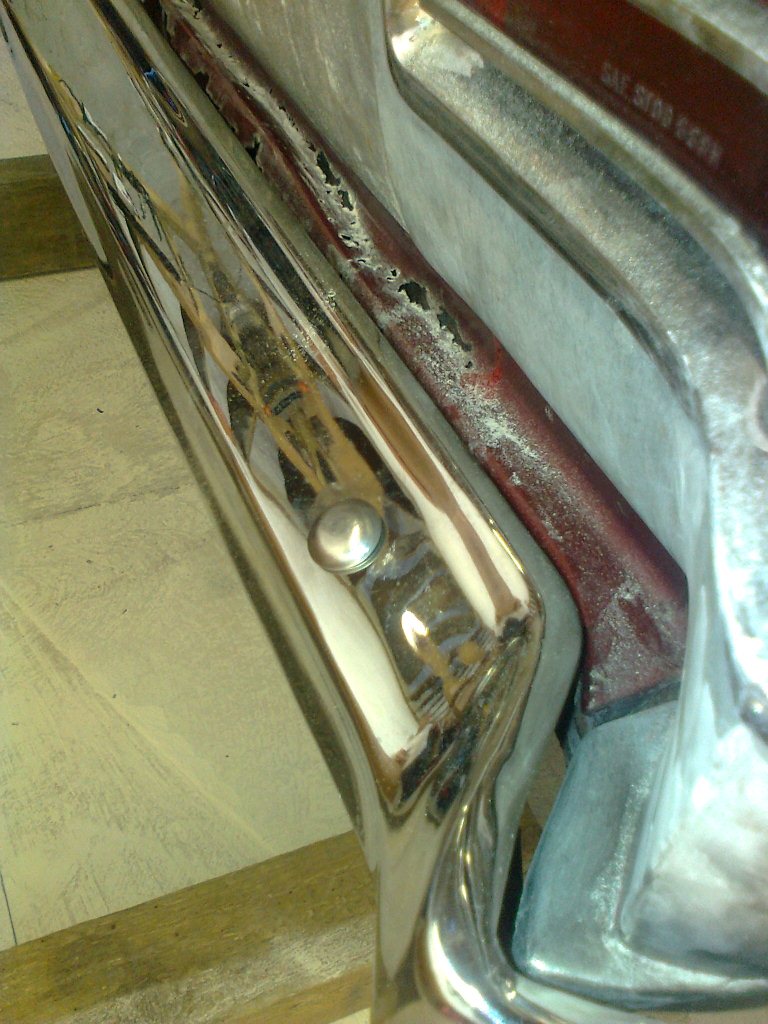

Not sure about the little filler panel behind the rear bumper. It looks like there should be maybe a rubber strip or something? I may be able to get a sill section or something and adapt-to-fit, it's going to be a right pain to replicate and weld in without it distorting :?
Rear bumper filler 2.jpg (142.27 KiB) Viewed 1146 times
Rear bumper filler 1.jpg (157.2 KiB) Viewed 1146 times
Rust spotting 1.jpg (119.91 KiB) Viewed 1146 times
Rear quarter filled 1.jpg (115.3 KiB) Viewed 1146 times

I've dumped the ATF out now and will put EP80/90 in the gearbox once it's had a day or so to properly drain. I've ordered the smaller fitting i need to replace mt faulty BG reg with the Holley one from Mick. I've cut off the rusty rear bumper-filler panel bit. I'll just leave it off- I've trial-fitted the bumper and if you'd never know there was something missing.
