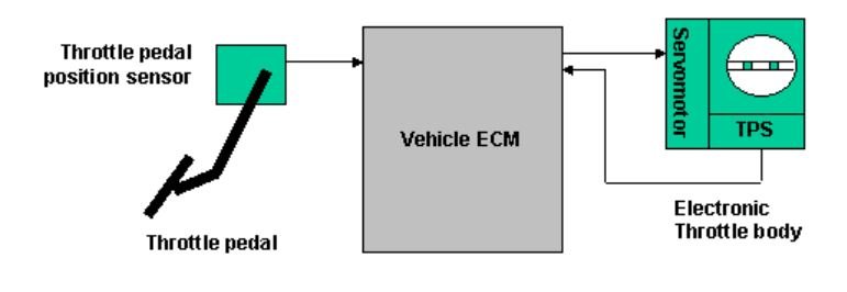

Electronic Throttle Control (Drive By Wire)
The throttle cable has almost become redundant on today’s motor vehicle. The drive-by-wire system is by no means a new concept as it was introduced by BMW on their 7 series range back in 1988.
The system BMW use is referred to as EML (German term for electronic throttle control).
"Elektronische Motorleistungsregelung"
The system has now found its way onto other vehicles with humbler routes and can be found on most modern engines. Historically a mechanical linkage between the accelerator pedal and the throttle butterfly has always existed, be it via a cable or via rods and linkages. These have now been replaced by sophisticated electronic control modules, sensors and actuators.
This system is also referred to ‘Fly-by-Wire’ / Drive By Wire /FBW/DBW

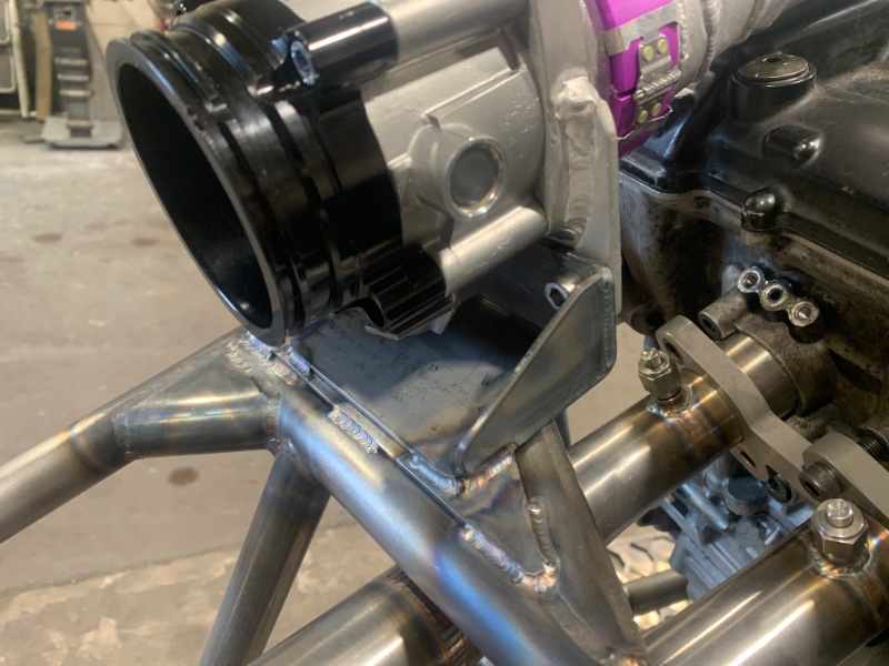

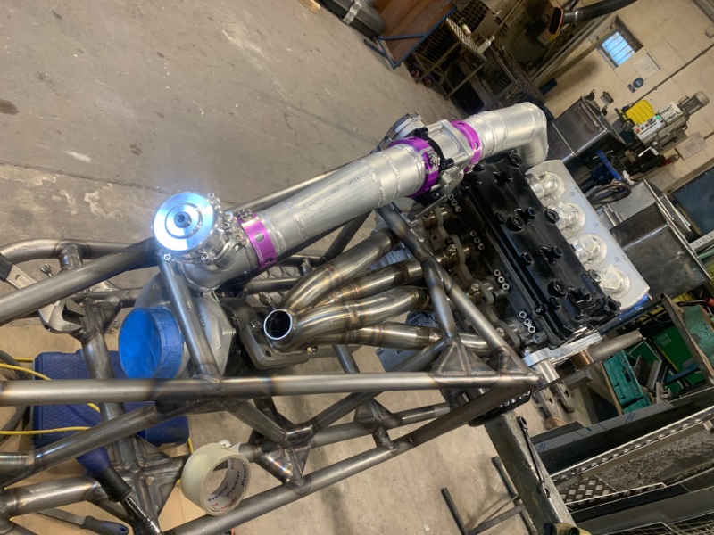

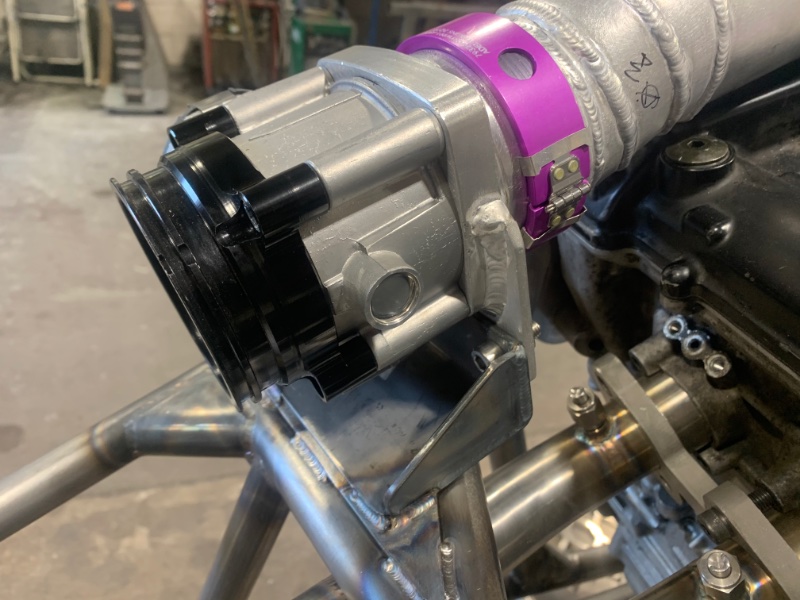

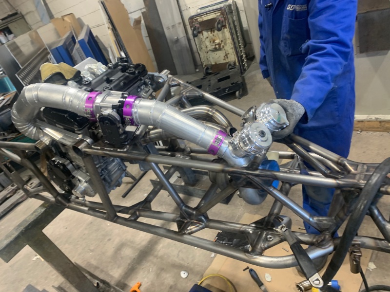

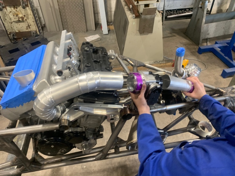

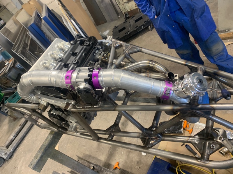

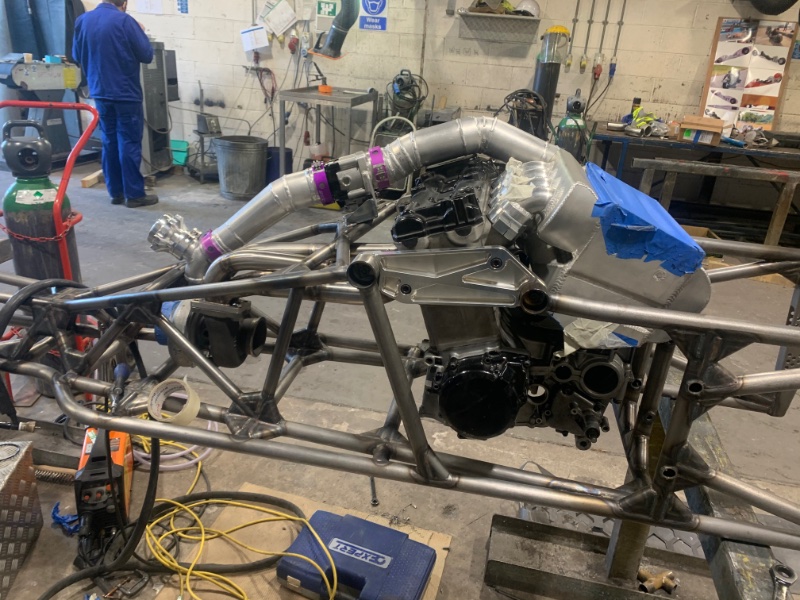

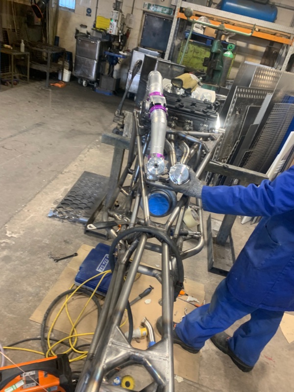

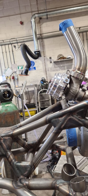

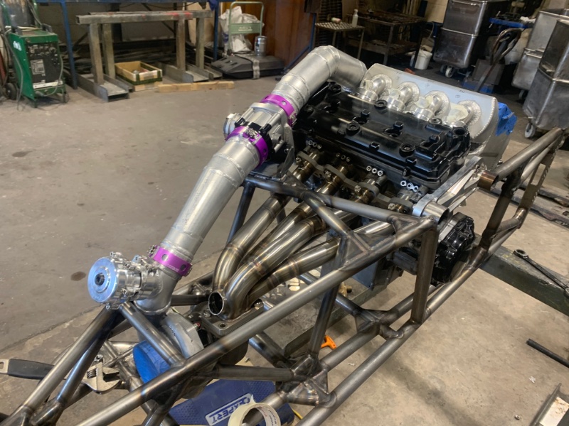

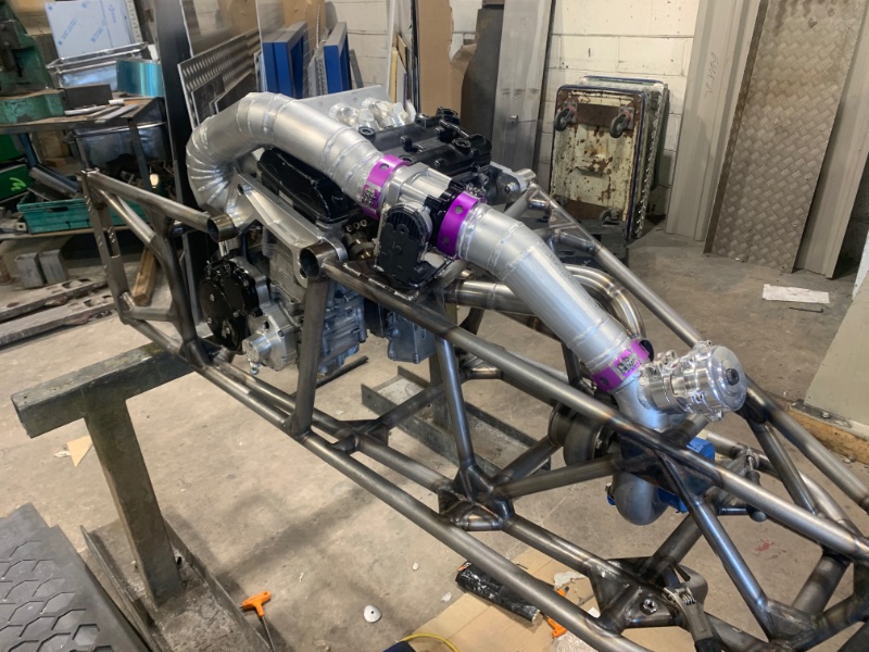

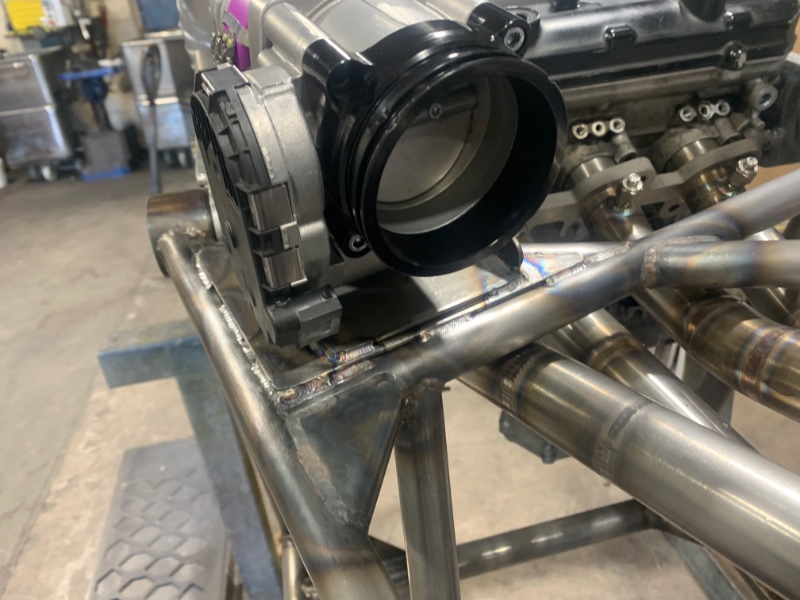

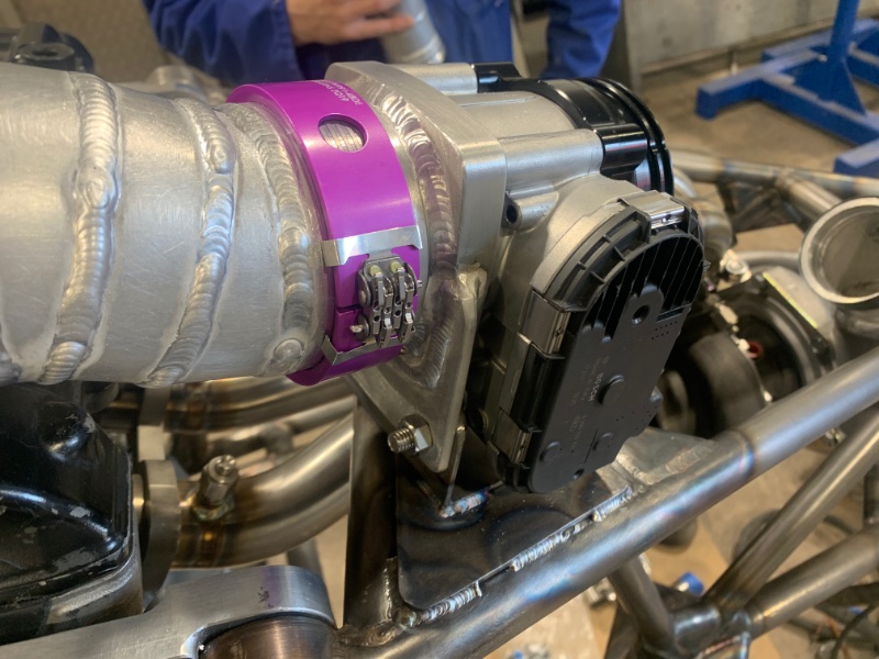

Such long throttle cables on Mk1 bike and twist-grip issues not to mention boost bending throttle blades on shut down ...
I have bite the bullet swallowed the brave pill and installed a fly by wire throttle actuator.
We connected a pipe from the turbo to the fly by wire throttle actuator and then continued to the plenum in aluminum piping.
all connections clamp are w.adelwiggins.co and allow movement.

Re: Fifty shades of Jade
This explains a lot.
I assume its playing nicely with your regular 'looney-tunes' pills ??
Keep it comin' WIll. I'm enjoying it.

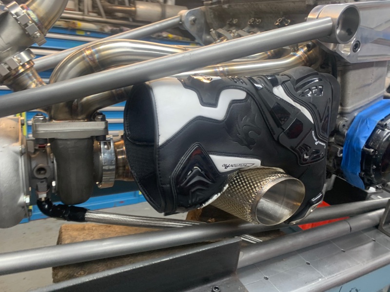

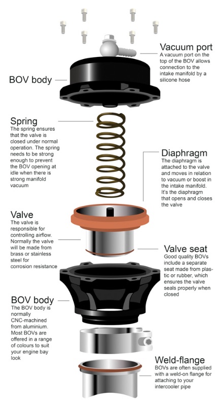

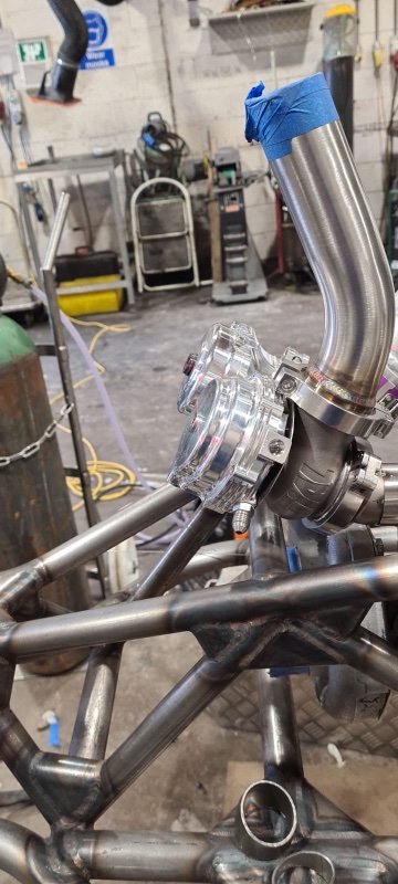

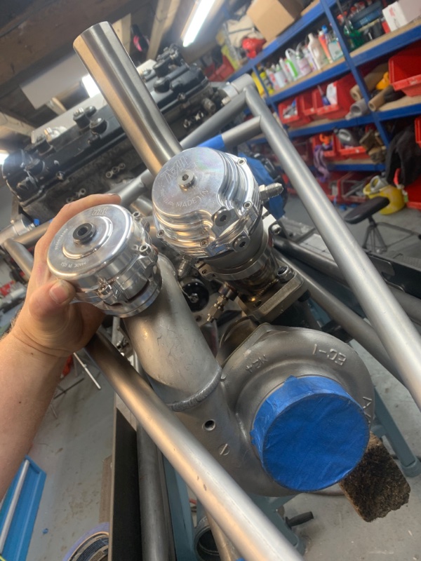

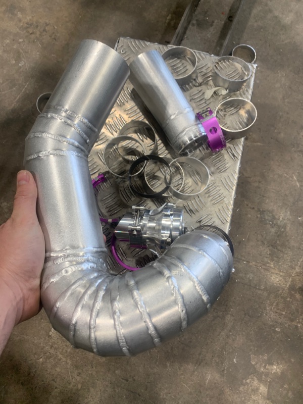

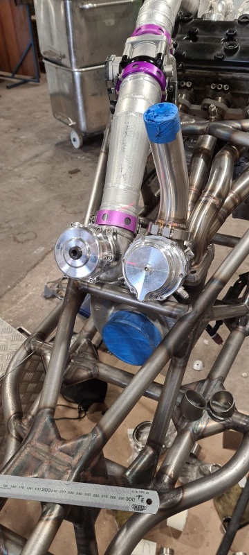

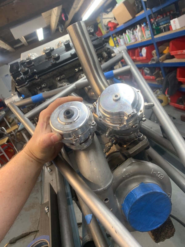

Wastegates
When a turbocharger's exhaust-driven turbine wheel spins fast enough to produce the desired level of boost, a wastegate is typically used to allow the excess exhaust pressure to divert around the turbine wheel. By opening the wastegate (typically boost-pressure referenced), exhaust pressure bypasses the turbo's turbine wheel to prevent the turbo from reaching an unsafe speed. You'll find external wastegates on the exhaust (hot) side of turbo plumbing between the turbocharger turbine wheel and the exhaust manifold—or sometimes in the exhaust manifold itself—where it can get exhaust upstream of the turbo and route it back into the exhaust downstream of the turbo or shoot it out a screamer pipe like I’m doing directly upwards
In its at-rest state, a wastegate is closed and boost pressure can be controlled by varying the pressure of the spring holding it closed. A wastegate can also work in concert with a boost controller to improve boost response by staying closed to a higher boost threshold.
Blow-Off Valves
Located on the pressurized intake (cold) side of the turbo plumbing, blow-off valves (BOVs), like wastegates, are normally closed and open to bleed off boost pressure. Their main job is to prevent the pressure in the intake tract from backing up and causing compressor surge when engine speed changes abruptly—like when the throttle closes during a shift. When a BOV is vented to atmosphere, it produces a distinctive hissing sound, and when a BOV isn't used or is of insufficient size, the compressor surges and makes a chirping or rattling sound. Compressor surge can put stress on the compressor and its bearings, shortening its life it’s also very common on turbo drag bikes to bend the throttle blades open if you snap the throttle closed to quickly
My plan is to store compressed CO2 in the frame and then computer Controlled regulate this over the wastegate and the BOV to artificially Control them.
This will allow the turbo system to do thing that wouldn’t normally be done and are very Specific to drag / LSR racing.
For example:
Spin the turbo up to full rpm and bleed off boost on the cold side and then slam the BOV shut on launch..
Diverting hot gases away from the turbo to produce less boost when less power is demanded...
Basically the system I’m building will allow me to almost control the turbo and engine boost level Completely independent of what the engine is doing and decide when and how it should be added or the engine.
Both the BOV and Waste gate are mounted
it took a while to get them perfectly symmetrical but they really look the part
Blow-Off Valves
For example:

Can't say I understand fully what you're doing but can grab the basics, I think. Nice attention to detail with the valves

Option 1
Exhaust wastegate is open and it’s a non turbo engine.
all exhaust gas is diverted away from the turbo out the screamer pipe straight up N/A
Option 2
Wastegate is closed BOV is open
All exhaust gas is forced though the turbo the turbo is spinning making boost no lag turbo is up to full speed and all boost is being released out the BOV engine sees no boost. N/A no lag
Option 3
Wastegate closed BOV closed
All exhaust gases is forced though turbo turbo is making boost BOV is closed full boost delivered into engine
And every shade and combination in between using any other variable to control it like interesting things like front suspension height or a Comparison of slip between a front and rear wheel speed ....
Option 2
Option 3
