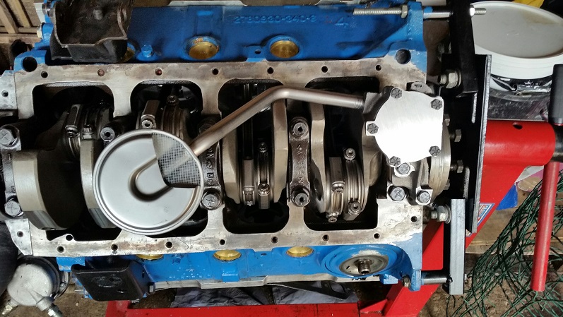

Strikes me that the pump drive may have been slightly bent or the bush in the block is worn allowing the drive to whip.

Another possibility but was same pump and drive the came out of engine and was working fine before. I can only assume the pump got damaged somehow after it was taken out, possibly got dropped or the gasket? Its all supposition and one of life's little mysteries.

A bit of scrap could have got into the pump and that strained the drive.....

What Pete says,look for damage on rotors inside :thumbright:

New pump (stock) I did not replace pump with another high volume pump, I decided to put a stock pump back in as I feel the stock pump is adequate enough for the stock oil ways. and still getting 75 psi no sloppy bearings then. Good to go.
