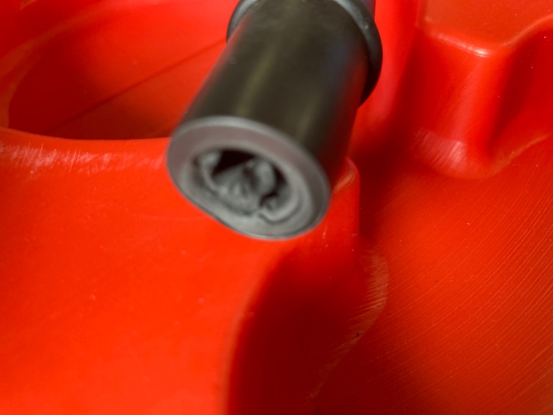

Well, seems to have cured itself after I turned it off to scratch my head, so connected the vac gauge to the manifold and got a wobbly needle, in time with the engine pretty much. Can’t post the vid here, sadly. Think I’m right that means I have a vacuum leak?
Anyway, I did learn the hard way that you should turn the engine off before you take the vacuum plug off.
Disconnected the gauge and looks like in just that few minutes the connector has melted.
I’m now concerned that the vacuum plug I have in the back will go the same way?

Shouldn’t be getting hot enough to melt rubber..
- Stu
- Posts: 7201
Unless I tatered it trying to get it on there.
It was a chuffing tight fit, to say the least.

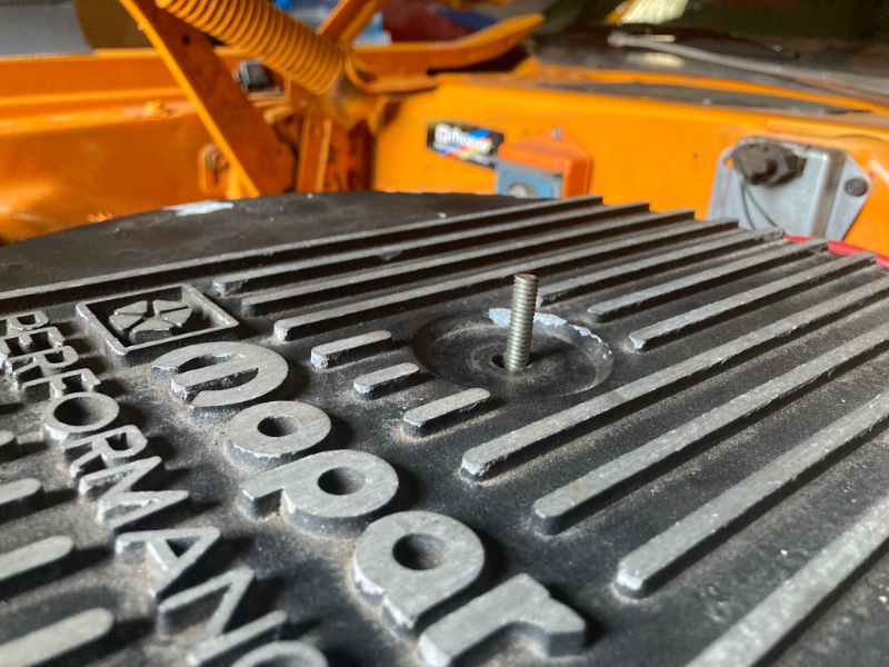

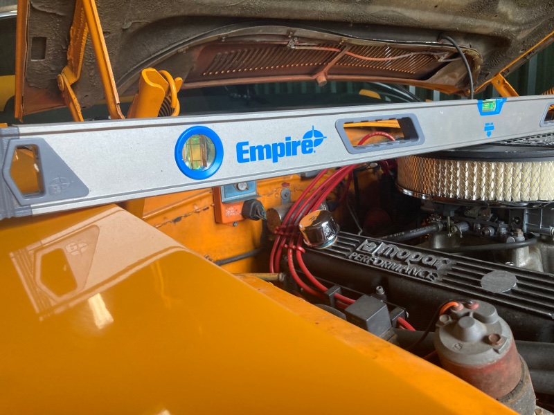

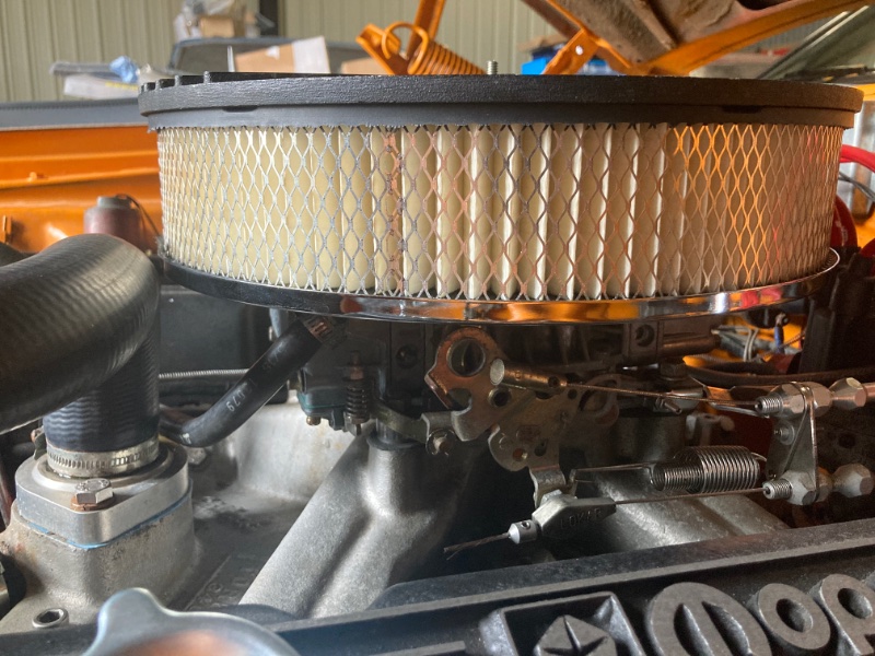

Finally found a drop filter base the right size and much happier now, that’s given me an extra 3/4” and who wouldn’t be pleased with that.
On to the rear end again now, todays job is to refit the lights. Got replacement studs and sorted the gaskets out, so once I know they are all straight, I can figure out how much more adjustment is needed on the bumper and light surround. Also finally got the correct fittings for the rear valance, so fingers crossed should all sit better by tonight.
Only head scratcher for now is, the throttle bracket was stuck solid this morning when I came to adjust the lockdown. No idea why.

i've had throttle linkage/brackets catch on drop base air filters before. also check the bracketry on the other side of the carb as i've also had that catch on the inlet manifold, carb gaskets and/or spacers before requiring a bit of filing where there's interference.

No, wasn’t anything to do with that, it was when I first got the bonnet up, took the filter and base off and the throttle wouldn’t move by hand, no base on at all. Went and pressed the pedal and it cleared it and now moves perfectly freely, no idea what caused it.

check there's no interference between the carb linkage/levers and the manifold itself or the carb gasket. both sides of the carb not just the throttle cable side, i've had 'jamming' on the other side before sticking the throttle wide open.

Doesn’t appear to be anything. Just seized for no apparent reason. No binding at all or hing of sticking as soon as it was free. Almost like when you had a car sat for ages and the brakes stick, but free up as soon as you go, if you know what I mean.

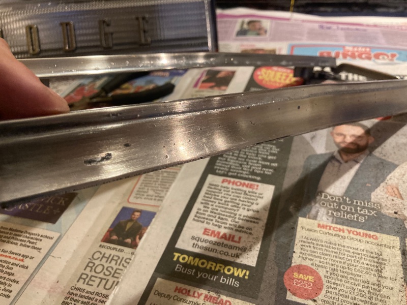

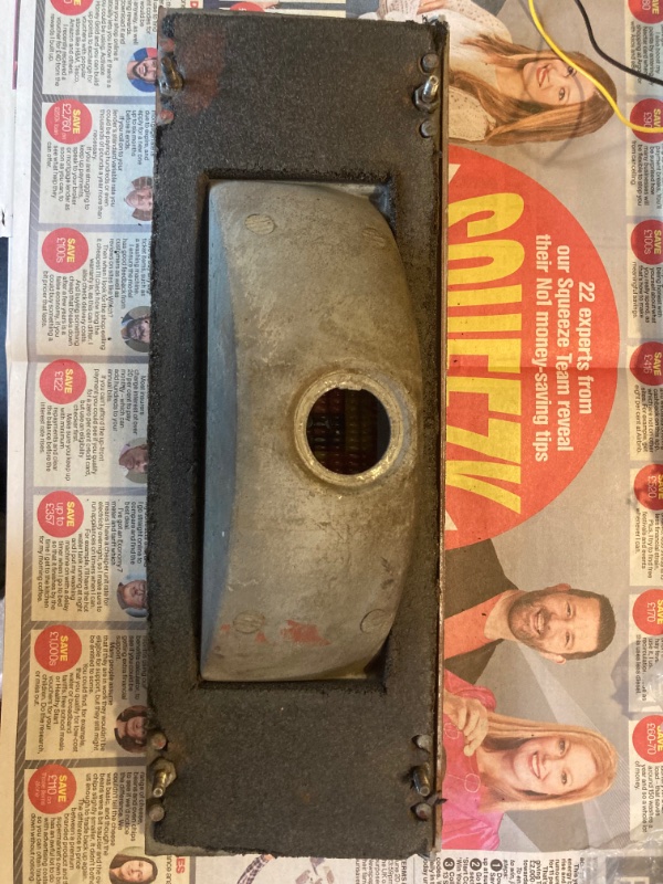

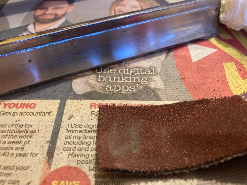

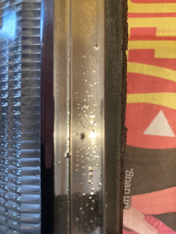

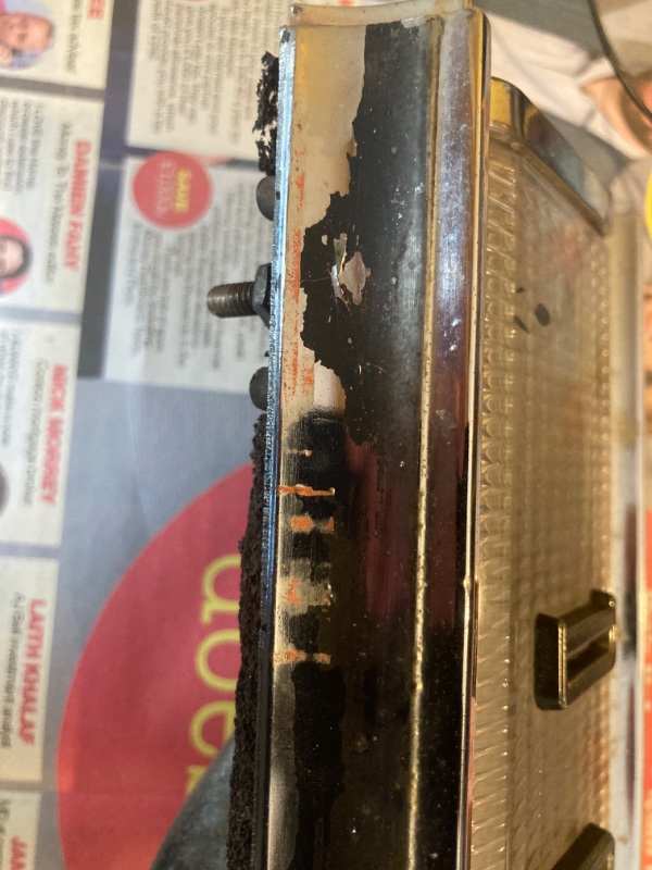

Anyway, turned my attentions to the rear end again and pulled the bumper and lights. I’ve finally managed to track down some of the chrome paint I wanted, so set about cleaning the lights and seeing how well the surrounds will come up. Centre lens has come up great and managed to sand out the blemish that’s been getting on my tits for ages. Happy with the slight patina on the lettering, so that’s done. Gasket was glued on like, well, glue! Finally got that cleaned up and have good replacements, so all that remains are the surrounds.
They are in a right state and badly pitted, but didn’t want to attack them with power tools, so settled at the kitchen table with some emery board and set about them.
How wrong I was. Thought the issue would be not sanding them to dust, but turns out they are hard as nails and the pitting takes shed loads of elbow grease and barely touches the finish. Not easy with the onset of arthritis, so may resort to power tools after all.
Still, much smoother than it was, so looks like it’s just a case of a few evenings hard sanding and should be ready to spray at the weekend. Small steps.
Some before and afters below. Nowhere near finished sanding yet.
