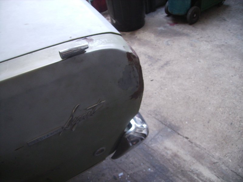

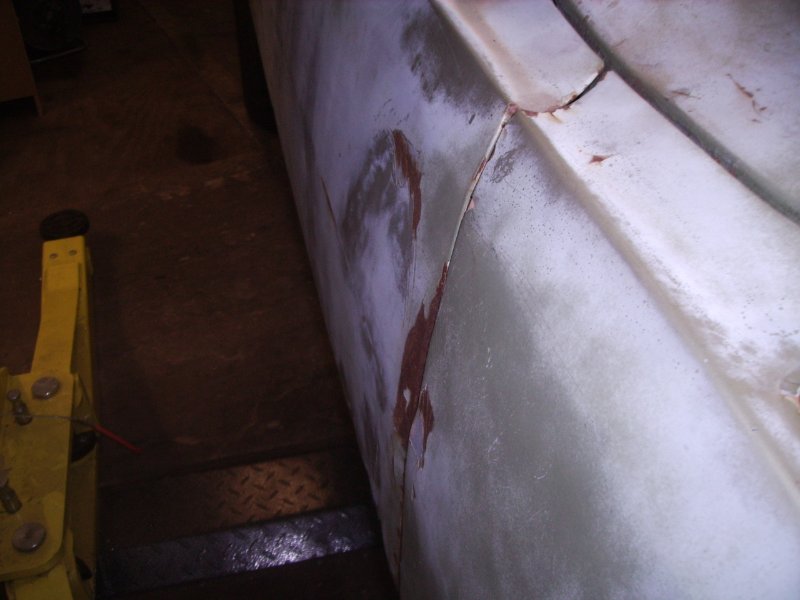

once i got fed up with that for today i took the pass' side front wheel off as the dent on the wing was bugging me. as i'm not painting it yet/ever? i needed to make it better. it's not like i haven't got a perfect panel to replace it with, just that the paint/patina wouldn't match with a white wing and door. yes i also popped the most out of the dent in the pass' side door too when i fitted the black door panels and armrests the other day. lastly as it actually fits now i installed the nos headlight bezel i've had for about 3 years, then adjusted the bonnet too.

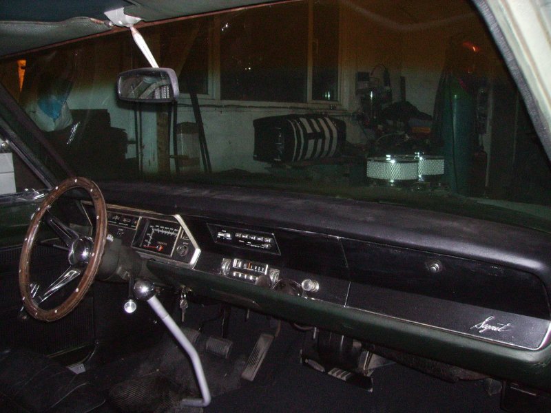

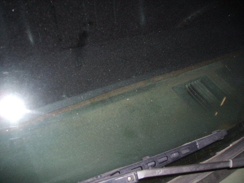

the velcro arrived today. so i first cleaned inside the new cap/skin and the old cracked dash with brake cleaner, then stuck the 2" velcro along the top and bottom edges and the 3/4" along the leading edge. that last bit was a mistake as the extra thickness hasn't allowed it to go on as far so there's a 3/16" edge of the old dash showing on the front when you look through the screen. it looks fine inside but i will take it off and remove that narrow strip as i'm confident it'll go on just enough to fully cover the old part as it did when first offered up. the good thing is i 'can' take it back off as it's held with velcro :thumbright:
all in all i'm very happy with it as it (for now) finishes the interior to a respectable standard for a driver.
