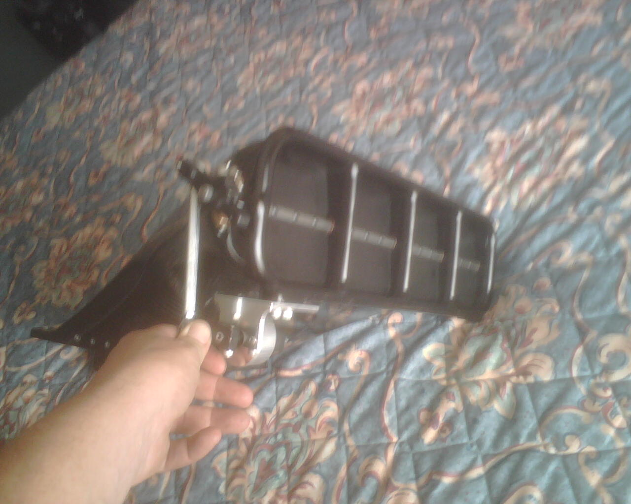

Throttle Position Sensors (TPS) but as you say Pete a potentiometer, mine works on 0-5v, zero being off throttle and is postioned on the throttle/blades linkage.Pete wrote:For throttle I think you would need a potentiometer either fixed to the pedal, or more likely the throttle linkage somehow.
Bit off a poor photo I afraid
- IMG00015.jpg (132.15 KiB) Viewed 1006 times

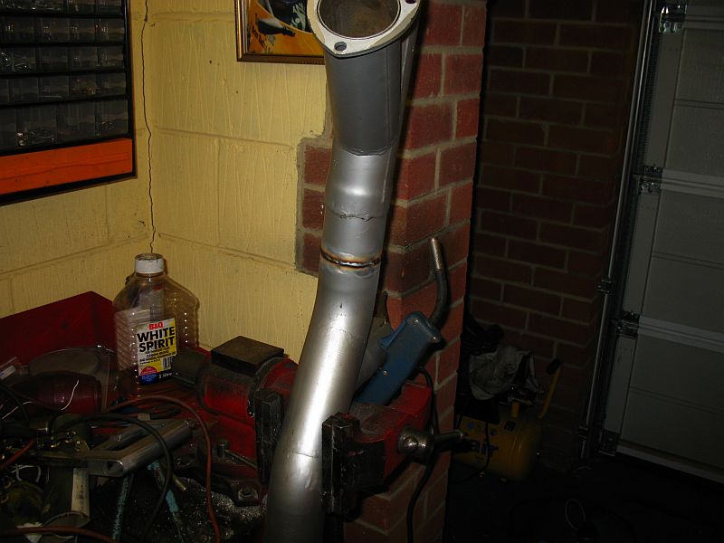

Back in the garage at long last.
At the same tme as welding in a exhaust bung for the wideband oxygen sensor I also wanted to correct the angle of one of my exhaust cut-outs.
When I made the exhaust I accidently welded one pointing a bit lower than the other. So I just wanted to cut that section out and turn it up slightly. I have little ground clearance as it is and even 3/4-inch more is better. I just have to weld back the pipe from the cut-out to the muffler now but this is enough for today.
- There is it weded up and ready for the next section to be welded on. Maybe tomorrow.

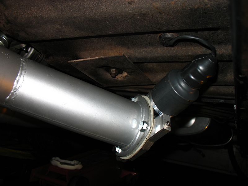

- After tacking the cut-out back on I double checked for fit this time BEFORE final welding.
- IMG_2746.jpg (62.87 KiB) Viewed 859 times

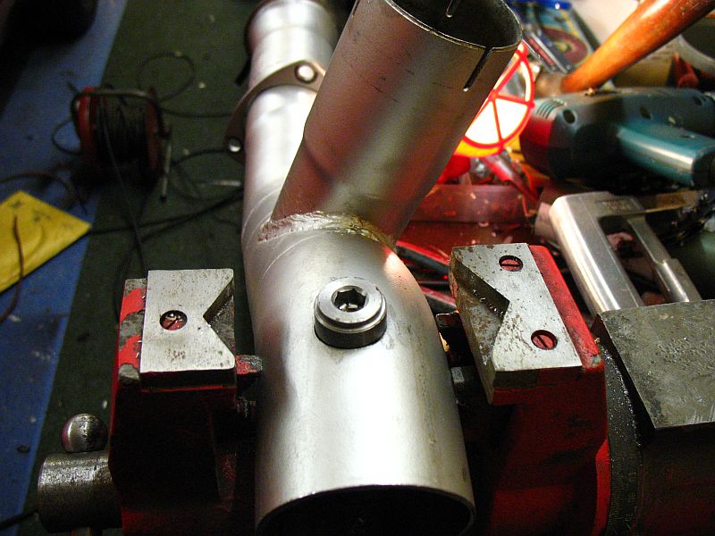

- Note the sensor sits at the 2 o'clock position to keep it away from any moisture running down the pipe. This is just past the H-Pipe behind.
- IMG_2740.jpg (69.67 KiB) Viewed 859 times

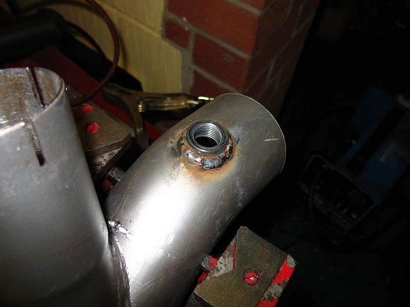

- Welded.
- IMG_2738.jpg (60.05 KiB) Viewed 859 times

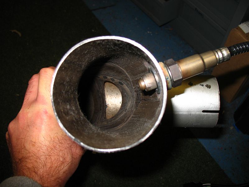

- Bung is 25mm. I cut a 24mm hole and hand filed to a tight fit. That is the H-pipe you can see there and not the cut-out.
- IMG_2726.jpg (94.62 KiB) Viewed 859 times
