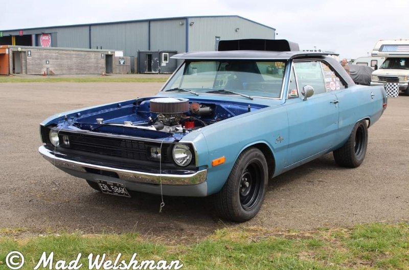

Its been a while, so thought id take some time out to update the thread on the second half of 2024.
With the refreshed gearbox, and engine all back in place I managed to get about 30 miles on it before Dragstalgia weekend arrived.
No longer tempting fate, a hired trailer is now being used to get the car to and from the track. Its a lot less stressful and means at least I can get home at a decent hour if it breaks.

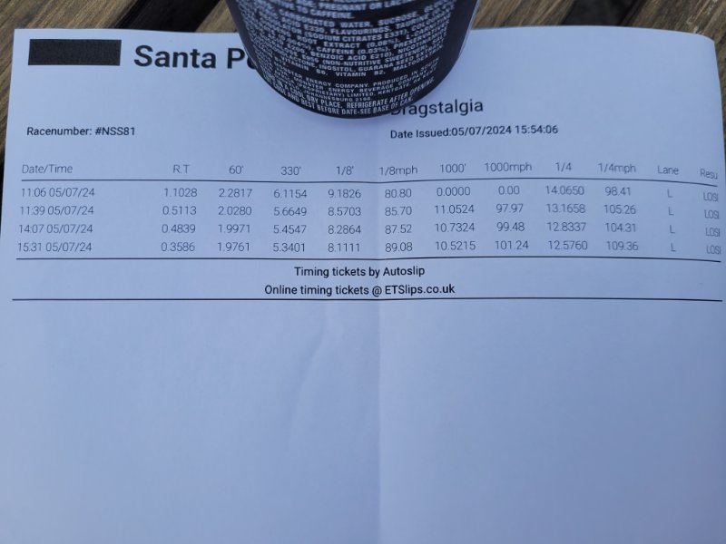

Nerves a plenty and also my first outing in the NSS class, I paid the cost for the Friday RWYB to see what I could get out of the new motor and trans.
Started steady, listening for any nasty sounds or weird handling, but soon grew in confidence as the car did its thing.
One of the downsides of the gearbox expense, was that i could not afford to do anything else but run it in street trim with road tyres and full exhaust system on.
My main aim with the car, my engine build and discussions with Jim, was always something that would run mid 12s and be happy on the street as well as the track. A true street strip setup.
Safe to say the 4th run hit the required time on testing.
Reaction times were ignored in the hunt for limits of grip and the best shift point. The above were all done at 6k shifts, but i had misfire at around 5700rpm on run 3, which after the gearbox issues had me questioning life!
Thankfully one of the NSS group, when discussing the issue, questioned the MSD limit setting and advised they have a soft limit that starts earlier than the dialled in number. Turned this up from 6000 to 6400 and that solved the issue dropping me into the mid 12s.

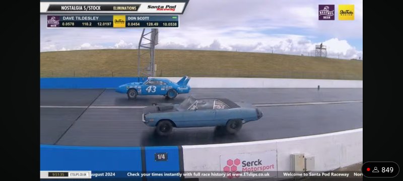

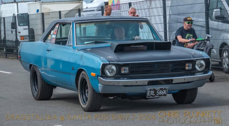

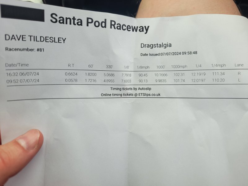

For anyone that enjoyed the delights of Dragstalgia 2024, the weather played games throughout the whole of Saturday.
Four qualifiers became one, with the Santa pod crew trying to find a dry spell for all the other classes, so I opted to go safe at 12.5 dial in.
Didn't expect the weather and cooler air would help and went and broke out drastically whilst sleeping on the light.
Was quite happy at the breakout number though, hitting 12.19 @ 111.
This put me up against Don Scott for my first ever elimination.
Nothing like starting easy......
Sunday - Cooler and overcast, plus an early start on track.
So decided that id chuck everything at it and put 12.0.
Don is significantly quicker than me so dialled in 10.05.
Safe to say I didn't embarrass myself for my first run.
The adrenaline of the race and being hunted down (I could hear him gaining on me), still makes me smile today.
I was out in E1, but didnt care one bit.
The car ran faster than I'd hoped for and it was still in one piece at the end. That's a weekend win after years of pulling my vision into reality, with various little bumps along the way!
Only one problem really. 12.01 is very close to an 11................. :twisted:
