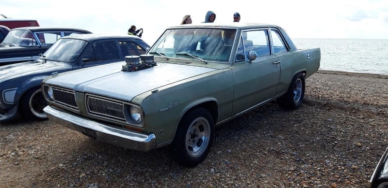

here's a couple of pics the meet photographer took last night

Posted: Mon Oct 04, 21 8:38 am
Spotted on Facebook 8-)
