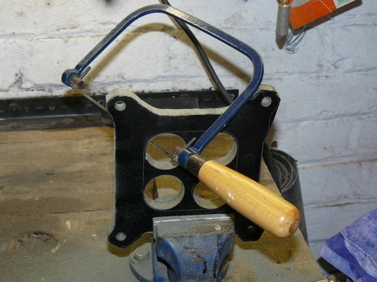

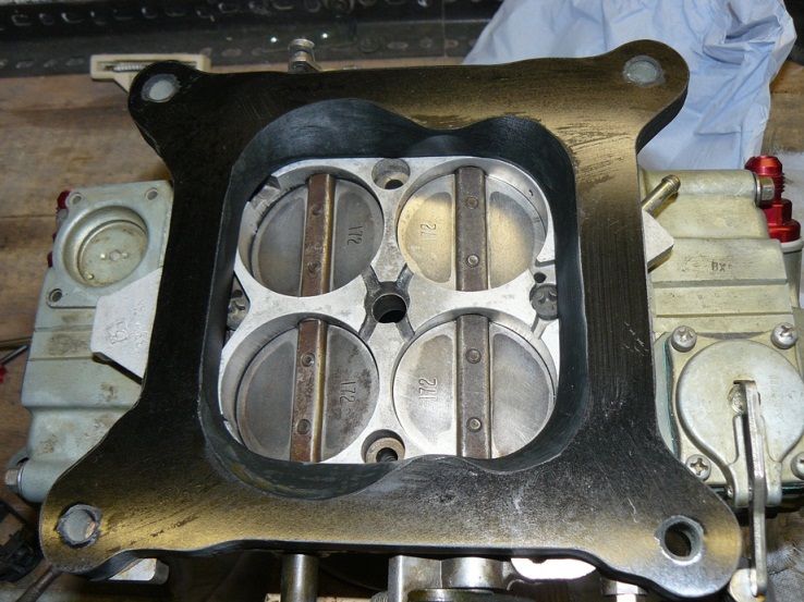

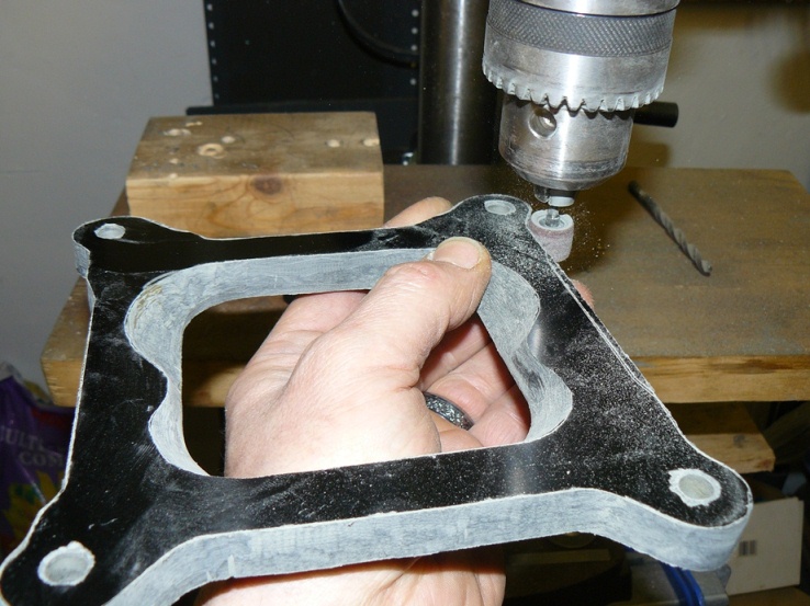

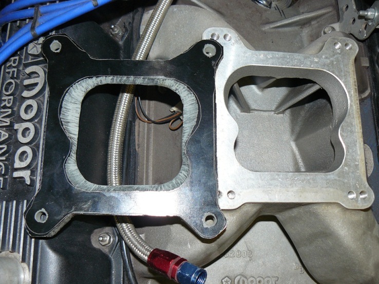

I was unhappy with the difference between the carb and the shape of the inlet mouth, so I made my own gas-flowed phenolic carb spacer. I also like the idea of a bit of heat insulation!
I paid £8 for a 1/2" thick chunk off ebag, roughed it out with a fretsaw then got the Dremmel on it for an hour or so til it packed in then stuck the little sanding drum in my pillar drill. Sorted :D

Very nice Paul.......What was the issue with the metal spacer, did it have a lip or just not give a 100% free run of air to the inlet?
Could you not of worked on the metal?
Just interested in why you went this route?
So when you gona do a production run.............. :D
Posts: 8368
Well I was making the spacer anyway then I realised the mouth of the inlet was way bigger than the carb. I can't shrink the inlet or make the carb bigger so I used the spacer to blend between the two shapes as best I could.
I will take the manifold off at some point and clean up the inside a bit.
