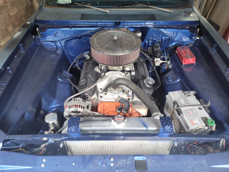

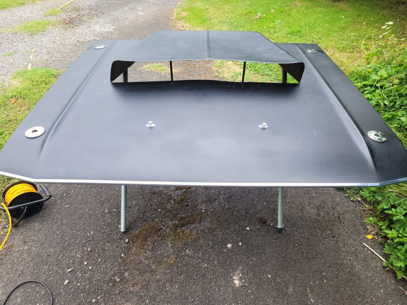

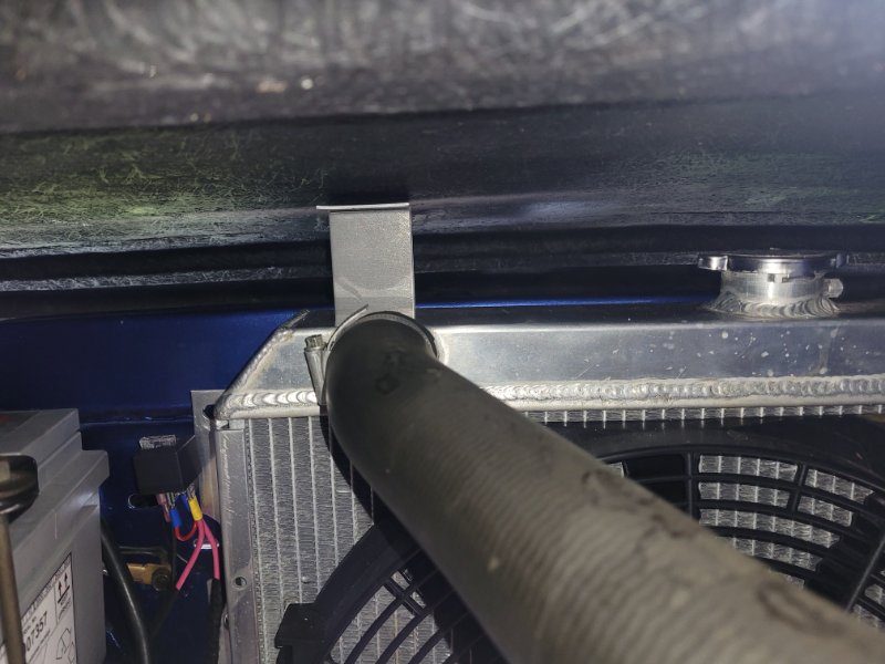

The car didn't really need anything, but I had seen one issue over the Dragstalgia event.
Going from 15.23 @ 87.86 to 12.1s at 111mph highlighted that the hood was rather enthusiastically trying to remove itself at the 1/4 mile line.

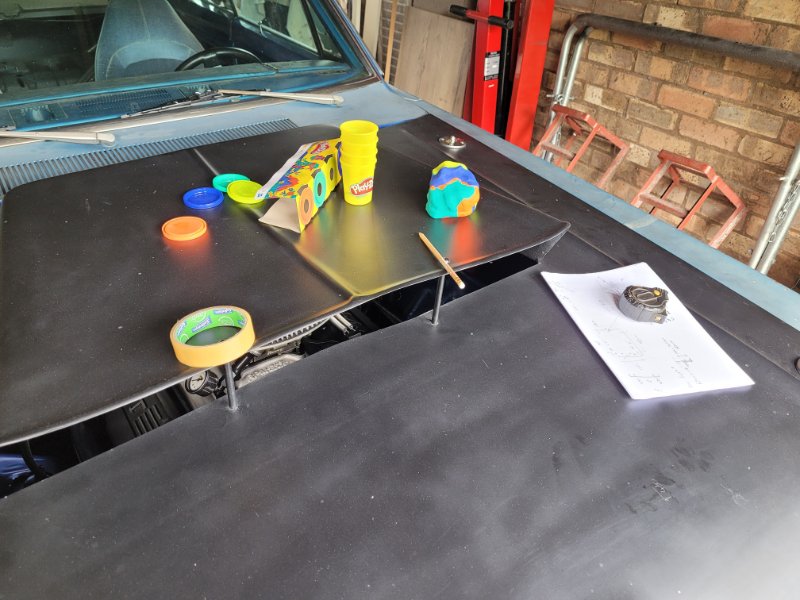

Not wanting to break it, or even worse, drop it into the path of an oncoming car, I set about securing it with some additional Dzus fittings.

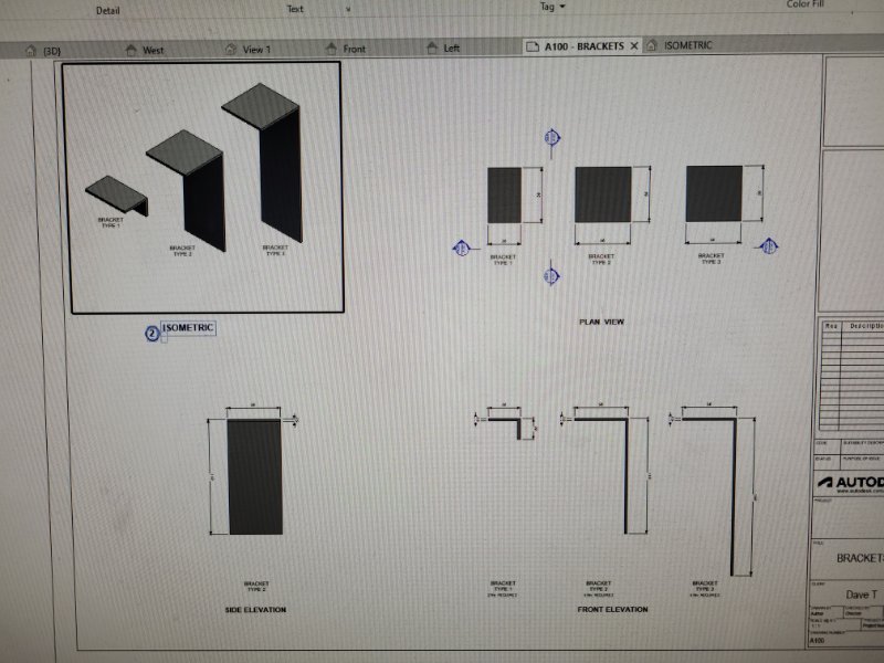

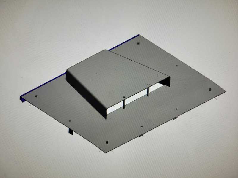

So £5 on playdoe, a tape measure, paper and an hour or so in the garage, then 30 mins on computer.
This let me work out the bracket shapes and lengths for the three additional mounting points, so i could get them cut and bent and delivered for installation.
Add the silly cost for anything Dzus, and the simple safety addition ended up costing well over £150.

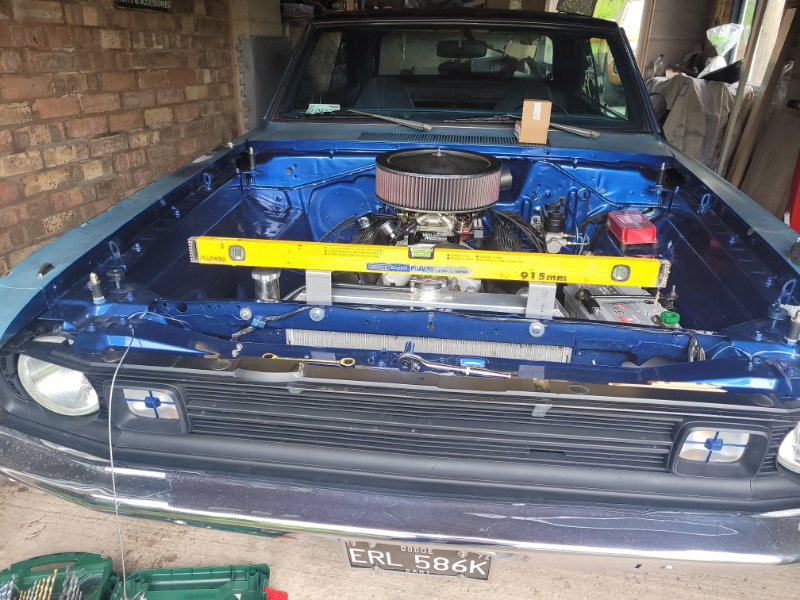

Front end being levelled:
Hood modified:
Last checks and paint to match the rest:

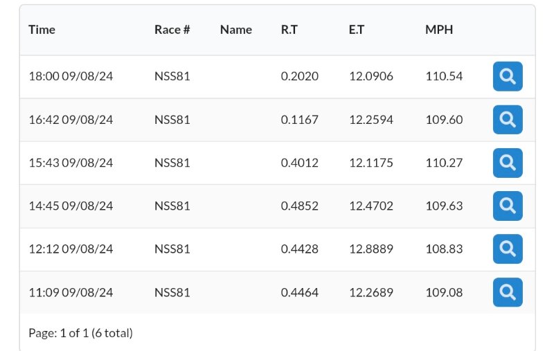

Screenshot_20250107_214237_Samsung Internet.jpg (43.55 KiB) Viewed 22063 times

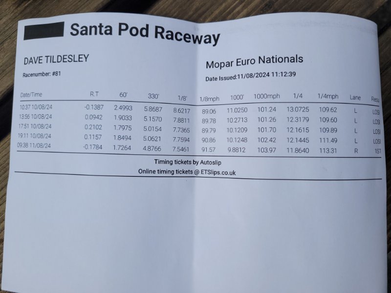

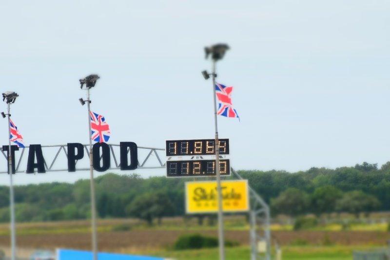

I didn't even bother to check the slip until most of the racers were back, when someone mentioned I should check my time.
11.86 @ 113MPH
So despair turns to me jumping round like a kid at Christmas and not caring that two races = two E1 eliminations in the history books.

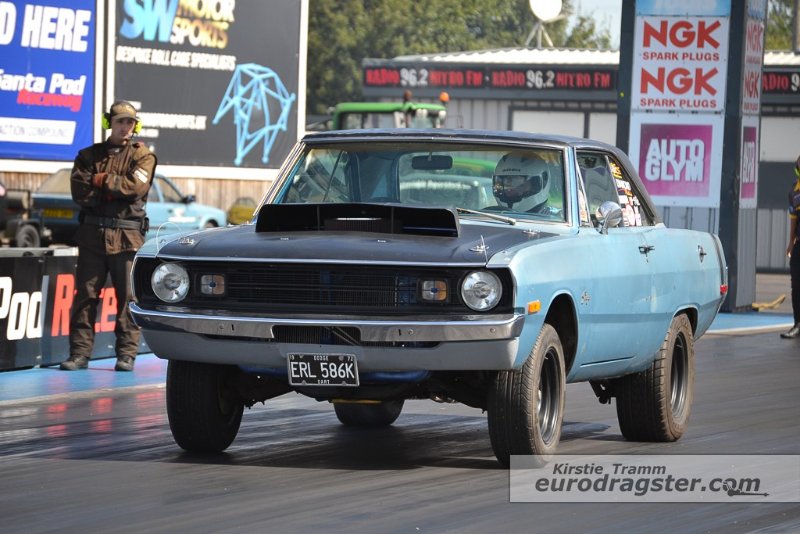

Re: Dave's 72 Dart

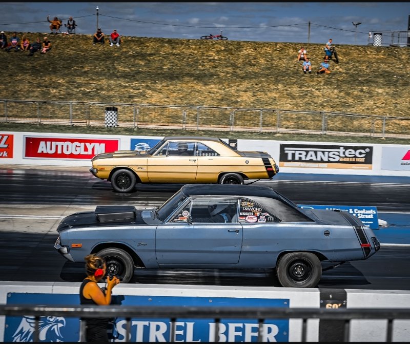

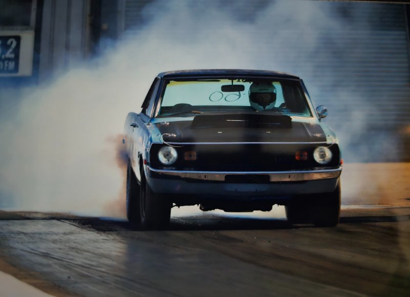

Only action shot of the weekend.
Posts: 2363
Re: Dave's 72 Dart
nice photo Dave and yes you are moving the right way :thumbright: keep it up =D> =D> =D>
