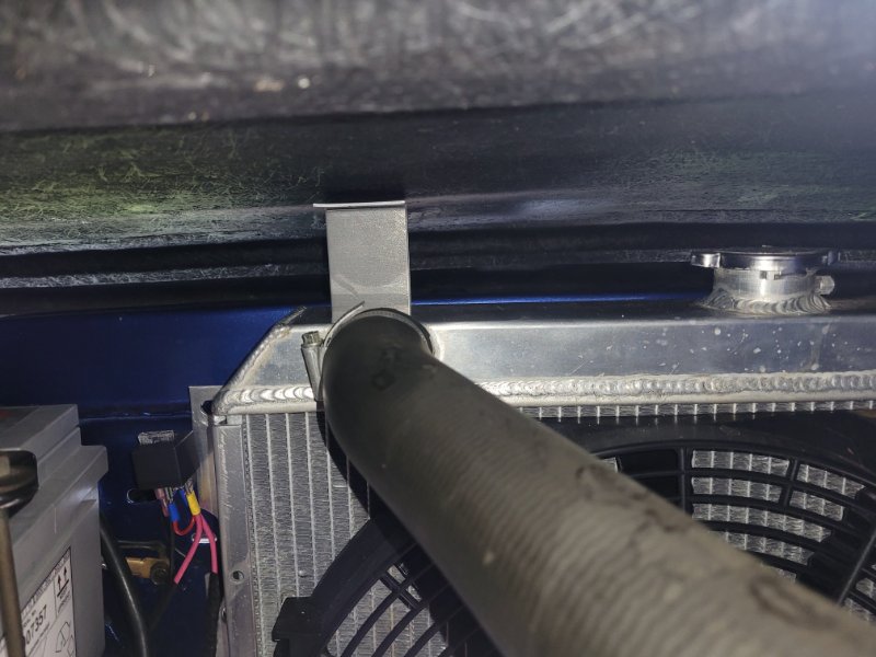

The car didn't really need anything, but I had seen one issue over the Dragstalgia event.
Going from 15.23 @ 87.86 to 12.1s at 111mph highlighted that the hood was rather enthusiastically trying to remove itself at the 1/4 mile line.
Not wanting to break it, or even worse, drop it into the path of an oncoming car, I set about securing it with some additional Dzus fittings.

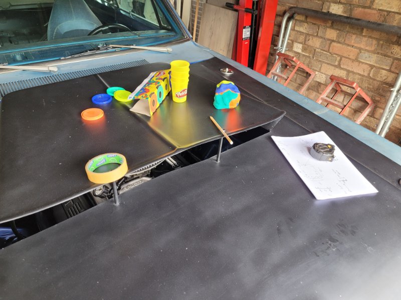

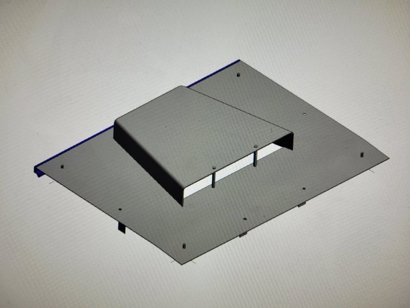

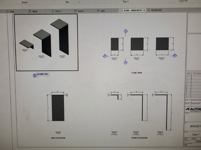

So £5 on playdoe, a tape measure, paper and an hour or so in the garage, then 30 mins on computer.
This let me work out the bracket shapes and lengths for the three additional mounting points, so i could get them cut and bent and delivered for installation.
Add the silly cost for anything Dzus, and the simple safety addition ended up costing well over £150.

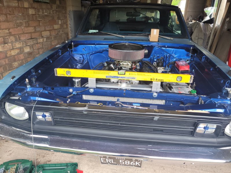

Front end being levelled:

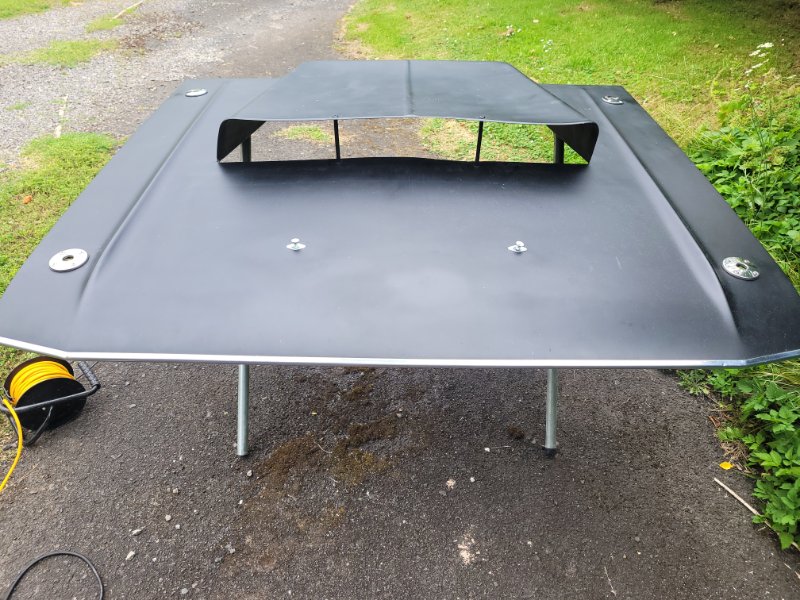

Hood modified:

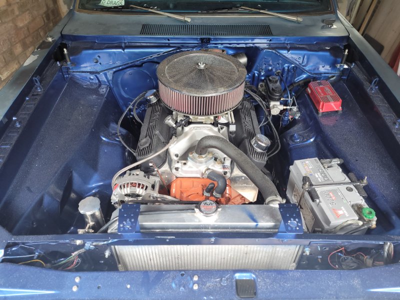

Last checks and paint to match the rest:
Overspray has been removed.... #-o

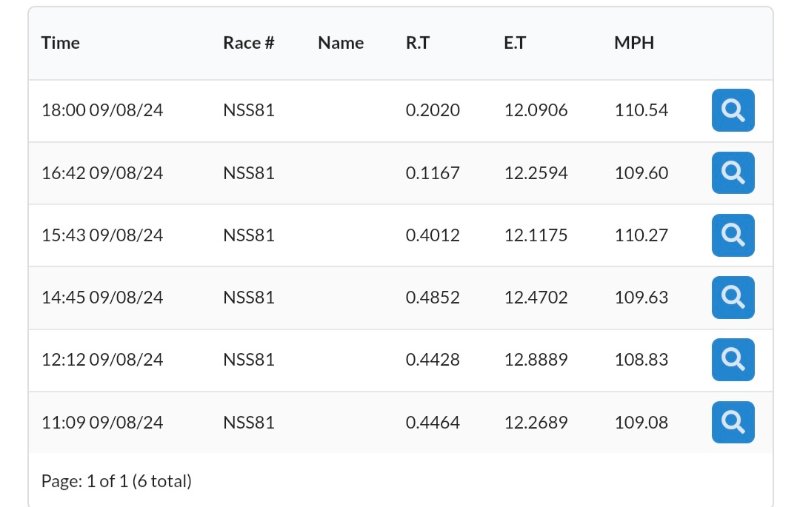

So, I ran 6 runs at RWYB on the Friday with times all over the shop and no PBs. Just a good time and beer at the end of it!

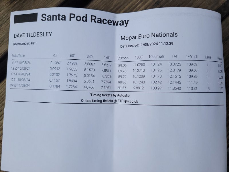

One thing I forgot to add, is that in my one qualifier at Dragstalgia, for some unknown reason, my right arm pulled back and I short shifted. Not something my mind asked it to do, it just autopiloted.
This however had me question my shift point of 6000rpm. So I dropped it to 5800 against Don. It obviously worked so during the RWYB above I messed around at 100RPM intervals 5700-5800 is where its at apparently.
Saturday was Qualifiers.
Trying to work my dial in based on my own inconsistency was fun. Shift point was set at 5800 following the above.
Run three was the one though, as i'd hovered around the 12.1, I opted to drop it to 12.5 to see if I could better my previous 12.31. Moons aligned and 12.1615 was the chosen number.
Sunday - Early E1 with a much cooler temp and tail wind
E1 was against Glynn Boardman, another low 10 second car.
So I put 12.1 as a guess based on my Saturday performance and cooler air.
It was all over .178 before it began.
Yes, got a little overexcited and decided rather than leave .2 seconds late I would leave a day early on the tree......Cherry.
Bananarama! off and mad at myself I left the line and just ran the car as normal.
Back on the trailer before 10am and all my own doing this time.
I didn't even bother to check the slip until most of the racers were back, when someone mentioned I should check my time.
11.86 @ 113MPH
So despair turns to me jumping round like a kid at Christmas and not caring that two races = two E1 eliminations in the history books.
