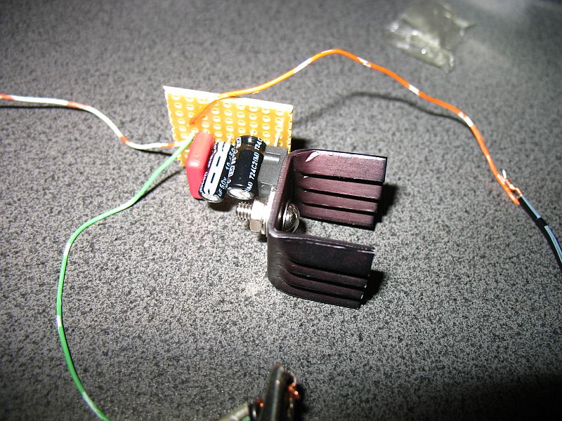

Better not seal it up in anything just yet as I might need to make another one to run alongside it depending on what I hook up to it. This thing will only run 1.5 amps without getting too hot.

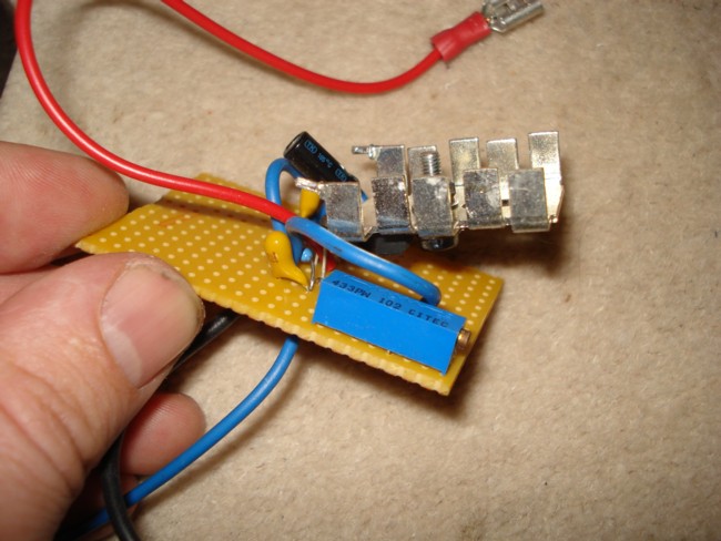

MetalChuckKey
Nah, the original and best, here's my 5v regulator I built a few months agoDave wrote:There is probably a better product to use these days for all I know but that is what I used to use in the late 70s to mid 80s which was the last time I made anything like this.
- vero.JPG (89.53 KiB) Viewed 740 times

Still can't get this vacuum sensor to work though.
I seem to have 5v on the output of the sensor which if it was working would mean 1 Bar negative pressure.
I hope I have the wires into the sensor right.
Green +5v.
Grey common.
Black signal voltage.
I have tried connecting the wires up differently to see if it will work at all but still nothing.
Driving me up the wall this is. I wish I knew more about modern car electronics.
Green +5v.
Grey common.
whats the code number of your MAP senser?
should be able to find a product sheet
is it a
Freescale MPX4250AP ?? i.e motorola
http://alpha.octopart.com/Freescale_Sem ... 4250AP.pdf
dave
is it a
dave

I was thinking of mounting it where the ballast resistor is because I don't need a ballast resistor any more and it will require just a short(ish) length of hose to run to the carb base. The 5v regulator I will mount either under the dash somewhere or behind my electrical board where the battery used to be. I have not decided yet. I only have to worry about losses in the cable from the sensor to the LM-1 meter.Dave999 wrote:if you find a nice bulkhead connector for taking your MAP signal from the manifold through to your box of electroniccy bits let me know
I think I might pinch the TPS sensor off the Neon at the weekend and see if I can figure out how to mount a couple to my carbs.
At the end of the day, even if I get non of these sensors working, I will still be able to record air/fuel and rpm. The aim is to adjust the center carb for good mileage. With the outboards tuned for max power. I have tried to do that anyway. But probably not as well as this system will allow me to.
