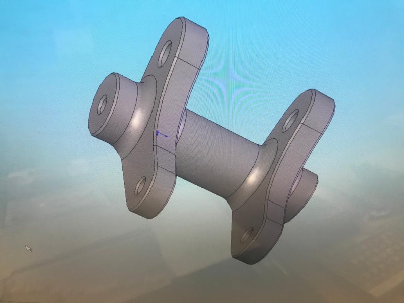

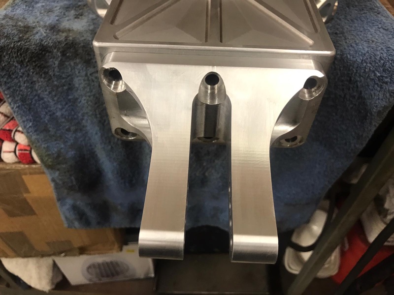

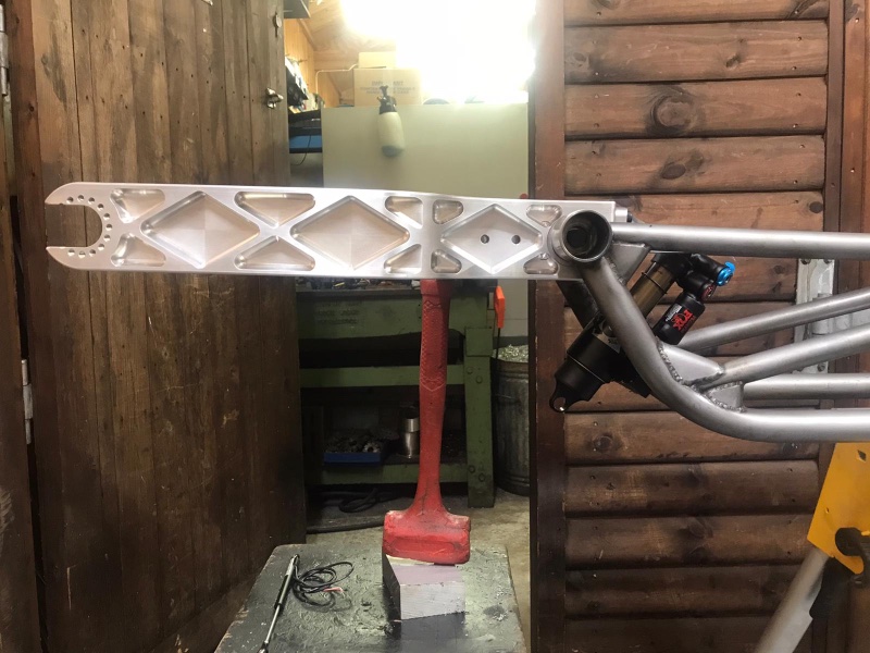

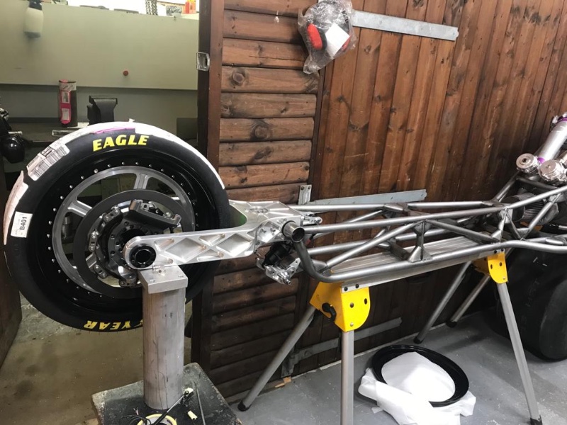

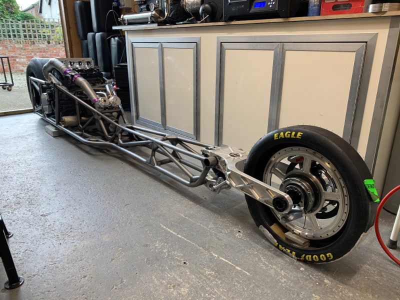

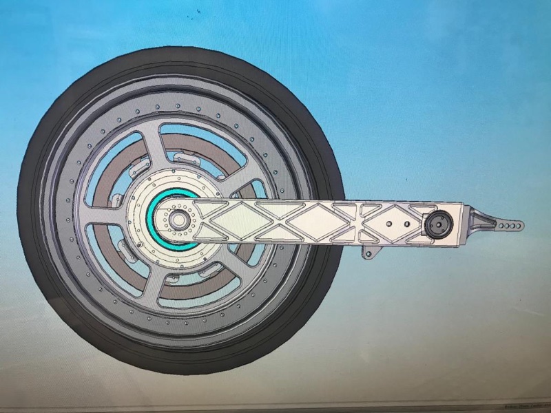

mygasser wrote: Thu Oct 29, 20 7:07 pm as above very nice work as always :thumbright: are the multiple mounting holes in the swingarm where the axle mounts to allow for some castor adjustment?
Correct !
:trophy: :trophy:

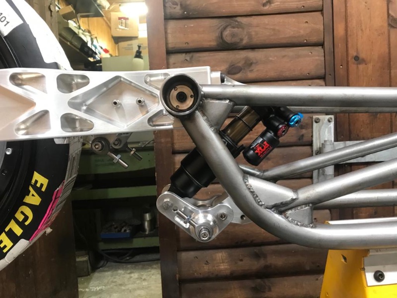

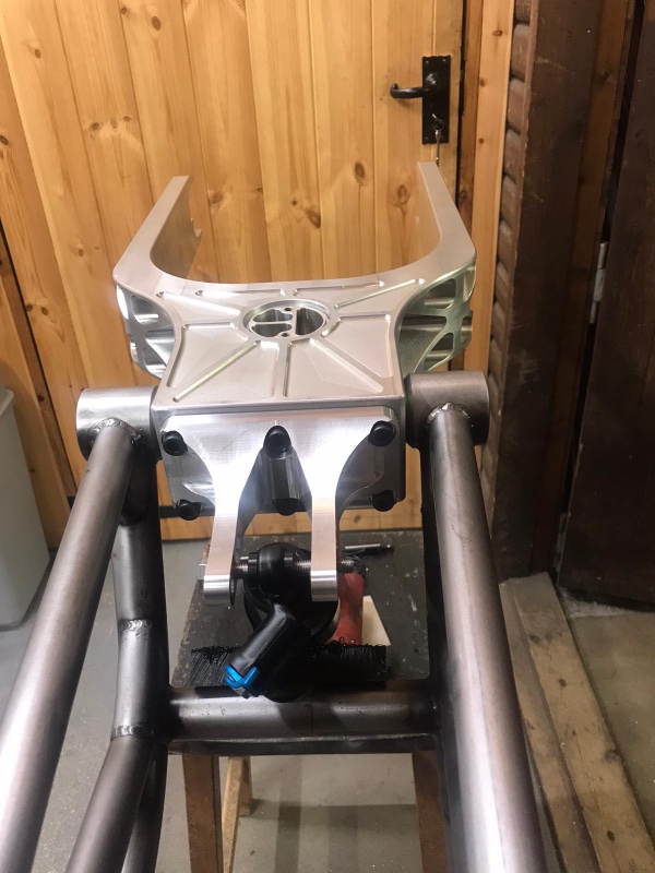

So next up front suspension and let’s think outside the box
#-o :read2: :) =P~ ;) :( :? 8-) :lol: :read2: 8-) #-o :!: #-o :lol: =D> :read2: :shock: :thumbright:

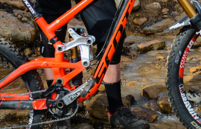

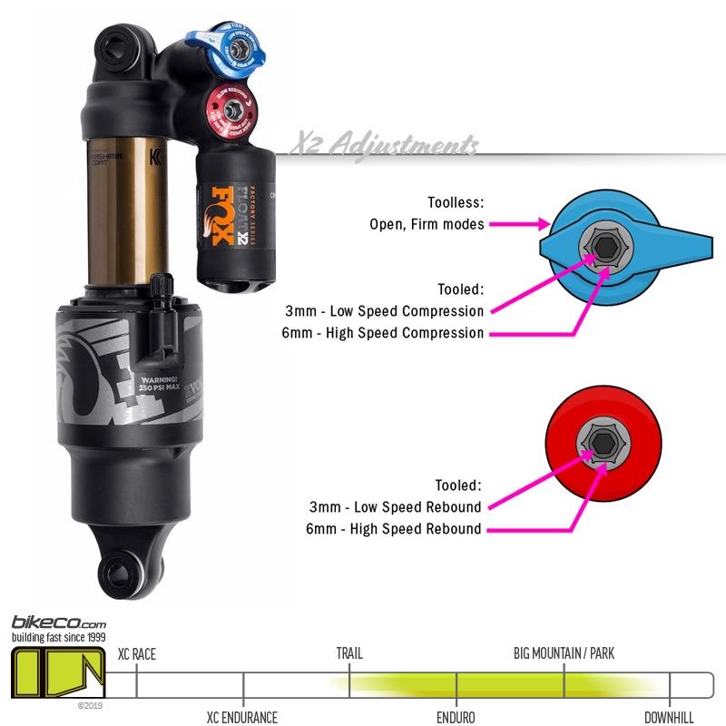

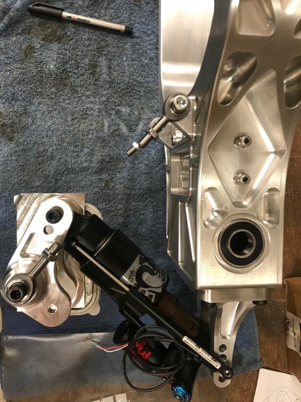

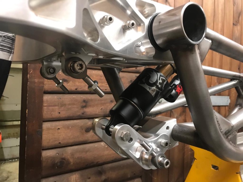

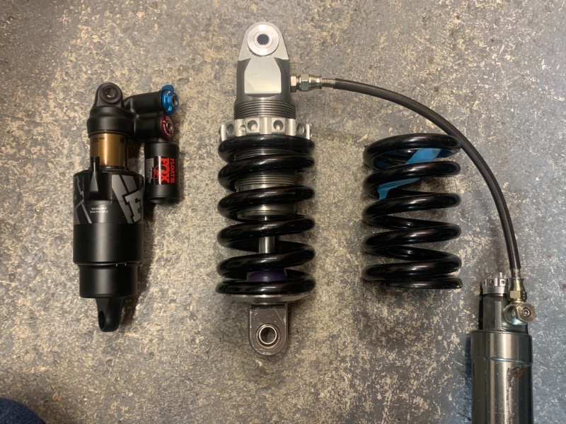

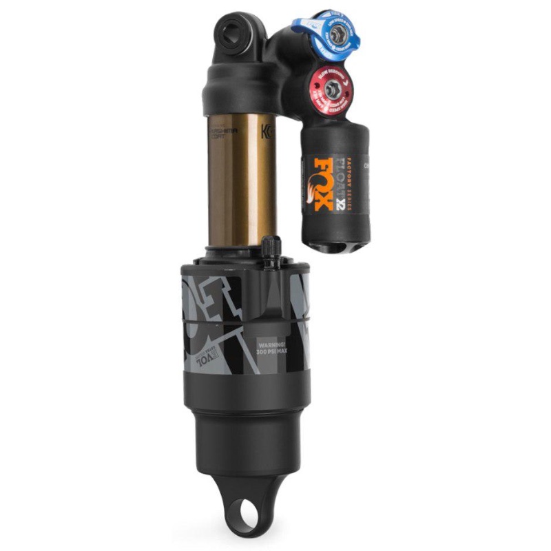

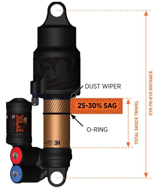

For the bike front suspension we will be using a rear air shock from a high down hill mountain bike
:reindeer:
Re: Fifty shades of Jade
This unit weights in at 637g !!! compared to last season more traditional motorcycle shock absorber 4.7kg
:shock:

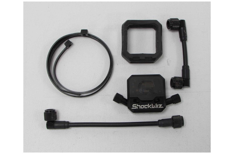

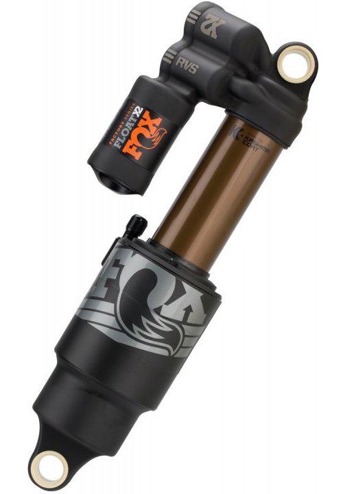

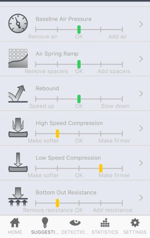

The unit is an air shock which you pump up to the desired pressure circa 250psi
Thanks to the popularity’s of mountain biking the unit comes with a Bluetooth box and phone app.
Monitoring Motion and Internal pressure the app can helps you tune you suspension via the app
:read2:

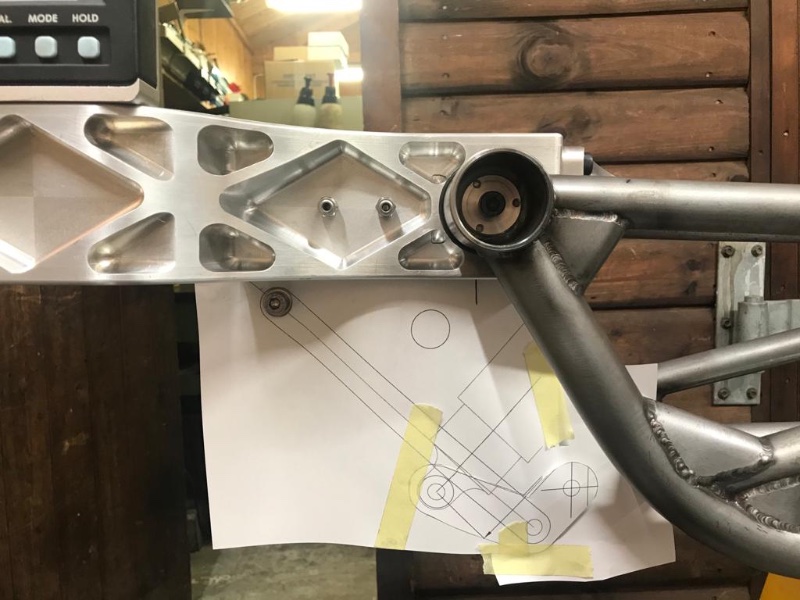

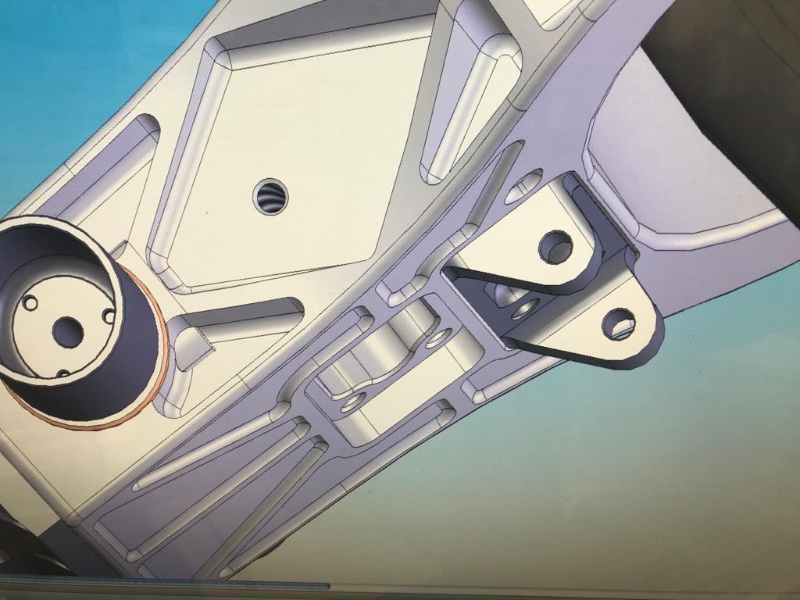

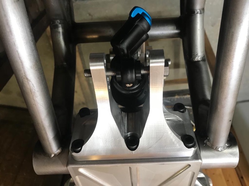

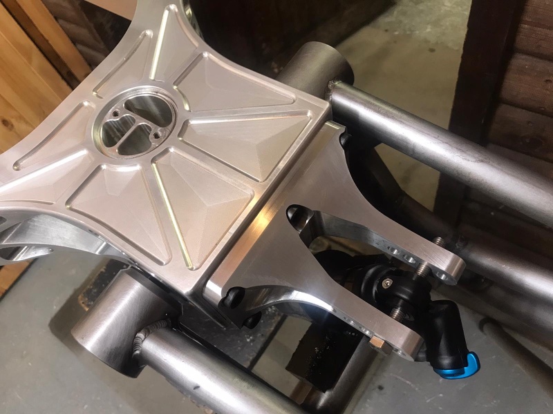

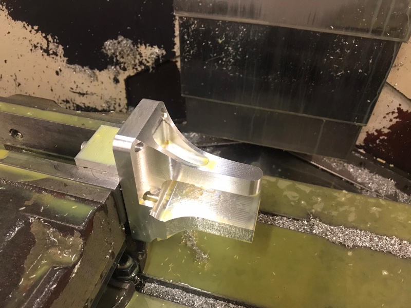

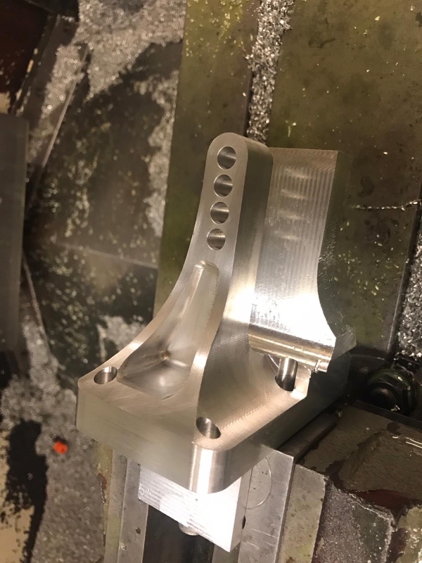

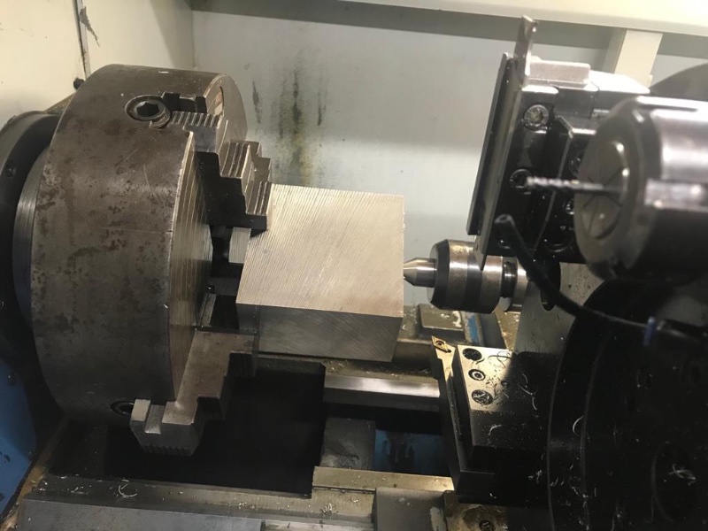

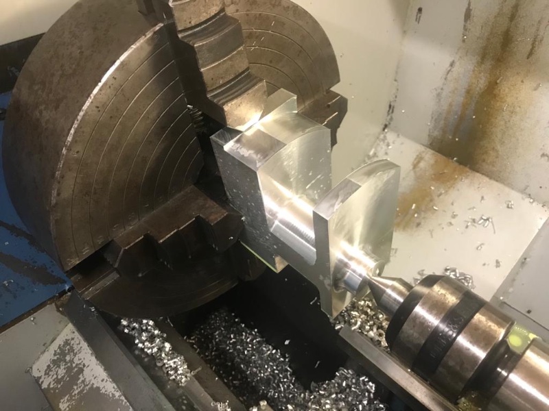

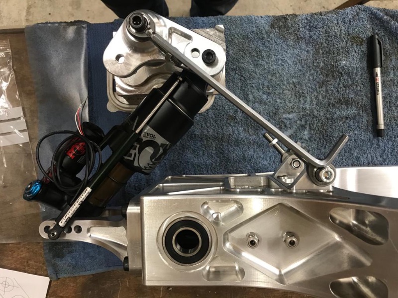

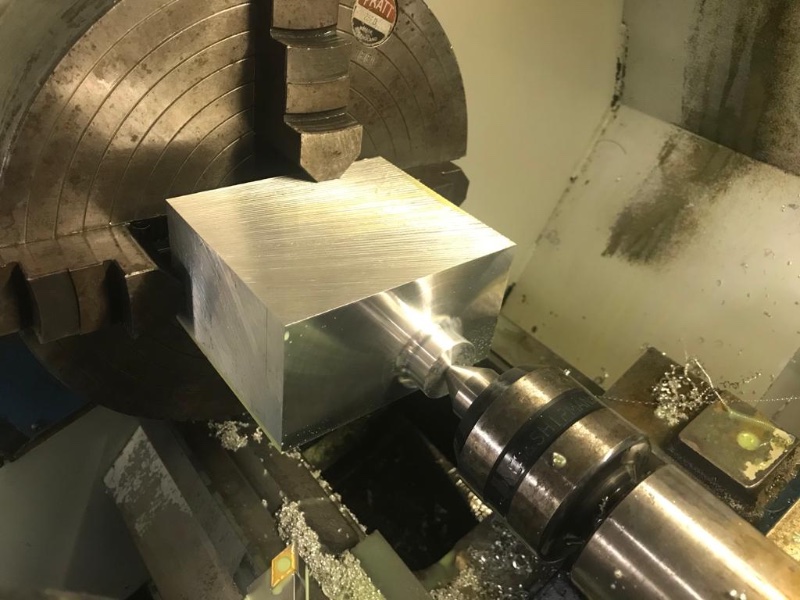

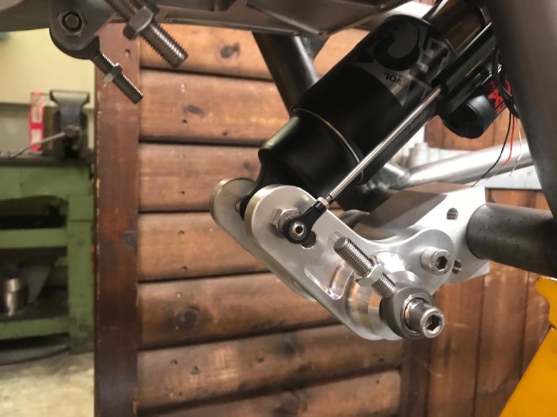

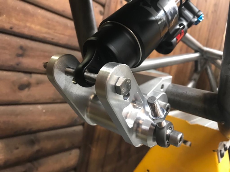

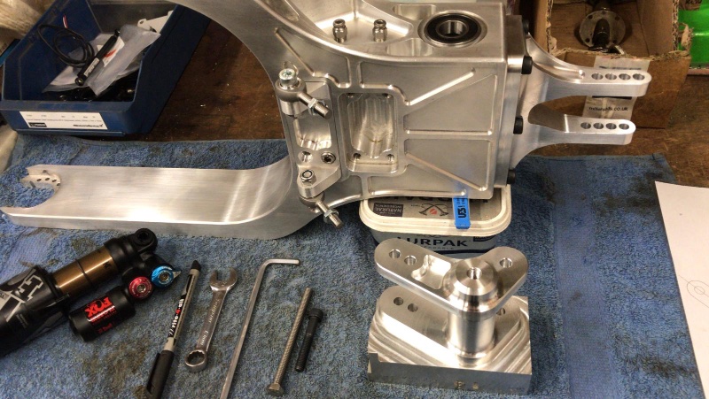

A bracket was created to bolt the shock to the front swing arm
Bluetooth phone app controlled fully dynamic air suspension :salute:
Let the games begin..

could the suspension linkage on that pushbike be any more complicated? :-k

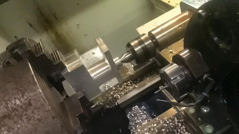

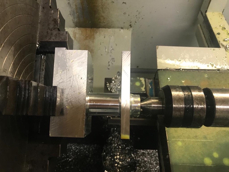

autofetish wrote: Wed Nov 11, 20 7:49 pm :thumbright:
that’s what you call a long series Allen Key :D
Quality work :thumbright:

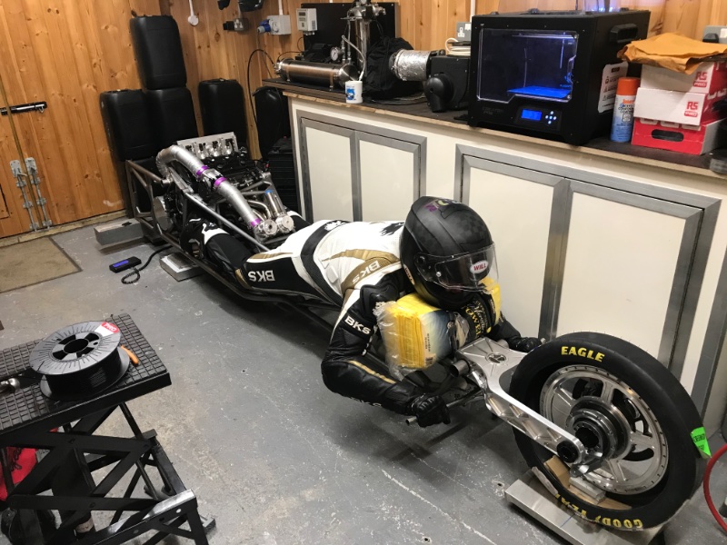

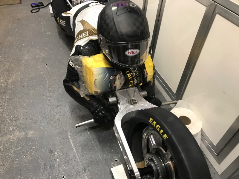

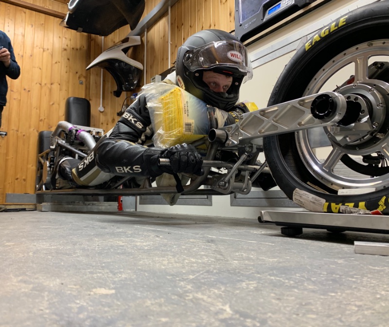

It fits !!!

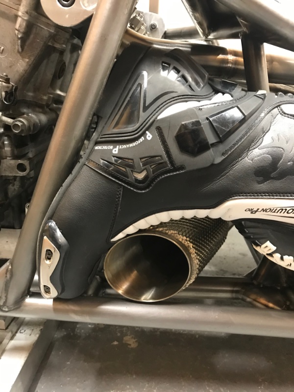

Beauty and madness at the same time!!!
The Ergonomics look a LOT better than the earlier models..... the model is just as ugly....
are you going to deploy the dusters as some kind of parachute?

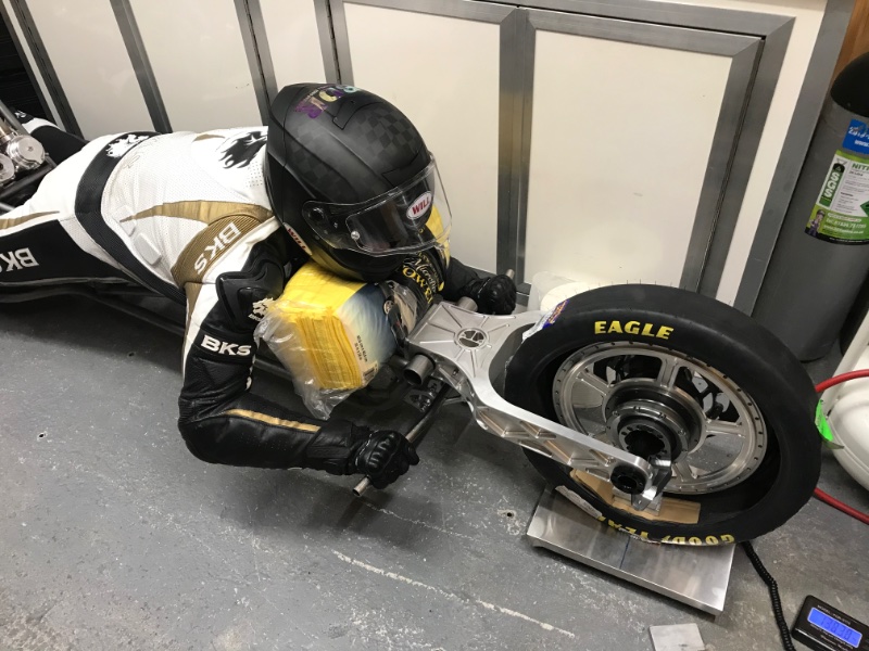

Seeing the sticker on your helmet made me think, have you made a will yet ?
Just asking....
