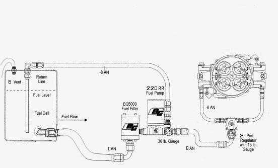

Ade- fuel system is plumbed as per Barry Grant diagram below so -8 to reg, -6 to carb.
Carb is a vac-sec 750 Holley.
Fuel pressure from pump is 17, at reg was 6.5, I've dropped it to about 5.5 (though it's fluctuating between 5-6)
