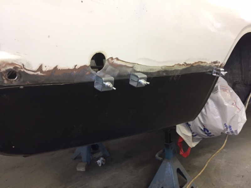

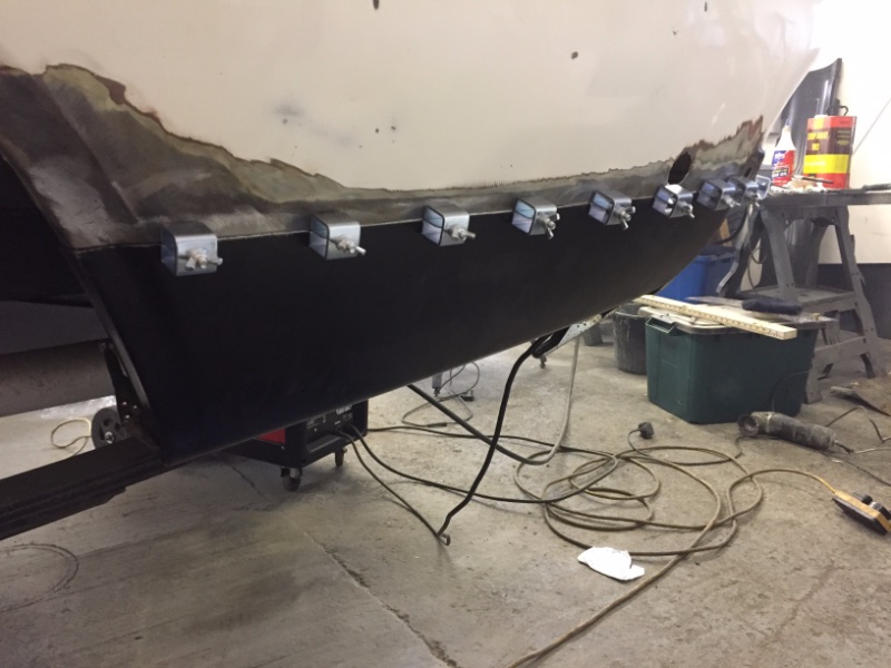

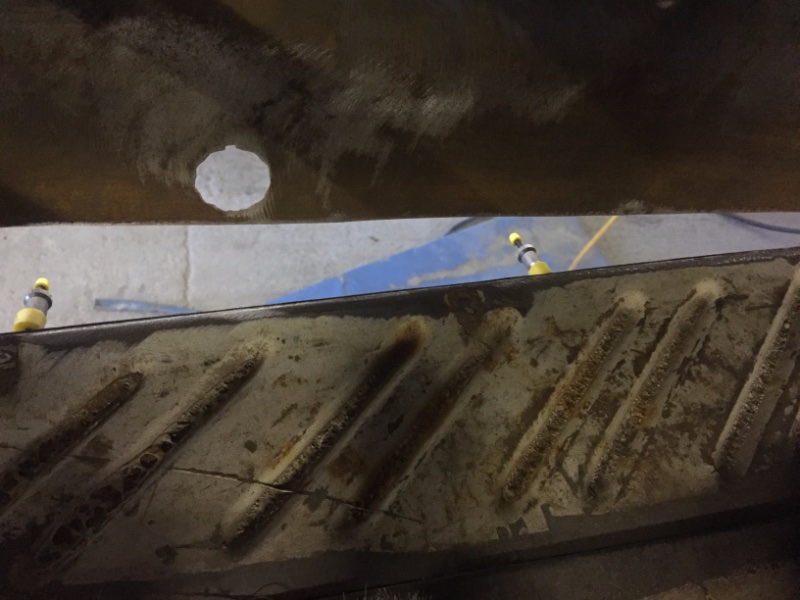

Boot floor extensions are rust free so I just used the drop off section which was mostly missing. DA and joggler on order so I won't do much more till they get here next week.
- IMG_1185.jpg (124.15 KiB) Viewed 13840 times
- IMG_1186.jpeg (123.54 KiB) Viewed 13840 times

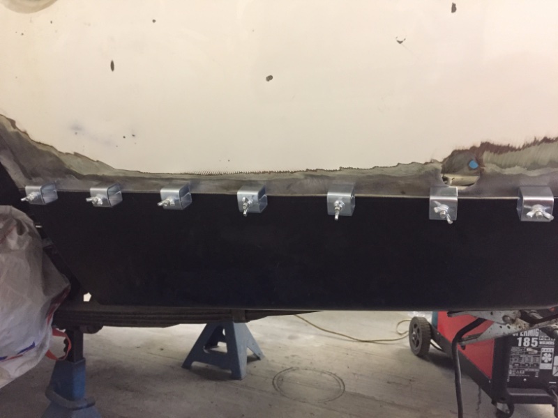

Went for it! Need to spend a bit more time Tomorrow checking alignment before I weld anything, but very happy so far.
- IMG_1191.jpg (132.14 KiB) Viewed 13754 times
- IMG_1192.jpg (95.48 KiB) Viewed 13754 times

That's a good fit and the cut line looks perfect!
Re: Blue's Barracuda
Thanks, that was the second cut on the new panel. For reasons I still don't understand, transferring measurements to the new panel it was obvious it would be oversized. It did allow me to clamp the panel in place to scribe a true cut line though.

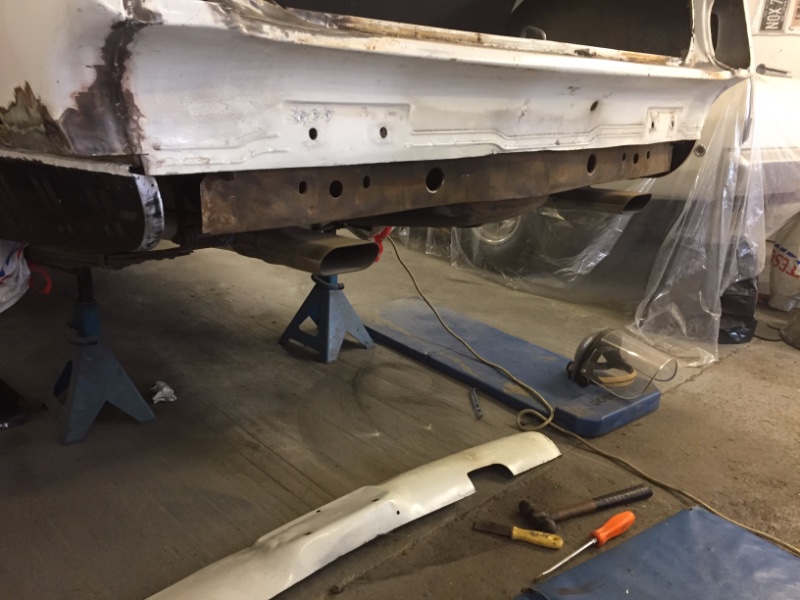

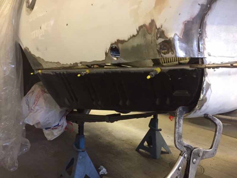

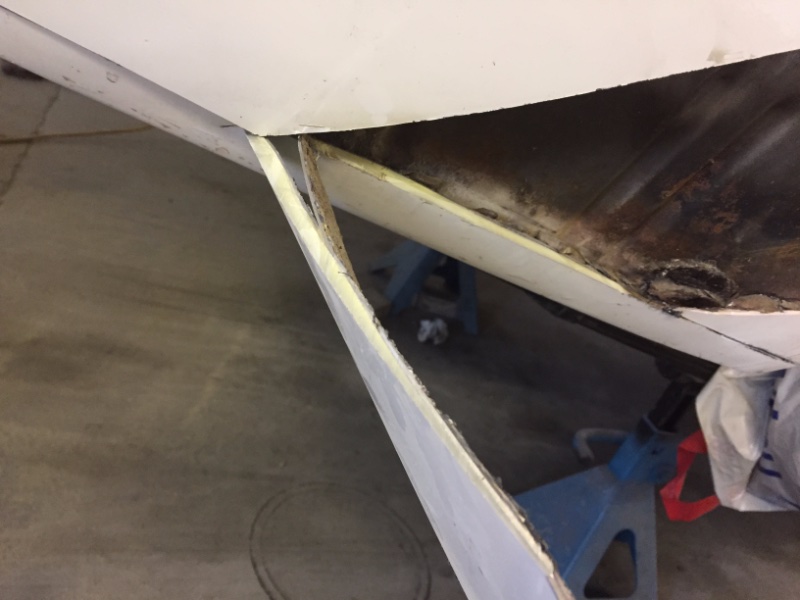

Ok, you asked for it.. Started on the "good" side which turns out to be just as much of a fillerfest as the Bad side. Panel just needs a final trim and that's ready to go. Both drop offs welded in and bottom half of the rear panel removed. Just waiting for some metal to arrive to make a brace before removing the rest of the valance.
- IMG_1194.jpg (104.64 KiB) Viewed 13672 times
- IMG_1195.jpg (92.38 KiB) Viewed 13672 times
- IMG_1203.jpg (139.91 KiB) Viewed 13672 times
