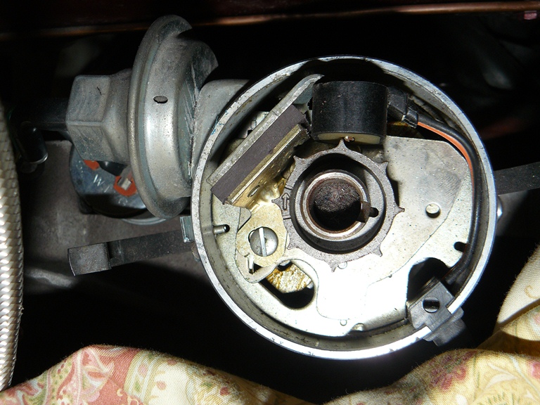

Have a look at this Paul
Posts: 8368
Forgot to put this pic of mine up. I'll pull the plate off tomorrow and have a better look.
I think I'll need a limiter plate. That'll stop it at 18* which is dead right for mine.
£20 seems a lot for a bit of metal with a few holes tho, I bet it'd be easy to drill & tap the dissy body and stick a screw & locknut to stop the weights just where you want :thumbright:

You'll see how easy it is to mod the yoke when u get to it, a tiny spit of weld on the weight pus or the inside of the yokes slots and you're done :thumbright: ....... Just file em down to fine tune

Has that dizy rotor been hitting the electronic pick up? :shock:

Posts: 8368
It is close Dave but it's not made contact. I might nudge a little further away just for peace of mind.
