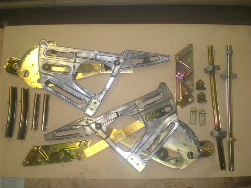

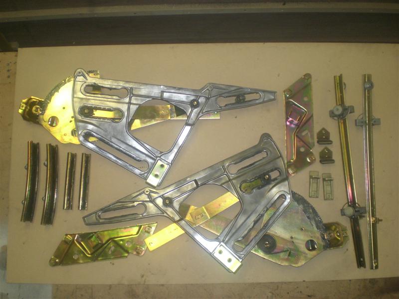

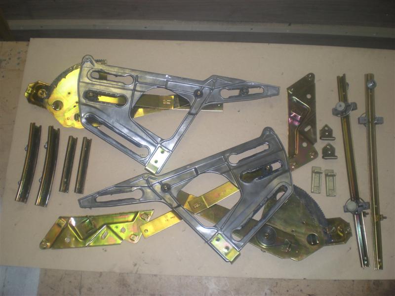

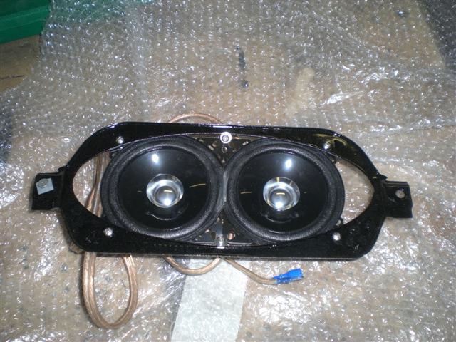

I have final finished restoring the quarter window regulators and the came out well.

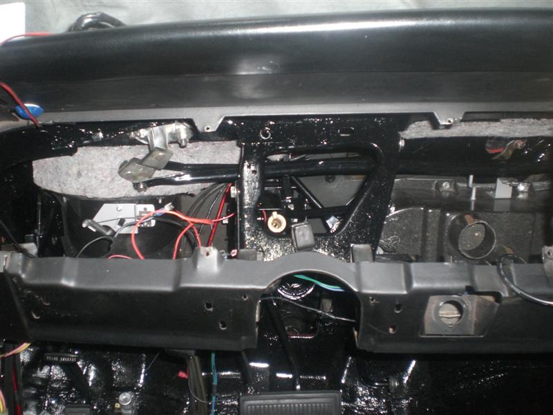

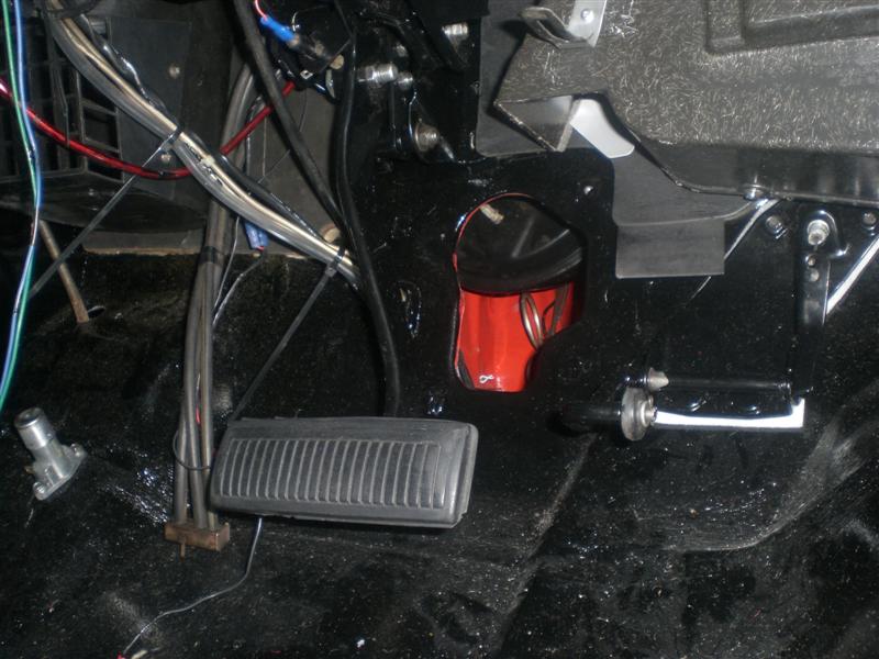

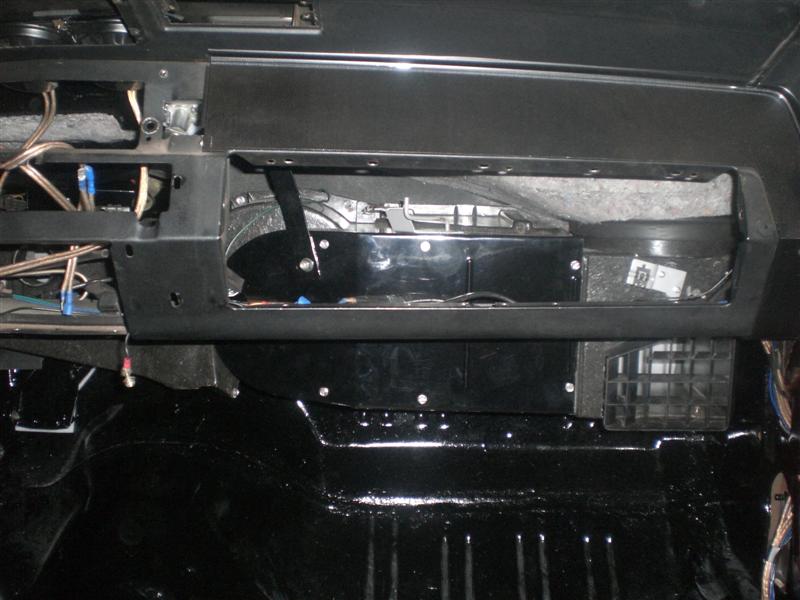

I have also finished painting all under the dash and the floor and it all came out well and made a big difference.
- CIMG8638 (Medium).JPG (69.13 KiB) Viewed 2248 times
- CIMG8642 (Medium).JPG (66.36 KiB) Viewed 2248 times
- CIMG8640 (Medium).JPG (67.96 KiB) Viewed 2248 times

And i will now do exactly the sameANTON wrote:This is for Autofetish.
I soaked all the widow regulator part in petrol for a day and then using my bench grinder with a wire wheel I cleaned them and then gave them to a friend who zinc plated them for me. I them cleaned and re-greased all the wheels and re-assembled them.

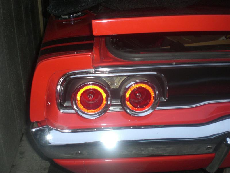

I ended up have to order a new tank fro WASP and that arrived last week.

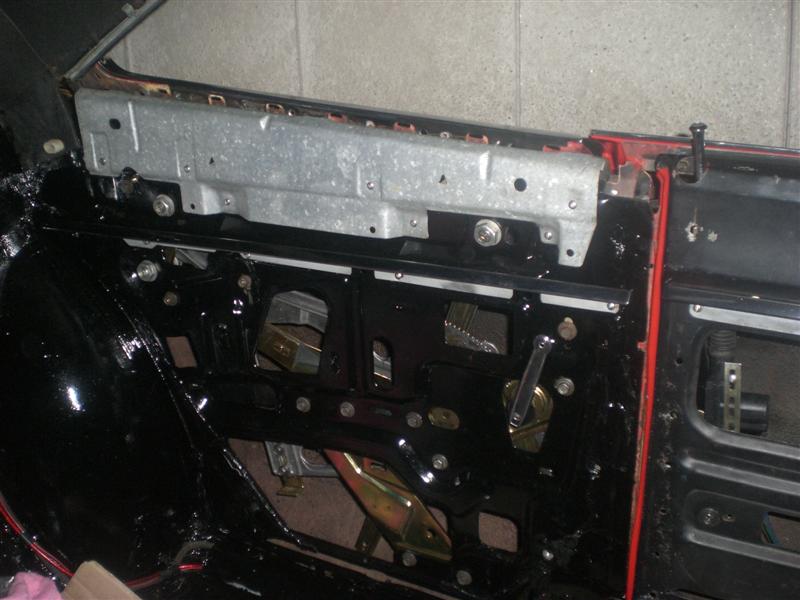

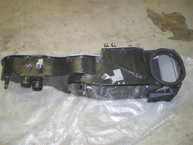

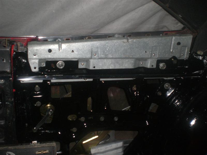

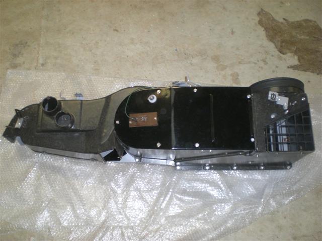

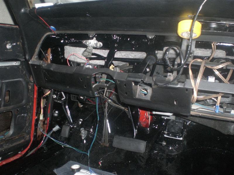

I have started re-assembly on the car and with Derek's help on Saturday we go alot done. The trunk area and rear lights and trim are all back together. The leaf spring are back in place and the car is back on its wheels. I have been concentrating on the interior and that is coming together nicely. I have all the window regulator hardware back in and I also have all the pedal,wipers and heater box in. The next part will be to install the carpet and underlay and then i can put the dash and wiring back in and the last item to go in will be the steering column.
I did paint all the floors and even the under the rear door card so it is all black now and that has tidied it up nicely.
