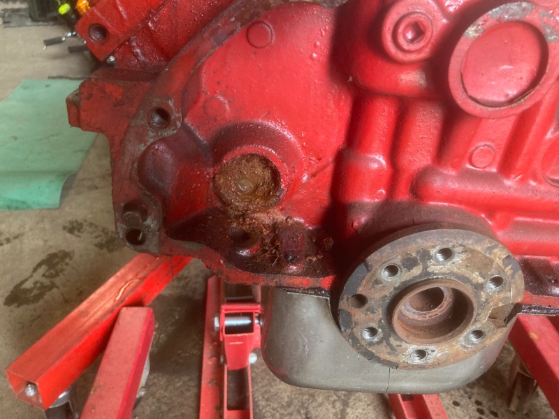

Reckon that’ll be the leak from the back, then!

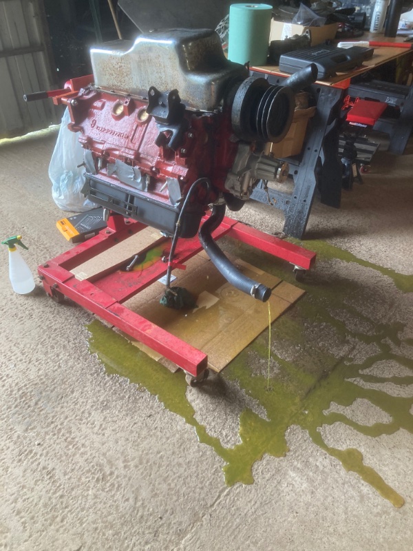

Well, it’s empty…

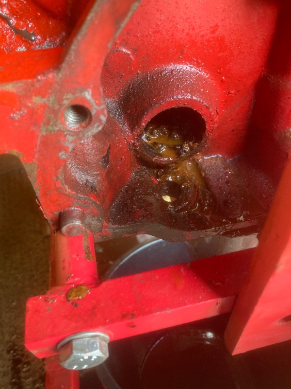

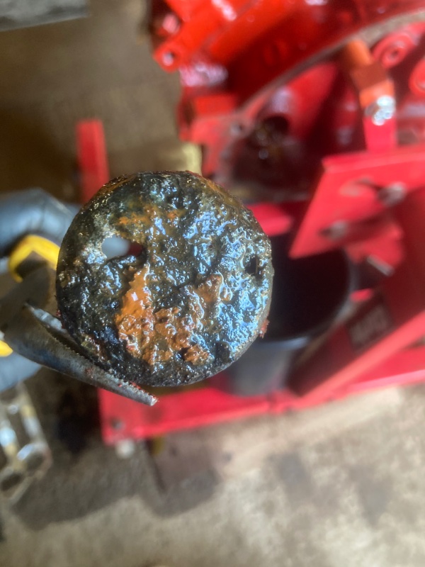

Yep, that’ll be daylight through there, then!
Some serious chunky, rusty sludge in the water channel once I’d removed the plug.
