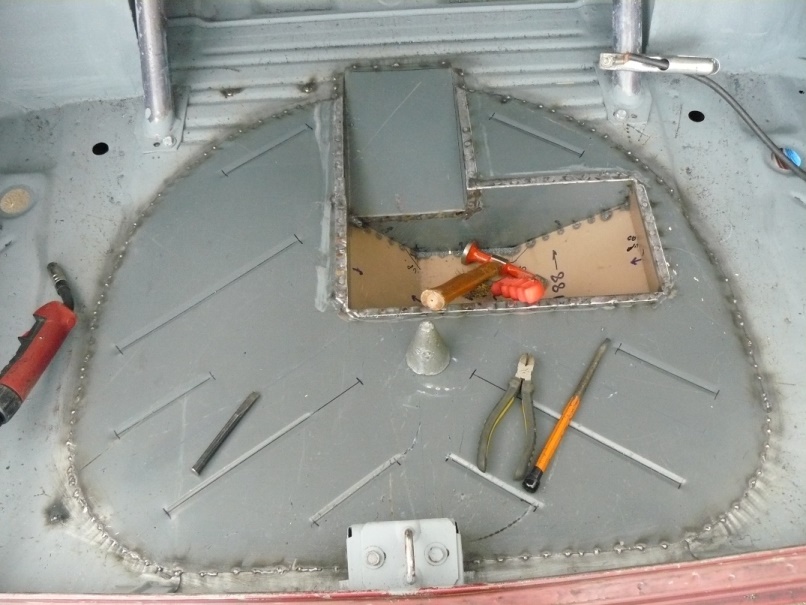

Trunk panel is complete now, my mate Pete had an old hand roller that put in the swage lines very nicely!
I've started prepping the trunk for welding it in & painting and in typical style- i'm now stripping the whole trunk, digging out all the old sealant & cleaning off loose paint
More pics later...

WELDING DONE HOORAY
It's come out much better than i'd hoped, kinda looks like it's always been there...
I tacked it all the way round, bit by bit so it didn't distort.
Once secure, i fully welded inside and out so it's super-strong and then made a 1" box brace which i stitched across between the frame rails.

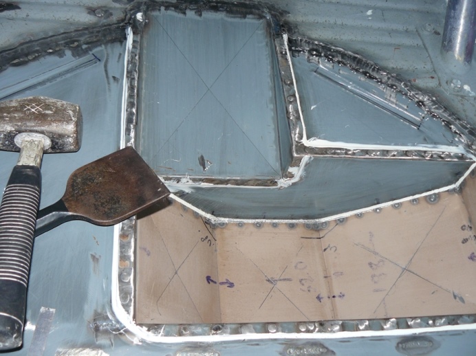

To make the sump a bit stronger and look better i drew an X on each face and whacked it with a bolster, making a nice 'pyramid' effect. I also drilled a drain hole in the bottom.

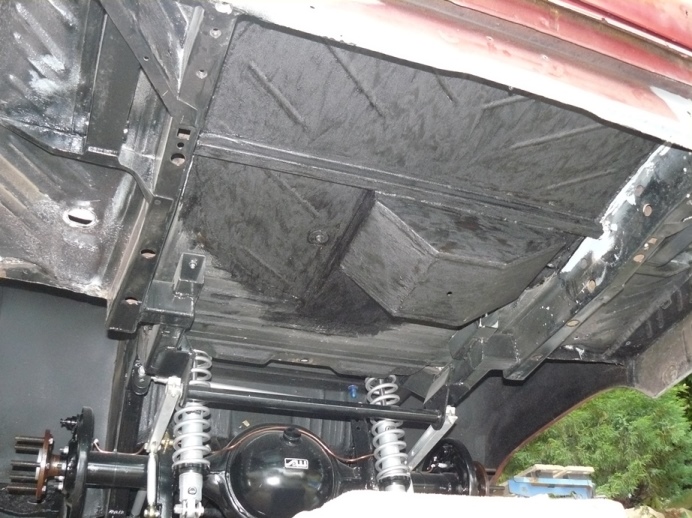

Bit o' seam sealer, a slap of underseal and it's all done!
Next is to figure out how to mount the tank & pump and paint the trunk.
