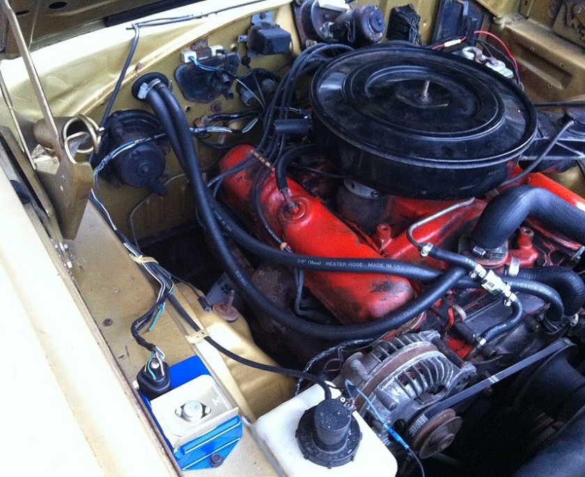

The next job was to sort out the Electronic Ignition Conversion.
I bought a dizzy from Bacca (Cheers Jon) and bought a new ECU and plug from the states.
All arrived ok, and when I came to do the job, I put the plug onto the ECU and somehow managed to snap off a pin
At first I thought 'ere we go. You get what you pay for I guess.
My fault I know as I was trying to save a few pennies, but it cost me more in the end. Turned out it was the plug and not the cheap Chinese ECU
Something was obviously not right up in there somewhere, but it got sussed out and now fits as it should on the new one.
Anyway, a replacement ECU arrived at the weekend (a much better quality one) and the job was sorted, along with a new coil and, well, lets just say what a difference
She now starts literally first turn of the key.
No more winding and winding and pumping of the gas pedal.
She is on the button now make no mistake
This is 1 conversion that's well worth doing.
Just got to tidy up the wiring now as the light was against us on sunday.

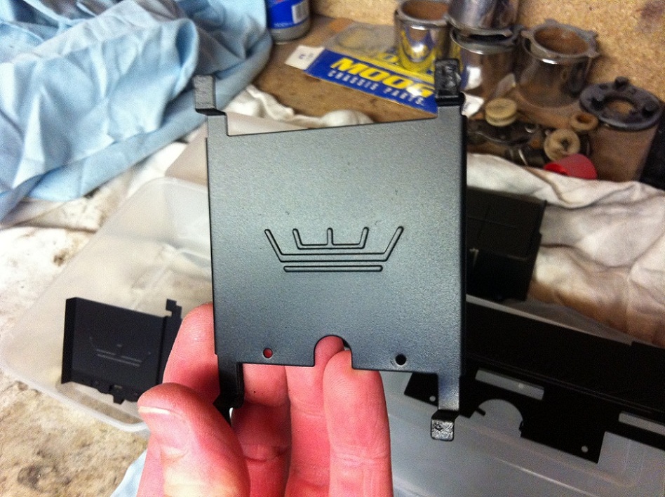

Also fitted a new Pitman arm to the steering the other weekend, as there was abit of wandering going on
New oil sender too as that gave up the ghost for some reason or another
(1- 1/16 socket incase you were wondering
Beats using mole grips anyway
Also put abit of carpet and some door cards in at the weekend too (Thanks Tim for the door cards
Looks presentable now

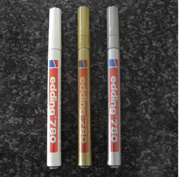

Gauge faces look excellent
How did you do the white on the black, mask up & paint or free hand with a brush ?
- autofetish
- Posts: 5599
- Joined: Sat May 21, 11 6:43 am
Thankyoumopar_mark wrote:Gauge faces look excellent![]()
mopar_mark wrote:How did you do the white on the black, mask up & paint or free hand with a brush ?
Free hand with a paint pen .....
Different size nibs. They work a treat
They're like a miniature rattle can. Shake like hell sending the little ball mad inside
Keep some kitchen roll handy to wipe away excess from nib before application, then it's just like drawing
I tried ages ago with a brush (like a touch up stick).
Result was a bag of Bananarama!!
