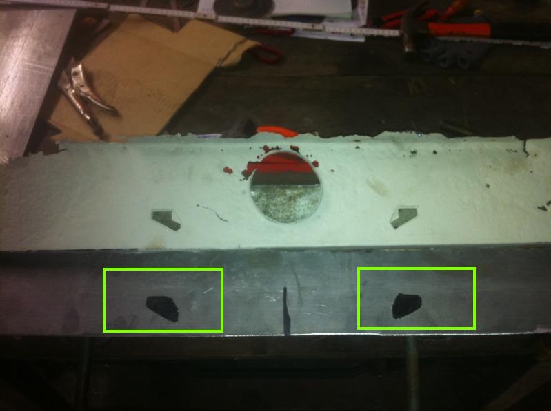

So the back panel where the Gas tank straps go has a whole in the middle apart from to adding stability is there any other reason for it.
(allows air into gap ????)
I have a hole saw so could make a normal whole. Should I :? :? :help:

Will, it's a standard panel that Dodge/Plymouth used. That hole is where the gas tank filler tube goes.
You don't need it in a Charger ;)

Perfect Thanks

Jules wrote:Will, it's a standard panel that Dodge/Plymouth used. That hole is where the gas tank filler tube goes.
yep :thumbright:
also Will , you prolly seen it on your original inner back panel but make sure you make a re- enforcing plate where the tank straps go through , :thumbright:

You can see the gas tank filler neck hole & the tank strap holes on mine:
Steve's right make sure you make a re-enforced plate & keep up the good work! You'll be finished well before me at this rate! :thumbright:
